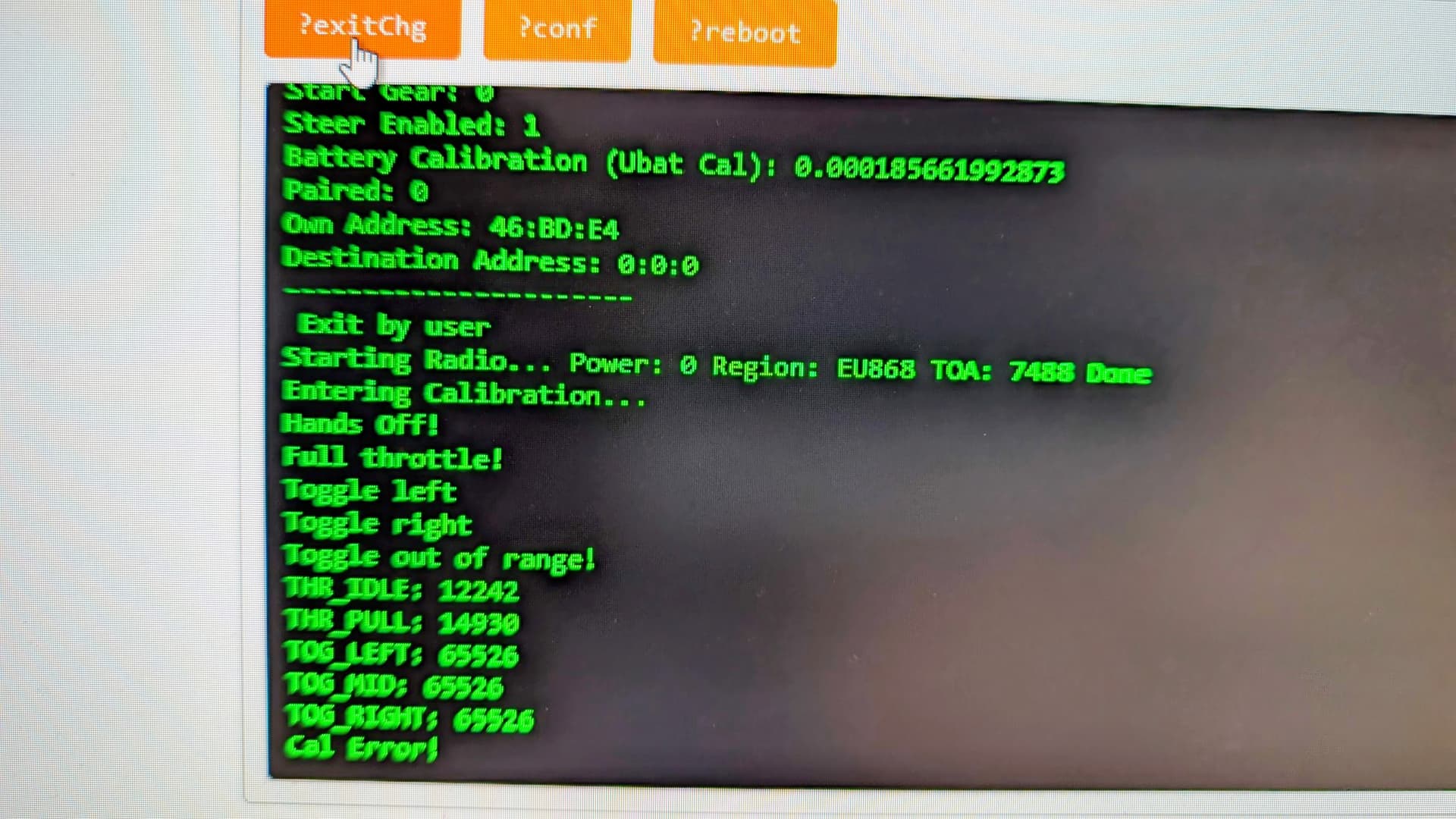

I just built the bremote v2 and I have a problem at the time of calibration.
In the terminal series, the throttle values are ok but the toggle values are identical in all positions (ledt, middle and right) and even if I don’t touch the toggle during calibration.
The value is zero (0)
It seems that the magnets are not recognized by the pcb.
Is it a hardware or software problem?
Thank you.

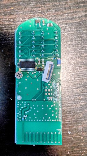

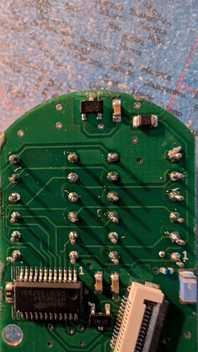

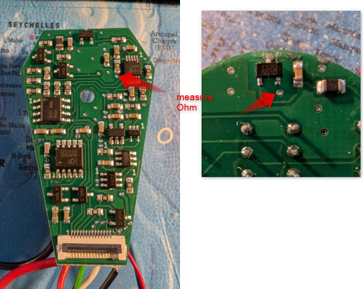

This is very likely a hardware issue, meaning the toggle magnet sensor has a short circuit or the connection to it is broken.

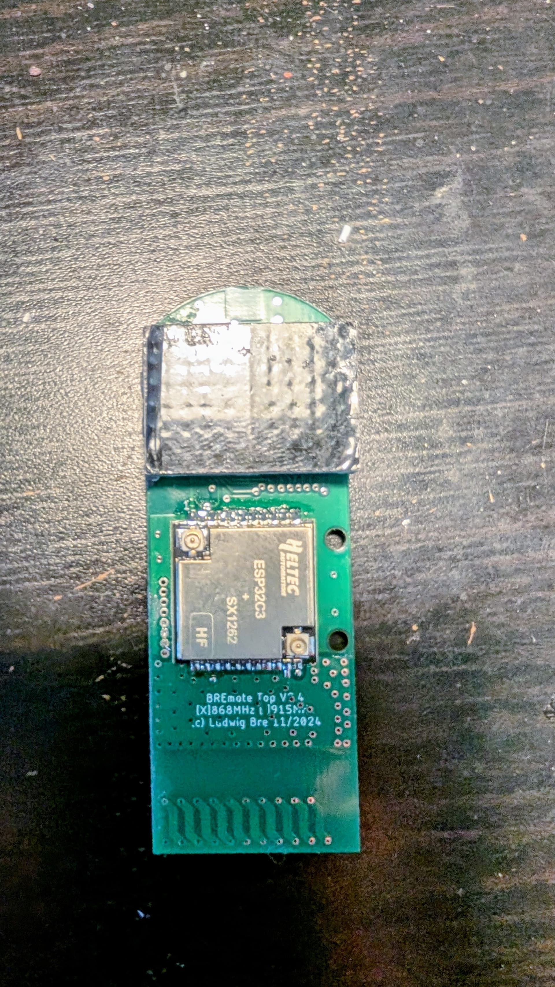

Please send me some high quality images of top and bottom PCB of both sides each, specifically of the flex connector and its pins.

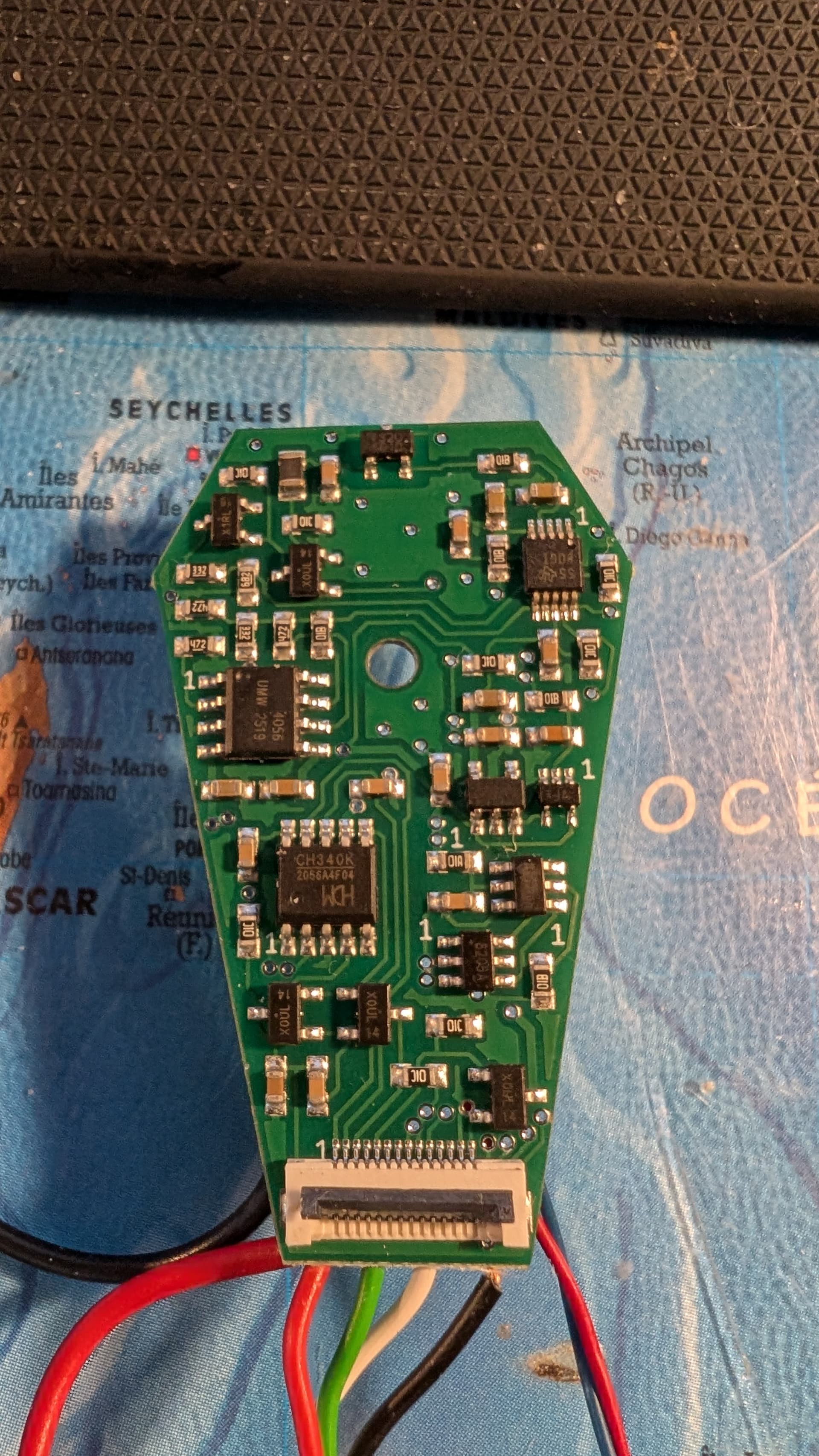

Please also add the bottom PCB images so I can provide feedback!

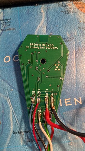

I am referring to images of the Bottom PCB, so the coffin-shaped PCB in the handle of the remote. Please send those.
Thanks
Cant see any solder bridges
Could be that the cable was not plugged in properly or another error thats hard to see.
Please plug in the flex cable between the 2 PCBs, but do not power up the PCBs (remove battery)
Use a multimeter in Ohm settings and measure between these 2 points
Please report the value you get.
1.5 ohm

That sounds good, next you can measure from one of the two points from above towards GND (minus), for example with the USB GND PAD (not the battery gnd pad)
that time it should be kOhm or more
Also just check if calibration works now, maybe it was just a problem of plugging the cable…
Interesting… this also hints towards a problem with the cable maybe not being plugged in correctly…
I have the same resistance : 1.5 ohm : both pcb with gnd usb
I will reconnect the elements and try again but I have already tested the flat cable connection several times…

it still doesn’t work
Ok, so there is a short circuit somewhere
We tried our best, in that case please send a mail to Jasmin from openfoil.com, reference this conversation with me and request replacement PCBs for both top and bottom Tx PCBs.
