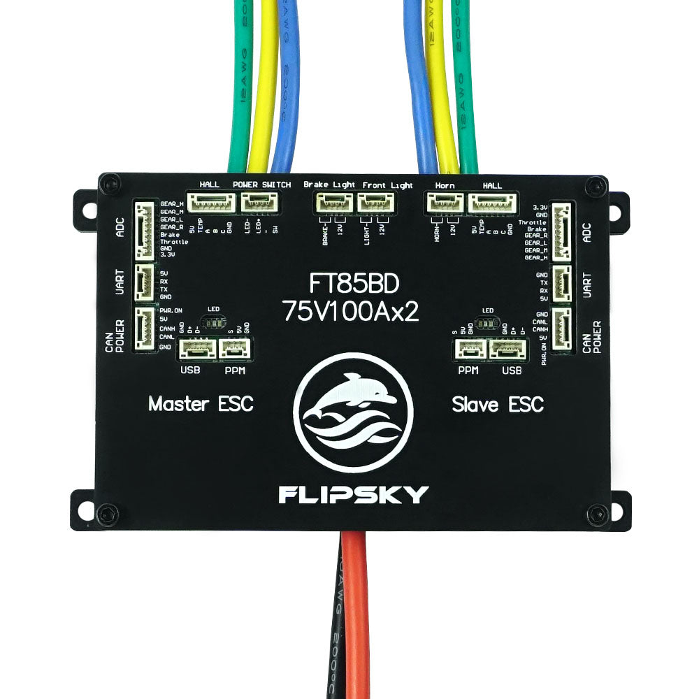

Hi Ludwig,
Do you think dual steering works with this dual ESC?
Flipsky FT85BD
I’ve started construction but I have a doubt; I’m waiting for your answer before continuing.
Thanks :slight_smile:

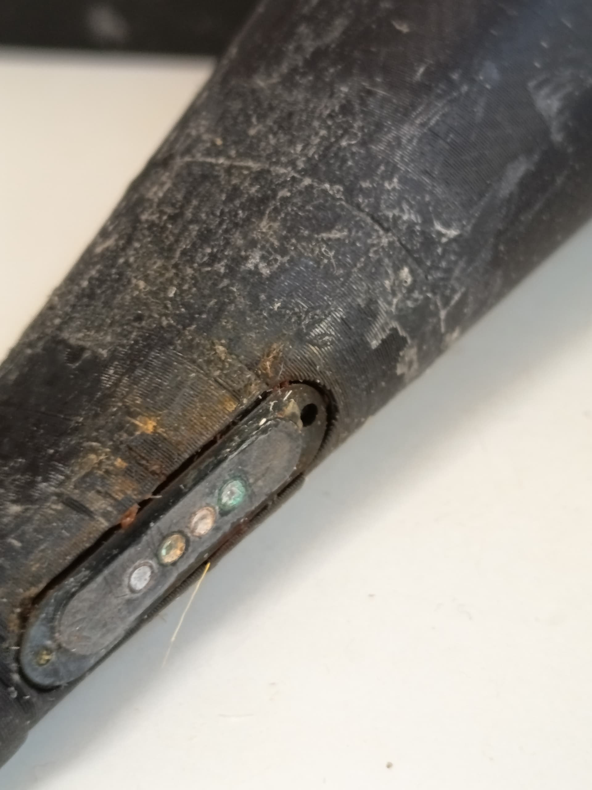

So as a follow up. This is how mine looks after two weeks of almost daily use in seawater.
No charging, no USB connection.
Cleaning with a brass brush and isopropanol easily got me to charging again.
There is also some amount of rust.
Probably from the magnets?
Not sure how to prevent this from further deteriorating. Maybe silicon grease on the area around the connector?
The corrosion can only happen when external voltage is applied to the charge port (ie charge connector is plugged in)
During that time no water must be present!
Please make sure to charge only when completely dry, if possible remove the “sleeve” over the handle so no water can get trapped inside there…
For removing the corrosion I would try a brass abrasive brush and clean with IPA afterwards
I am not sure how to solve this problem otherwise - except make the handle inner and outer part 1 singular part, so no water can get trapped in-between through capillary action
Or make a bigger cutout in the handle in this area so water can evaporate / be cleaned easier
Ludwig, no idea for FT85BD ? Thanks
It has dual PPM input, so I do not see why it should not work
However I generally don’t know about the performance of this esc especially in terms of cooling and reliability
Odd this was unused since November, did clean and charge it then and now just used it without charging until down to 3.4V.
What does “ECH” actually say in real world terms?
Once in seawater, mine does “ECH” every single start until I clean it again.
Guess that is related?
I think having the port completely in the open would be best. How it is done on the current model looks very professional, but is somewhat impractical to service.
But I don’t think it matters with the amount of runtime I get. I just take it apart every three weeks of use, clean it and charge.
ECH means that the status output of the battery charger IC put out and undefined voltage state
If possible turn on the remote and measure if you have any voltage on the charging pads of the remote
In that case it could also generally be helpful to put some thick grease on the pads to protect and just wipe it off before charging
Thanks :+1:
I will measure the next time I have ECH and take it apart.
You can measure now as well, if there is a voltage I would expect it there all the time
Measure all permutations of pad 1:4
Third pad from the bottom has 0.3V to 0.4V to all other pads, rest is close to zero.
To protect the contacts, put a small piece of duct tape over it when you use it.
I put silicone grease on mine. I’ve done this since it was first built and don’t have any rust build up as yet :crossed_fingers:
