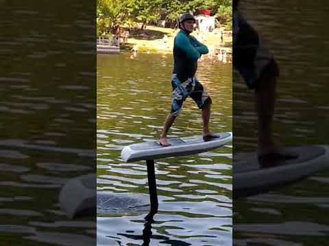

Today was a good wheelchair! We have a heat of 35C.Water is like boiling water! The BMS turned off my battery due to overheating.The temperature inside the battery case reached 60C.
I had a good ride yesterday! The battery charge is enough for me for 5 km.
