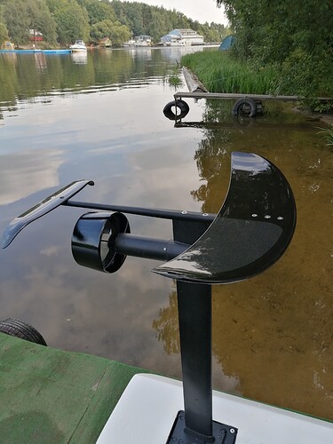

I have new wings! Much more maneuverable and faster than my homemade ones! But the area is less than 1200.
Today is my day of surprises! In the morning the wings came, in the evening the propeller from France!
Hello everyone I put a new propeller that came from France, changed the rotation. It’s not going! When the trigger is fully pressed, the speed is not more than 10 km. h. The board was pushed into the berth, the battery current consumption is 42 amps.
