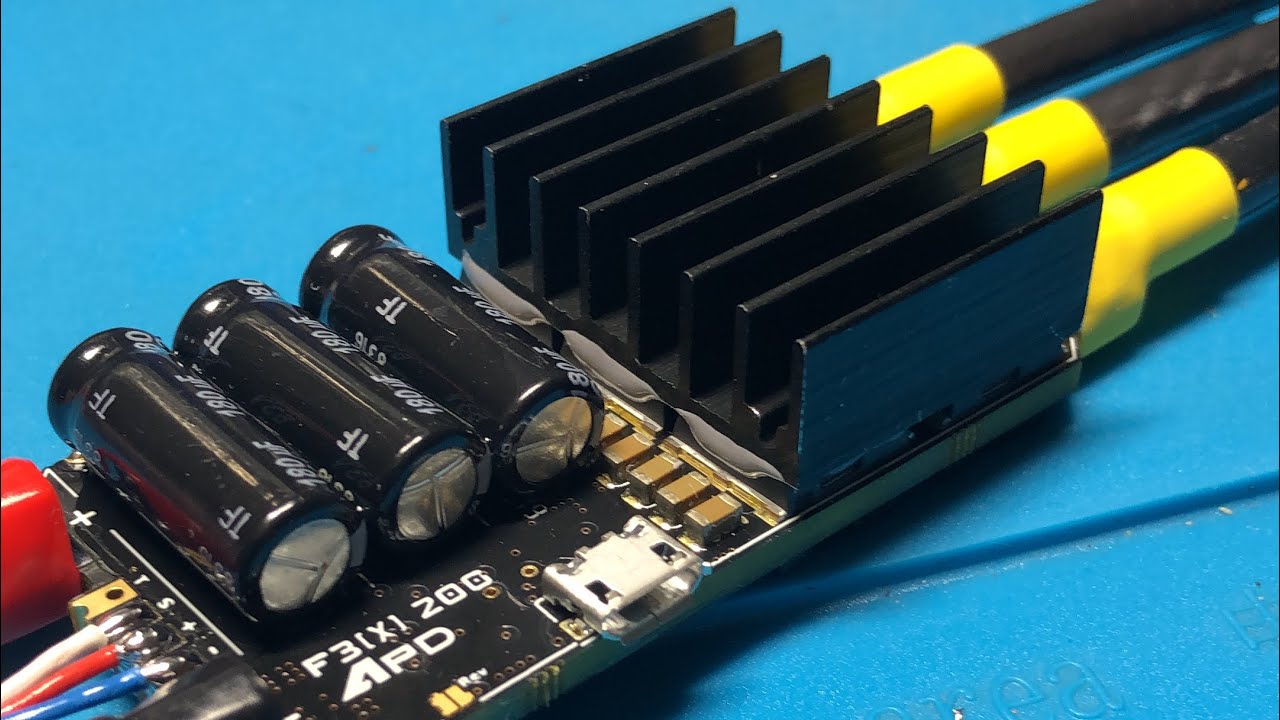

I’m very interested to see how well this ESC works!
:wink:
If this ESC works well, then it’s such a great on to place on top of the mast and let the mast cool it!

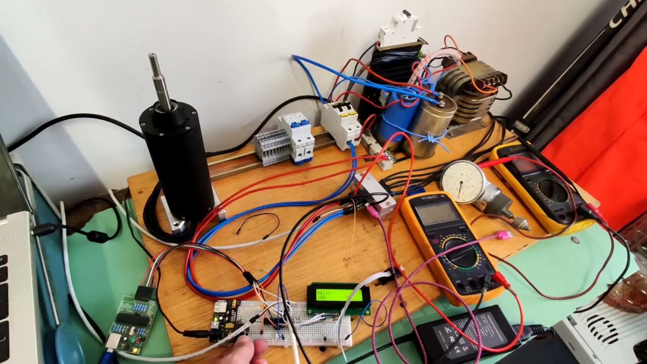

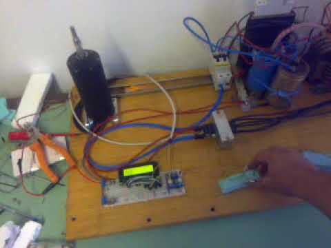

At a supply voltage of 34.8 volts measured on the fuses, the no-load current is 2.15A, the speed is 3750 rpm.
Very curious as well , my heli esc at time blow up on first the load , but my boat esc less powerful is still working
I am a esc expert but I guess esc strategy for air isn’t the same as water , can it handle high amp at low switching freq (?) , I hope because it has a very compact design
It might not be the same as for water, but with a lot of the heavy-lift drones they fly with low KV motors so this should be able to handle low switching frequency. Here’s the full overview: https://docs.powerdrives.net/products/f-series-esc/overview
Your ESC does look interesting, hopefully it will be fine, I am using an airplane ESC Castle Creations HV160 which is rated to 160 amp.
Do you have to set the switching frequency?

My friend Valentin from another city deals with software and electronics. I installed the power parts.
No data is entered on the ESC. At its input we have submitted PWM: 256 Hz with a length of 1 mS for 0 rpm, and at 2 mS MAXrpm .
You may refer too switching freq of the fets , I believed I read it s auto and up to 32
Hi
Ok thanks, yes it does say automatic detect.
The reason I ask is because Castle Creations recommended 16khz for my ESCs PWM frequency switching which I thought was too high, for a 6 pole 120kv motor.
