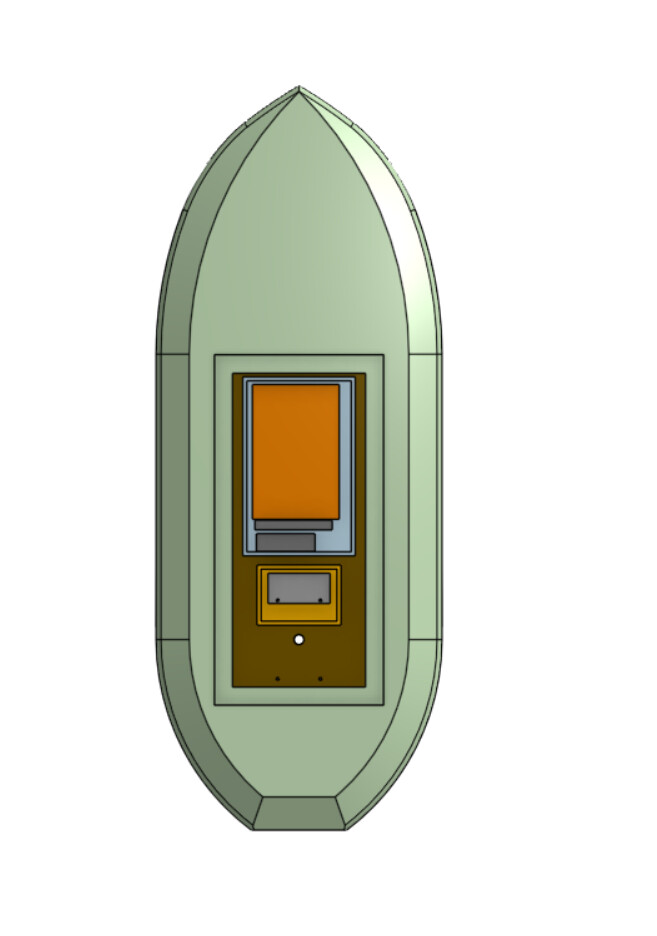

Hey everyone,
Big update on my build. After spending a long night studying Gustav’s Danish V2 build thread and photos in detail, I’ve redesigned the board layout pretty significantly. The core components haven’t changed, but the board internals, hatch design, waterproofing strategy, and BMS have all been reworked. Wanted to share the changes and reasoning in case it helps other first-time builders thinking through the same decisions.
TL;DR: Switched from a two-cavity layout (service hatch + bolted battery hatch) to a single-cavity Gustav-style layout. Everything sits on one shared 1/2" birch plywood base plate that doubles as the mast hardpoint. Battery and ESC each live in their own sealed waterproof PETG enclosures inside the cavity. Single hatch with 4 compression cam latches for quick access. All electrical connections use XT150 connectors inside IP68 waterproof inline junction boxes. BMS upgraded from 100A to 150A with switch function for anti-spark power on/off.
What Changed and Why
Board Layout: Two Cavities → One
The original plan had the mast zone as a solid foam I-beam (deck-to-hull structural connection), with the battery cavity pushed forward ~21" ahead of the mast. A separate 6" Smartmarine screw hatch gave daily access to phase wire connectors and the power button.
Problems I identified before cutting any foam:
  • CG offset: The ~10.5 kg battery sitting 21" forward of the mast created a significant nose-heavy moment. Manageable but not ideal for a first-time builder/rider.
  • Structural complexity: Two cavities + foam wall between them + conduit channels through the wall = more cuts, more failure points, more fiberglassing.
  • Daily access was clunky: Even with the service hatch, I’d be reaching through a 6" hole to plug in connectors and press buttons.
Gustav’s V2 showed a cleaner approach — one big cavity spanning the mast area, with everything mounted on a shared birch plywood base plate. The plywood IS the mast hardpoint AND the electronics floor. Battery and VESC sit on the same plate, directly over or near the mast.
My adaptation of his layout:
  • Cavity: 26" × 11" (660 × 280mm), full through-cut on all 3 foam layers (same width), spanning from 11" to 37" from tail. Layer 3 has a shallow 1/2" recess in the top face around the opening for the hatch lid to sit flush.
  • Plywood base plate: 1/2" (12mm) birch, 28" × 13" — extends 1" beyond the cavity opening on all sides, overlapping under the foam of Layer 1 for mechanical bonding. Epoxied into a shallow recess, flush with hull surface.
  • Mast bolts: Rear section of the same plywood plate. M6 hex bolts from below, nyloc nuts tightened from inside the cavity. No more threaded inserts — simpler, stronger, replaceable.
  • Battery CG: Now ~22" from tail vs 43" before. Only ~7" forward of the mast center instead of 21".
Hatch: Bolts → Cam Latches

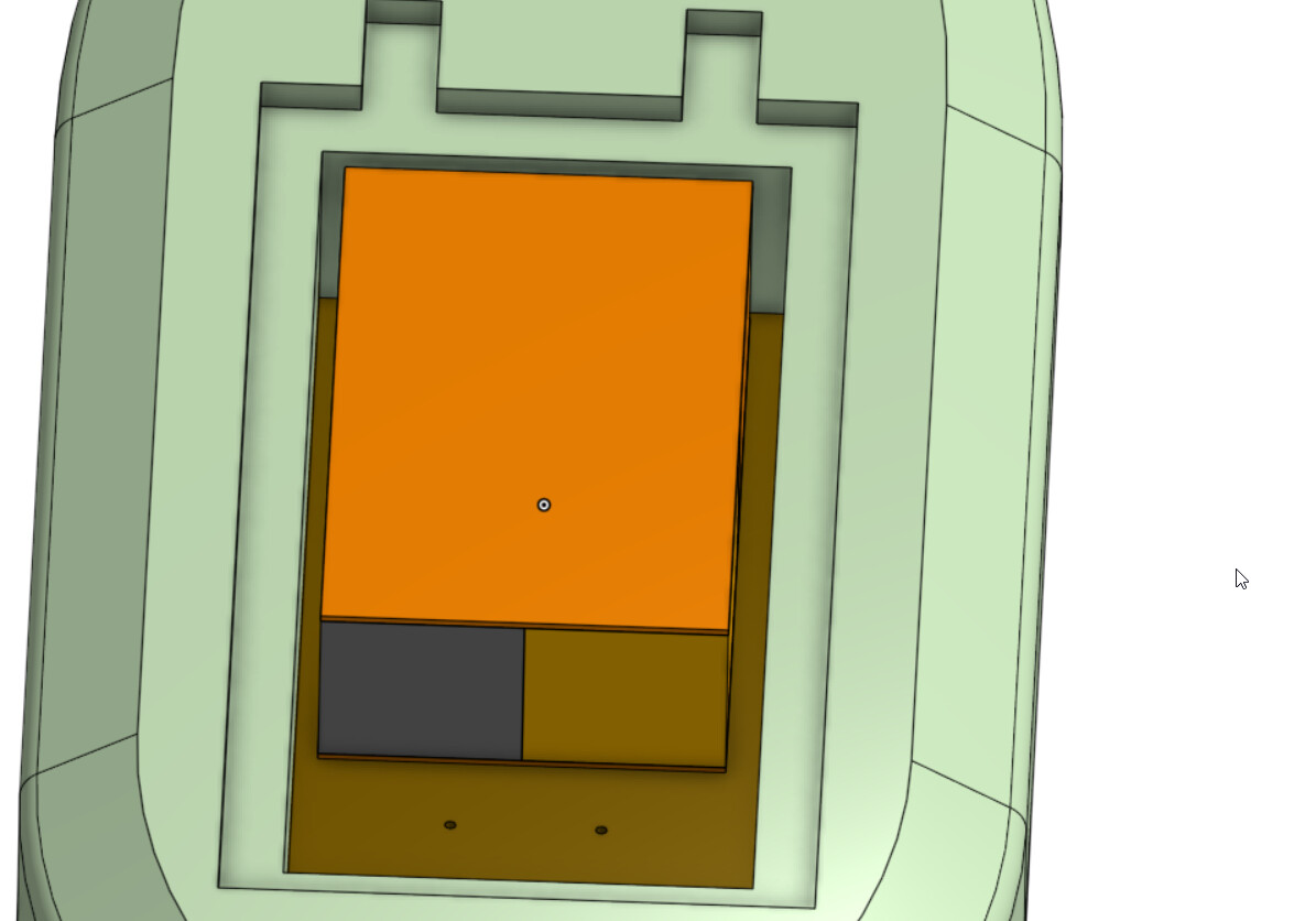

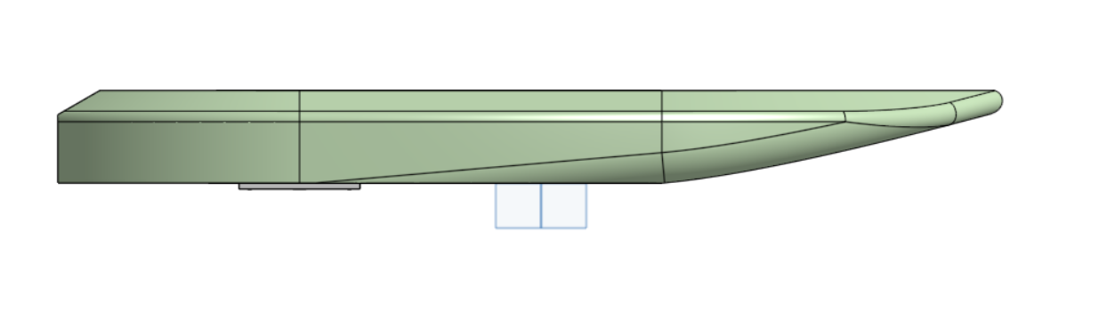

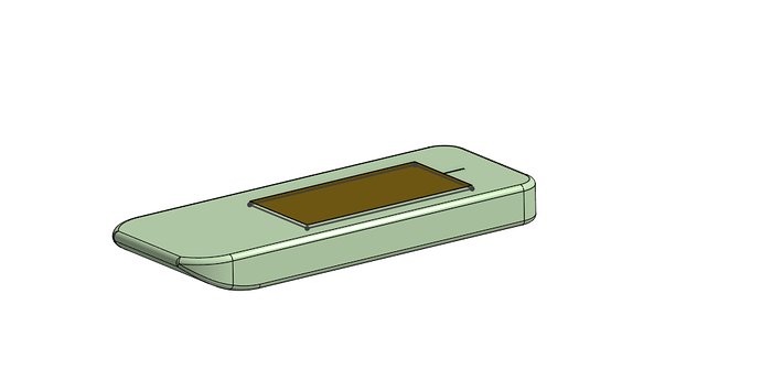

Hey everyone,

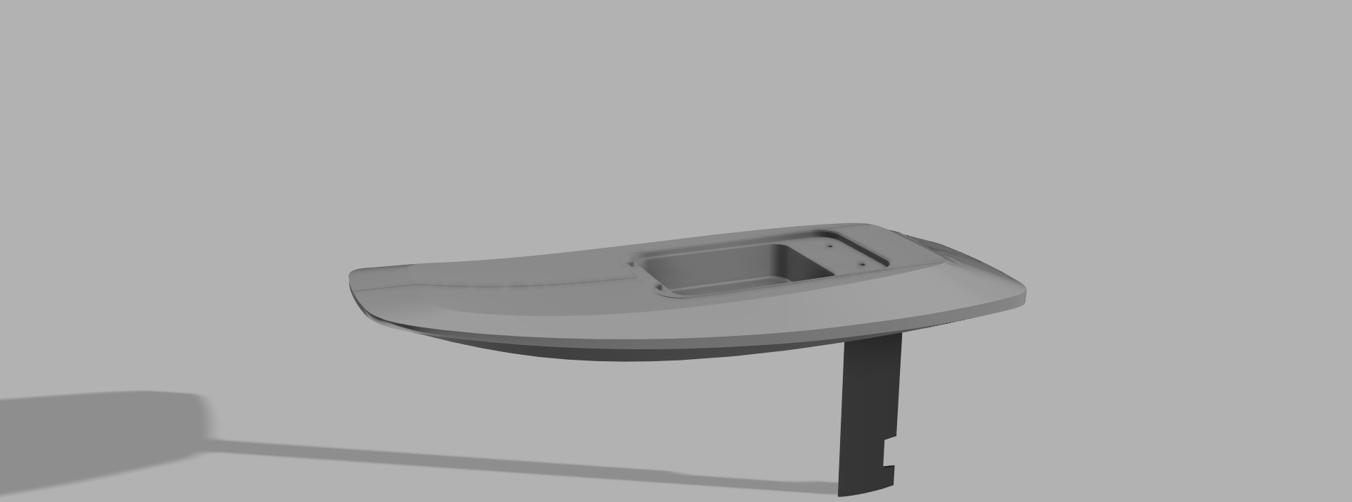

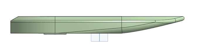

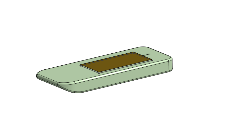

Quick update — spent the afternoon getting the board modeled in Onshape before I start cutting foam this week. Wanted to share the progress and get any feedback before I commit to cutting.
Hmm, looks extremely bulk, almost like a brick. Try to make it less thick, and maybe you can make the sides more rounded? Get some inspo from the boards alreay out there.
Sharp edge at the bottom in the back is better for easy takeoff. Round corners cause trouble towards the end of the rails.
I made them round first and corrected it, see here, scroll down:
Works great.
maybe this will give you some inspiration.
It’s for the “flite” mast system box

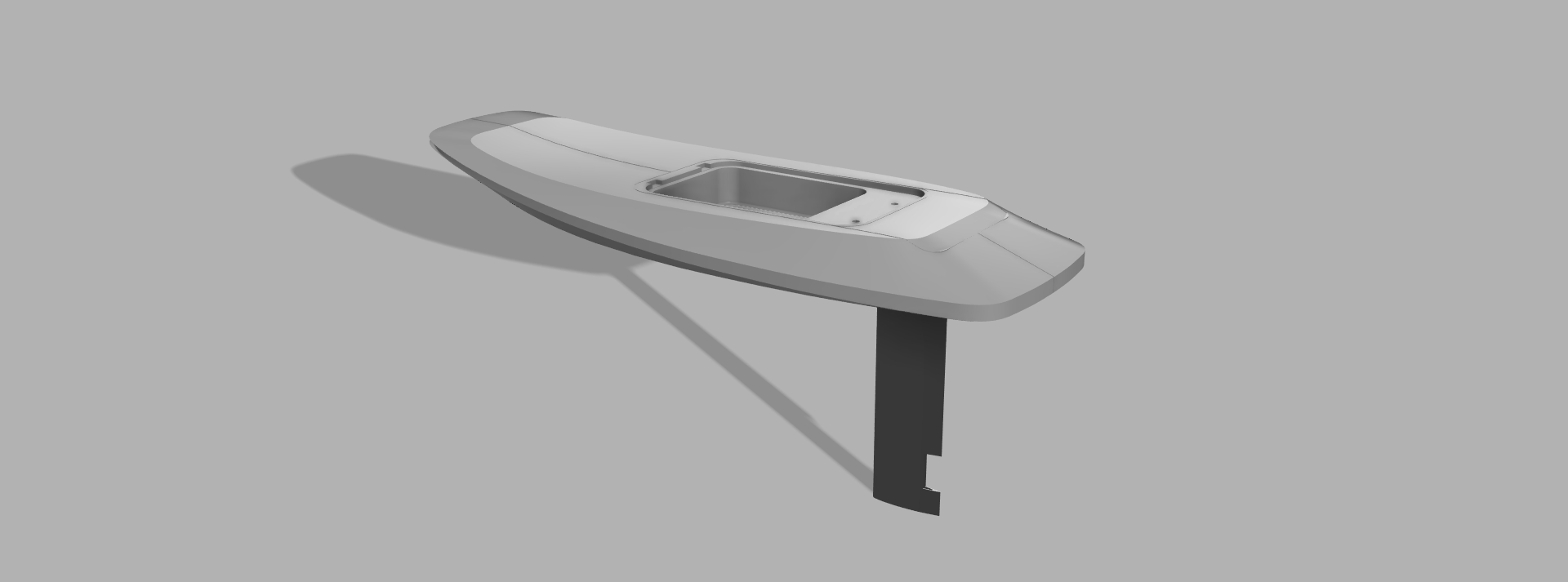

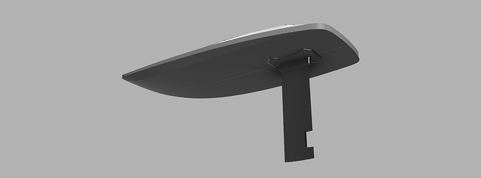

Big update — took all of your feedback and reworked the board shape in Onshape. Here’s what changed:
Board shape: Ditched the pill-capsule nose for a swept/tapered profile with 400mm fillets. Much less brick, much more eFoil. Tail stays blunter than the nose. Thanks @DutchFoiler for the reality check and @Kian for the Flite board inspo images — that wedge profile with the angled deck edge and flat sharp bottom is exactly what I was missing.
Rails: 20mm chamfer on the bottom edges (sharp, no rounding), 30mm fillet on the top edges. @sat_be your thread was exactly what I needed — sharp bottom-to-side transition for clean water release, rounded top for comfort. No more uniform rounding all the way around.
Nose bevel: Bottom surface now kicks up starting at 1000mm from tail (600mm from nose) instead of 320mm — way more gradual. Should help with takeoff and touchdowns. @Foilguy yours starts 400mm from nose with 140mm rise — mine is more gradual but starts much earlier, so the total rise should be comparable.
Thickness: Can’t go thinner overall — the battery enclosure just barely fits between the two 1/2" plywood plates with the cavity height I have. But I’m thinking I could build up the nose slightly (extra half inch on top that curves down to the 6" section where the enclosure sits) and/or do chamfers on the sides and tail to slim the visual profile, similar to @Kian’s Flite reference.
Other changes from this session:
  • Solid tail increased to 300mm (was ~280mm) — more structural foam behind cavity
  • Mast mount centered at 400mm from tail on a 90×165mm bolt pattern (confirmed standard via the mast/plate database thread)
  • Battery and ESC enclosure walls upgraded from 4mm to 8mm PETG — cheap insurance for rigidity on 350mm+ spans
  • Volume confirmed at ~77L via Onshape mass properties
Gong V2 foil arriving tomorrow. Cells should be here Thu/Fri. Will measure the actual top plate and verify bolt spacing before drilling anything.
Thanks again everyone — night and day difference from the first Onshape screenshot.
— Derek
Looks good. One more thing, the Volume in the tip does not help a lot, if you cut the tip and make it flat, it is much easier to place the board on wing and tip, it will not flip to one side.

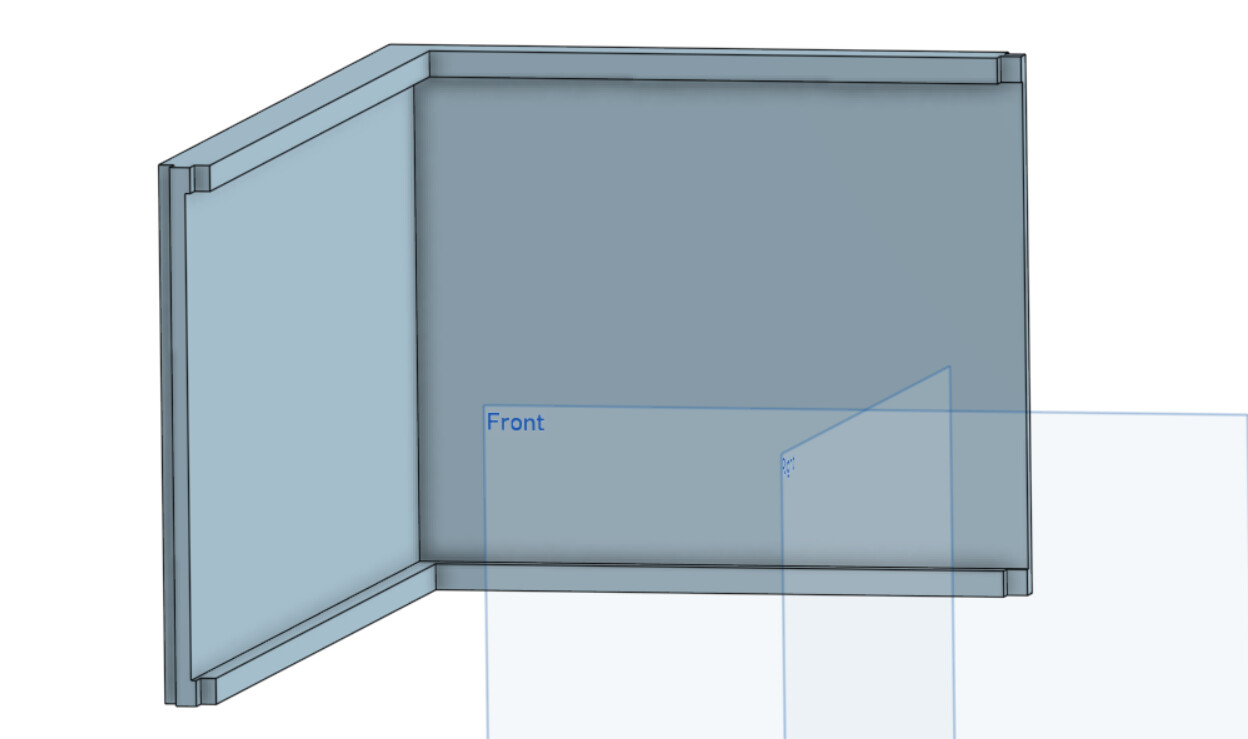

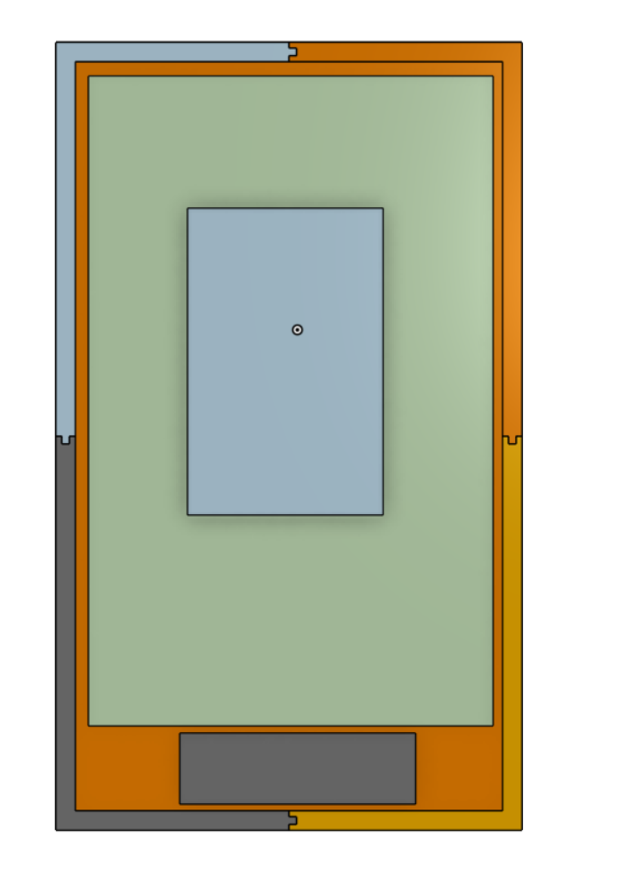

Sharing my enclosure plan before committing to print. Feedback welcome.
Constraints: board cavity 660×280×115mm (+4 mm due to lid compression ), 14S9P BAK cells (~211×339×70mm), JK BD6A20S15P BMS, Flipsky 75200 ESC, Bambu A1 printer.
Architecture: PETG walls + 4mm aluminum top and bottom plates, bonded with 3M 4200 on bottom plate, top plate gets Permatex Ultra Blac .
Walls: 6mm PETG, 104mm tall. Printed as 4 L-shaped corners (A1 bed can’t fit a monolithic box). Seams at wall midpoints with self-mating finger joints.
Shoes / Flanges: 4mm inward × 5mm tall projections at top and bottom of walls. Creates a 10mm sealing surface without eating interior vertical height. Pack can extend full 104mm interior since pack is narrower.
Sealing:
  • 4200 at all permanent joints (wall seams, aluminum-to-shoe bonds)
  • Permatex Ultra Black as FIPG between top aluminum lid and top shoe (razor-removable for service)
Lid closure: 6× stainless 90° corner toggle latches instead of ~30 perimeter bolts. Inspired by Eduard’s build from Germany. Side-mounted latch body fits in the ~18mm clearance between enclosure and cavity wall. Strike plates protrude ~2mm above the lid, which fits in available vertical space.
No dedicated charge port: charging goes through the same XT150 lines that feed the ESC. Disconnect ESC XT150s post-ride, plug in charger. Fewer penetrations, forces BMS off during connector mating (anti-spark workflow).
ESC enclosure: same architecture, smaller (~176×126×71mm). Aluminum plates provide thermal mass for passive cooling — ESC mounts face-down on bottom plate with thermal paste.
Anything obviously broken?
