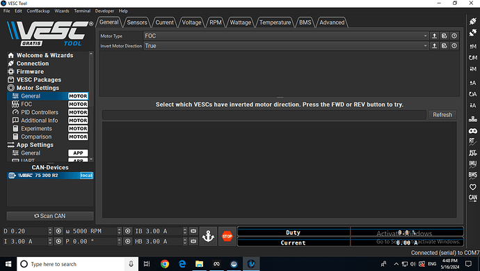

Hi folks I have built an efoil with a Flipsky 75200 VESC 6561 motor and and LG 10S11P 2070 battery. I am having an issue with the VESC cutting out on the water aroun 80 to 90A. The battery is above suspicion several people on the forum have the same battery and it’s fine. The VESC is not getting hot the remote report 25C max. I tought it was my BMS so I added a nother wire and connected everything direct no BMS but smae results. It must be my settings. Here are my settings if anyone can spot something I did wrong.

After the initial motor config wizard was complete I had to change a few things and only these things. I find these under “Multi settings” “Limits”
I set Motor Current max to 180
I can’t remember if I changed Battery Current Max but mine is 250
My Battery Voltage Cutoff Start is 32
Battery Voltage Cutoff End is 31
I changed Battery info under Motor CFG - Additional Info to 10 Battery Cells Series.

There is a setting within Motor whose name is Slow ABS Current limit that shows ON in my setup. This is what the Help screen says about it. I assume this is what Mark mentioned. This was already ON from initial motor wizard step so it would seem odd if yours was OFF.
