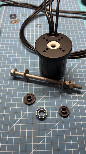

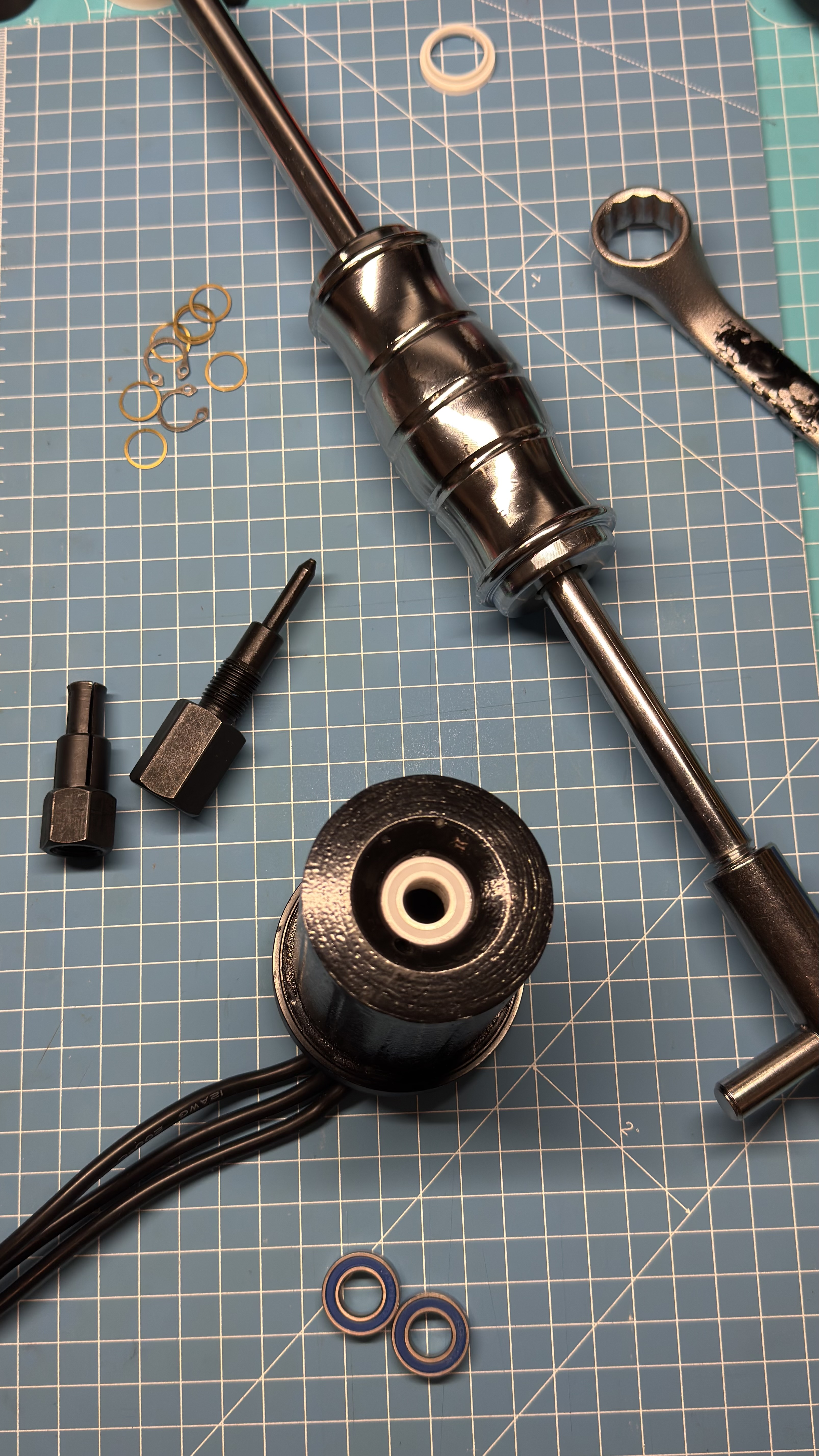

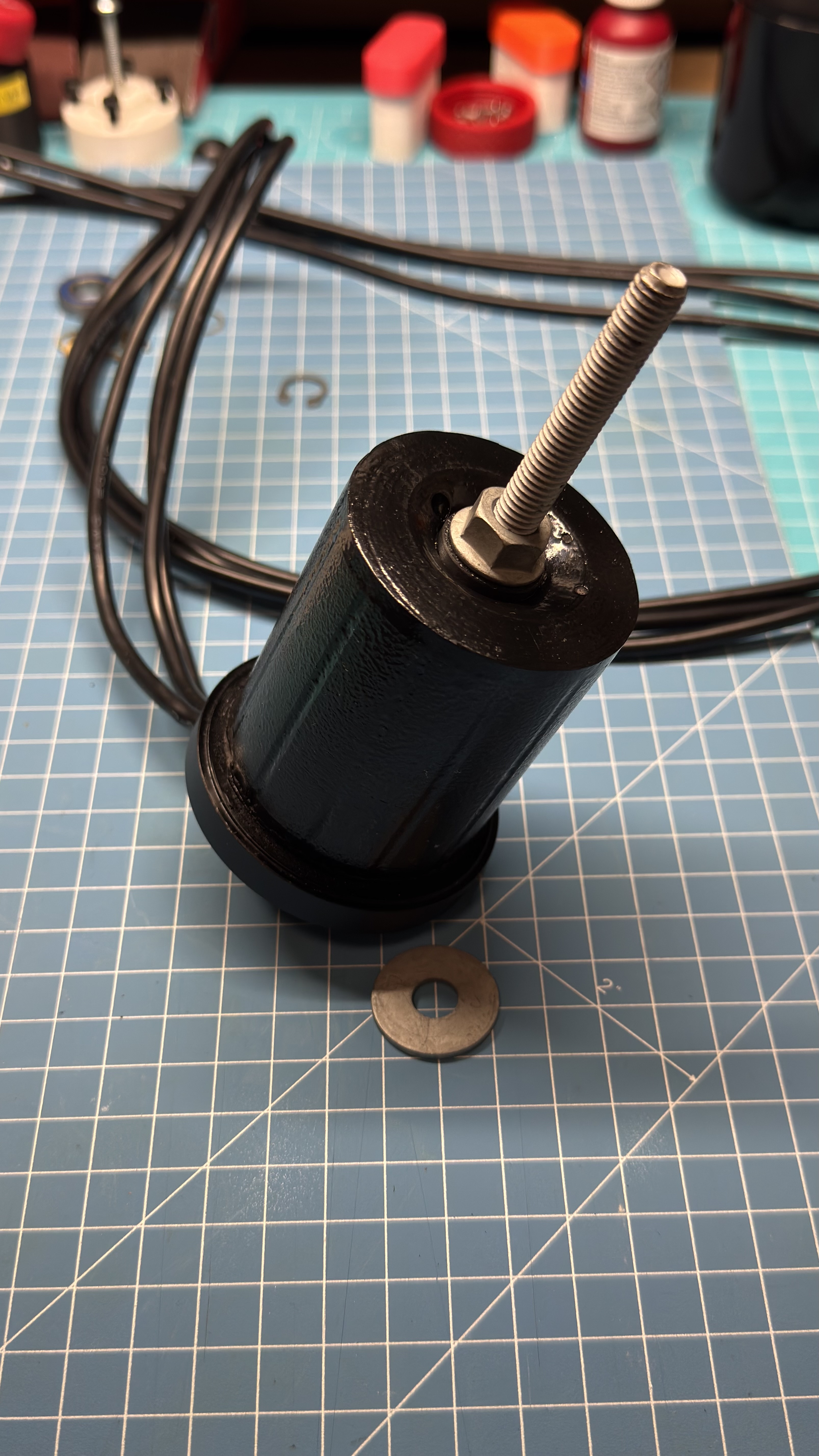

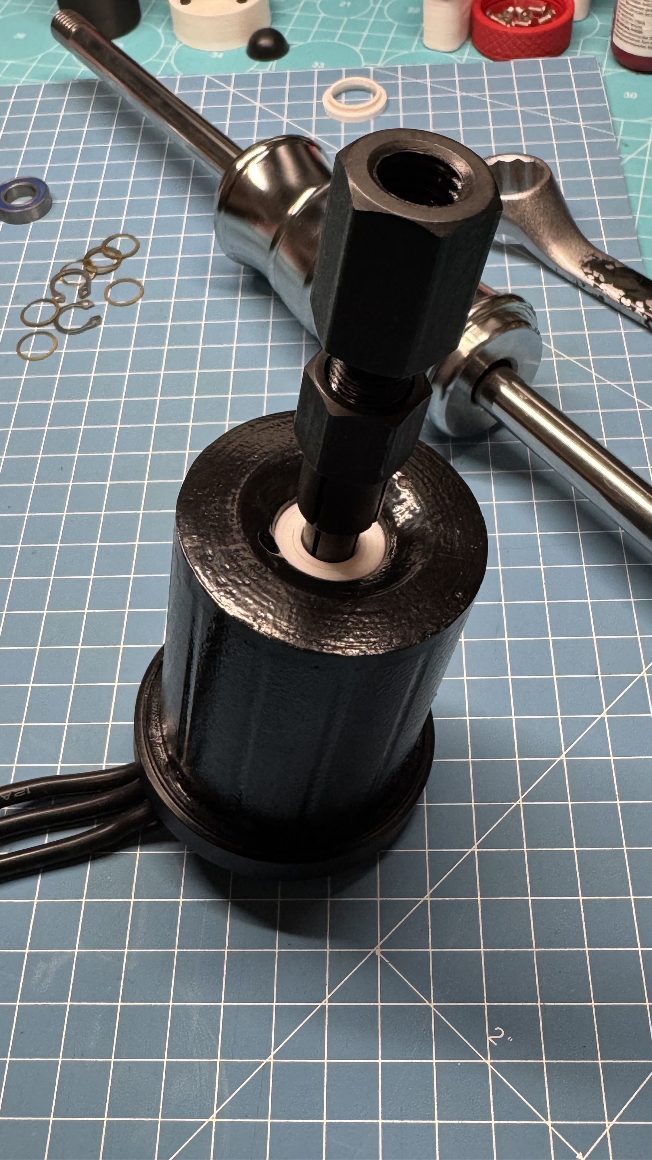

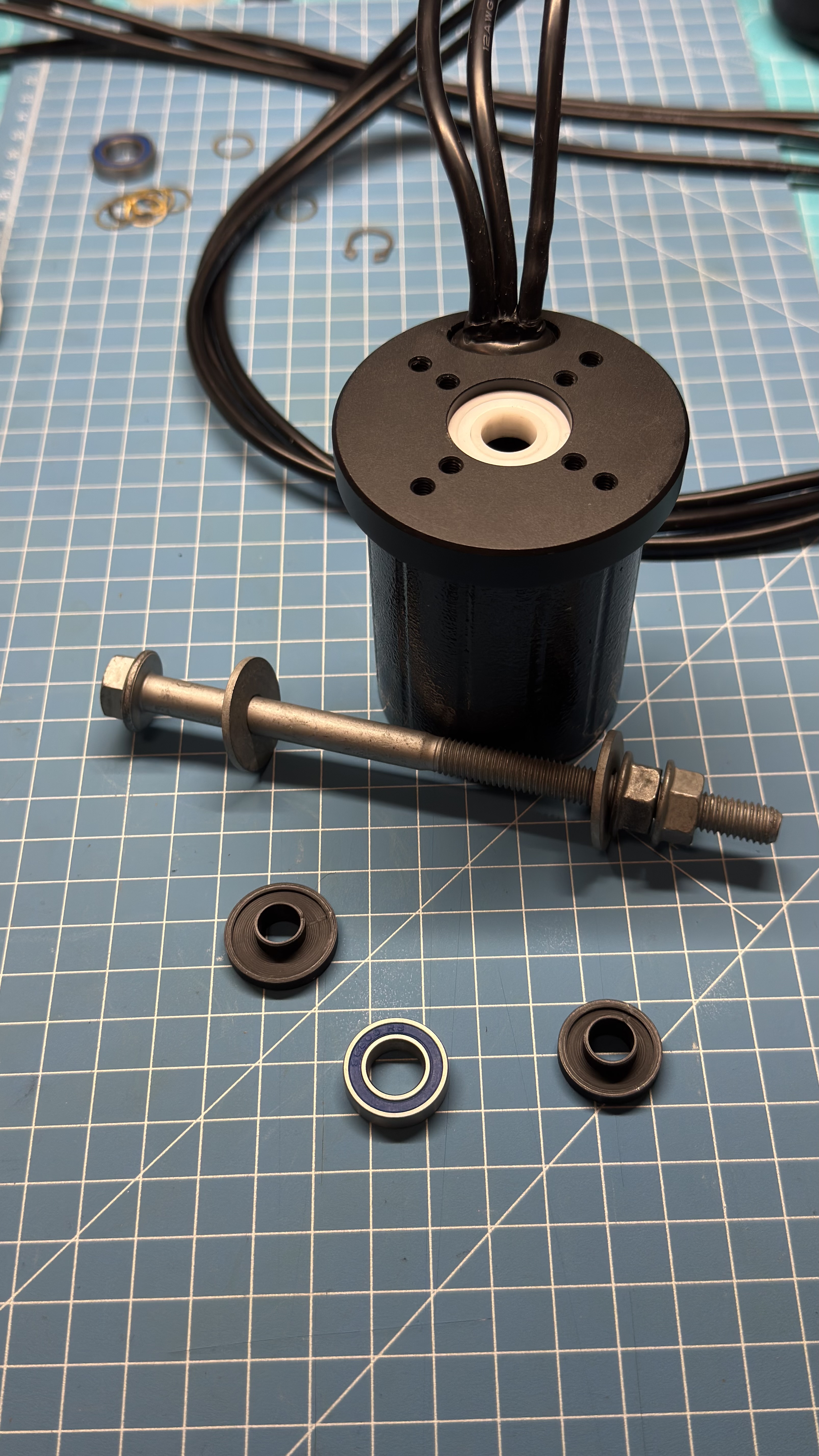

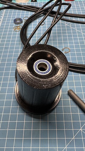

Today I replaced a bearing on the first engine.
Here’s how I always do it:
An internal bearing puller works best.
I only replaced the outer bearing.
Thanks for the tip @Jan12
The new bearing was then pressed in.

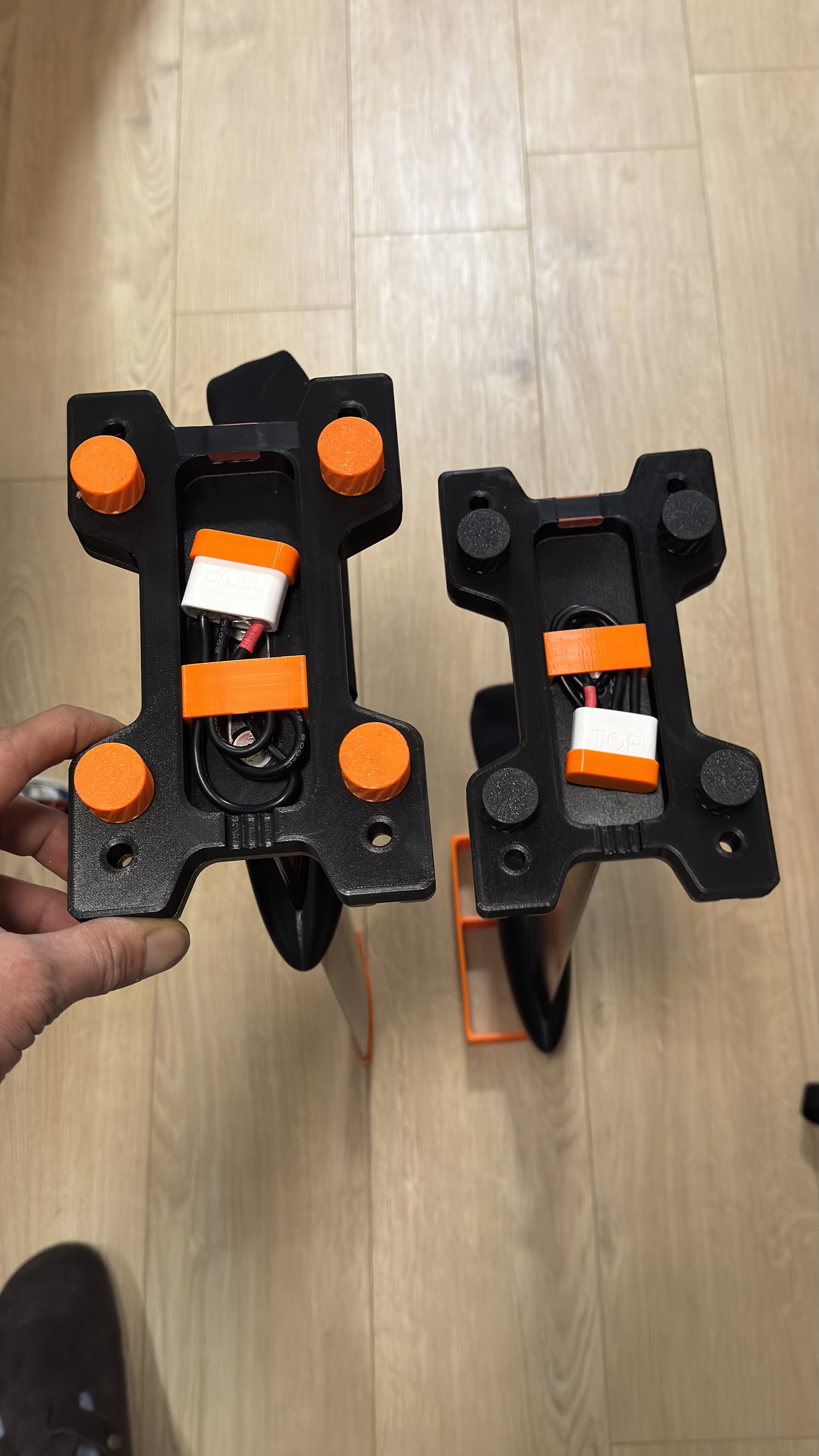

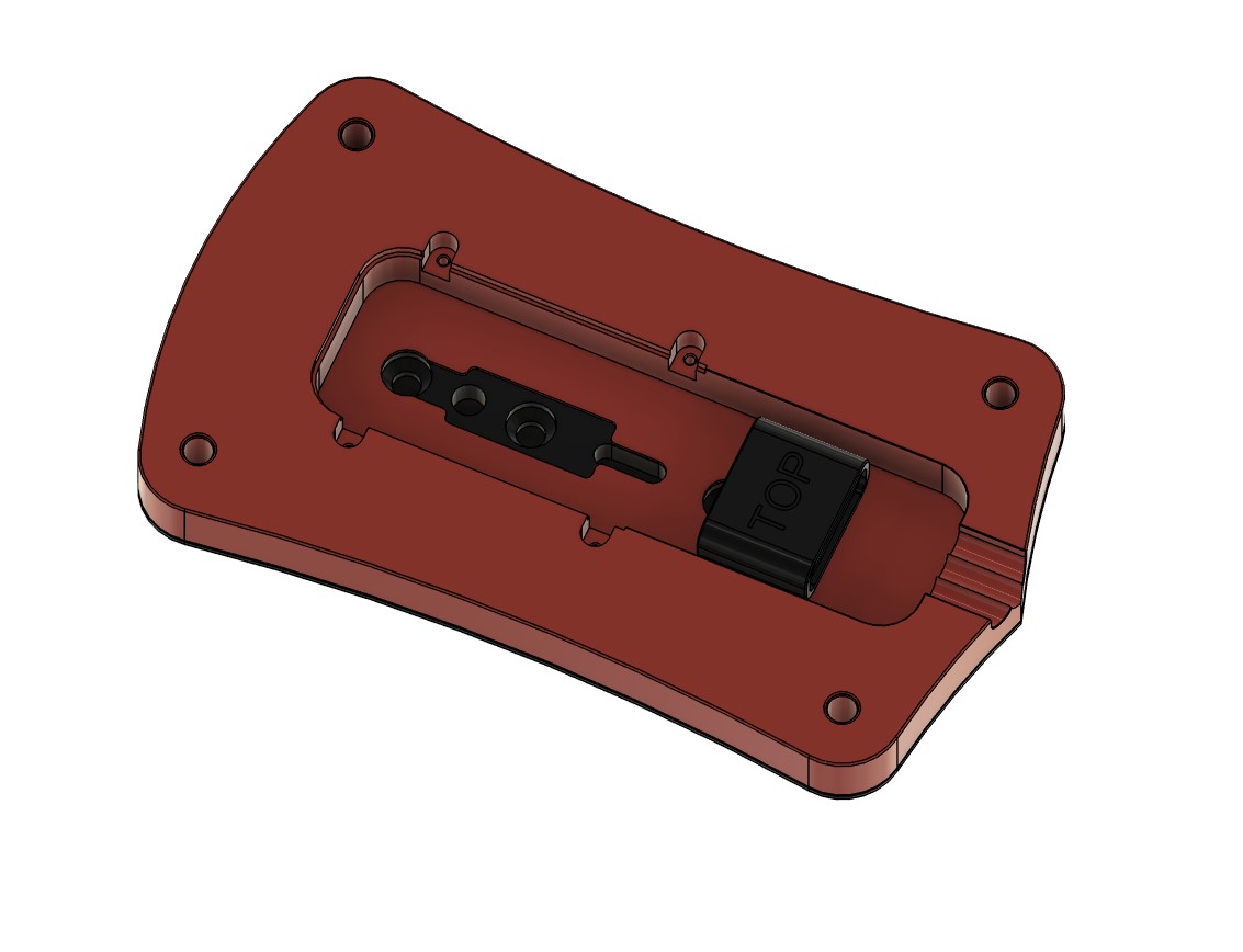

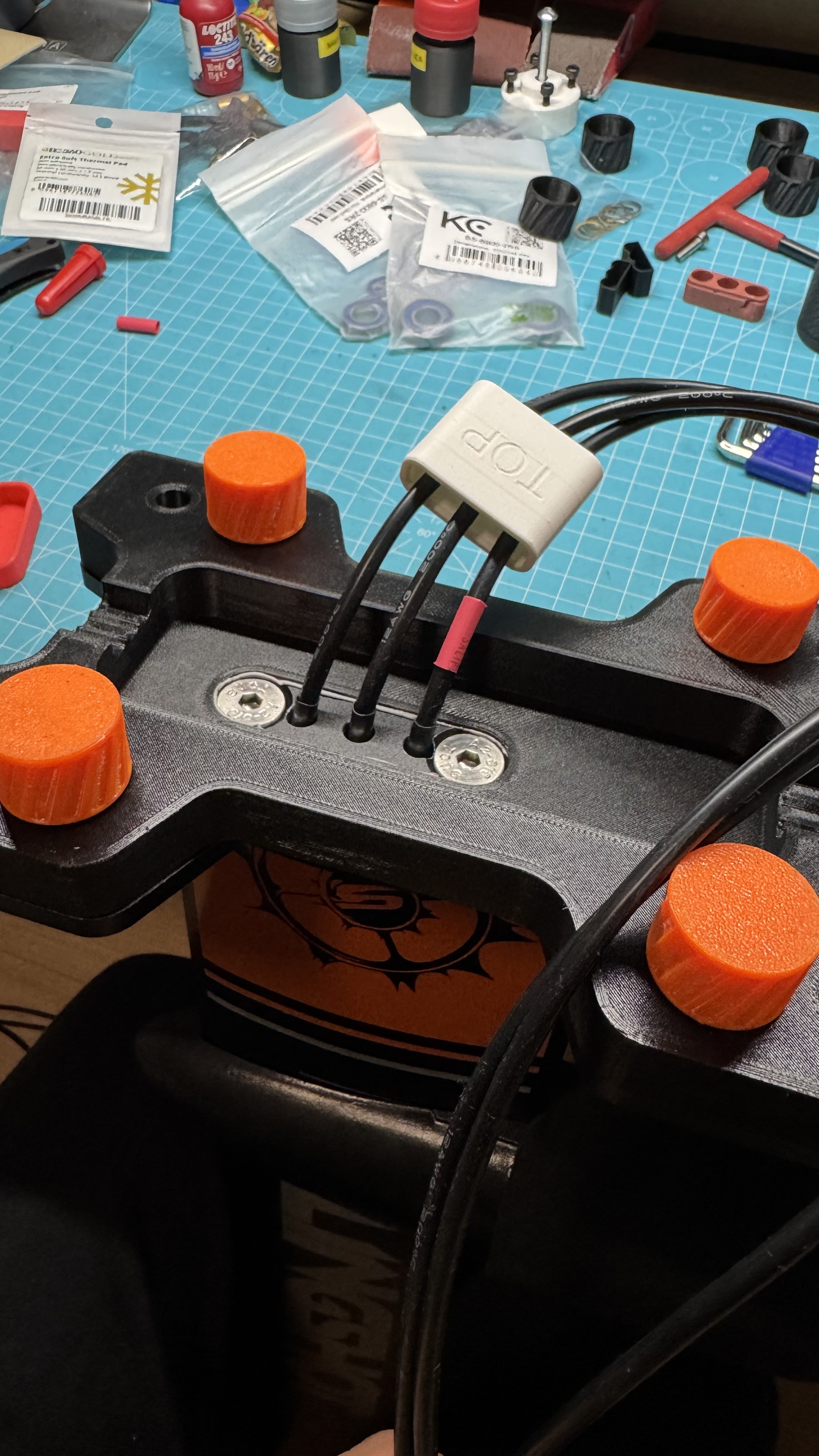

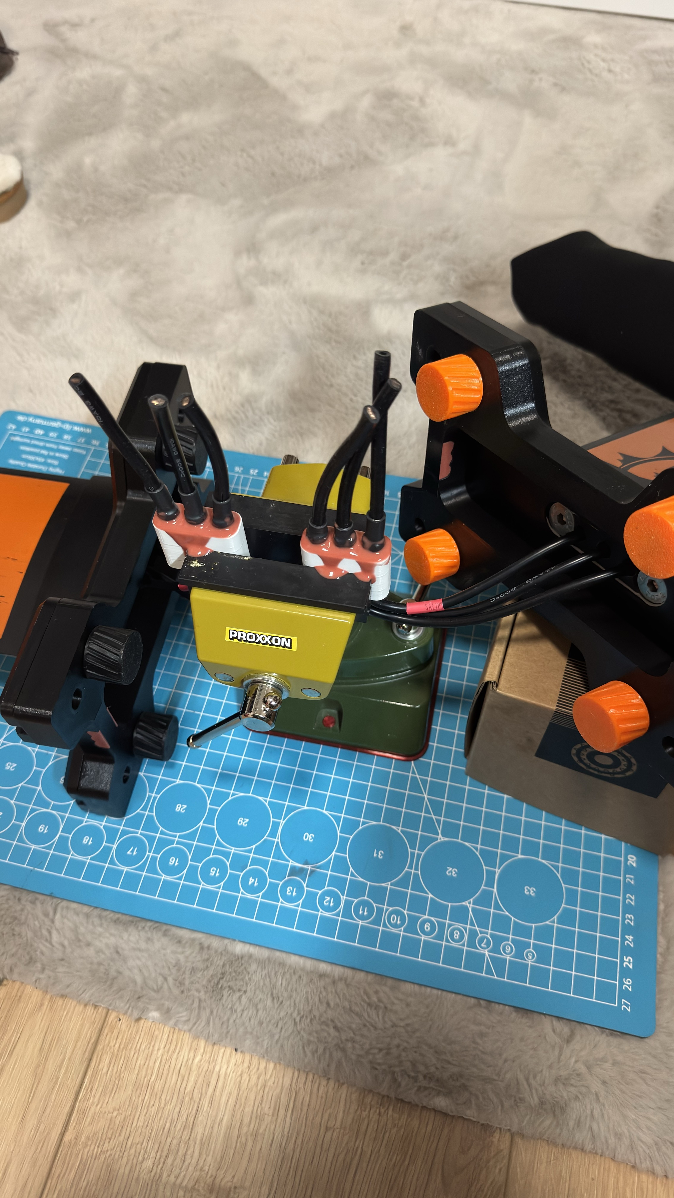

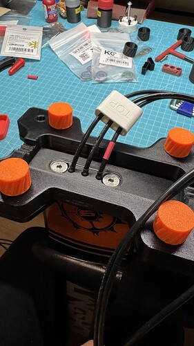

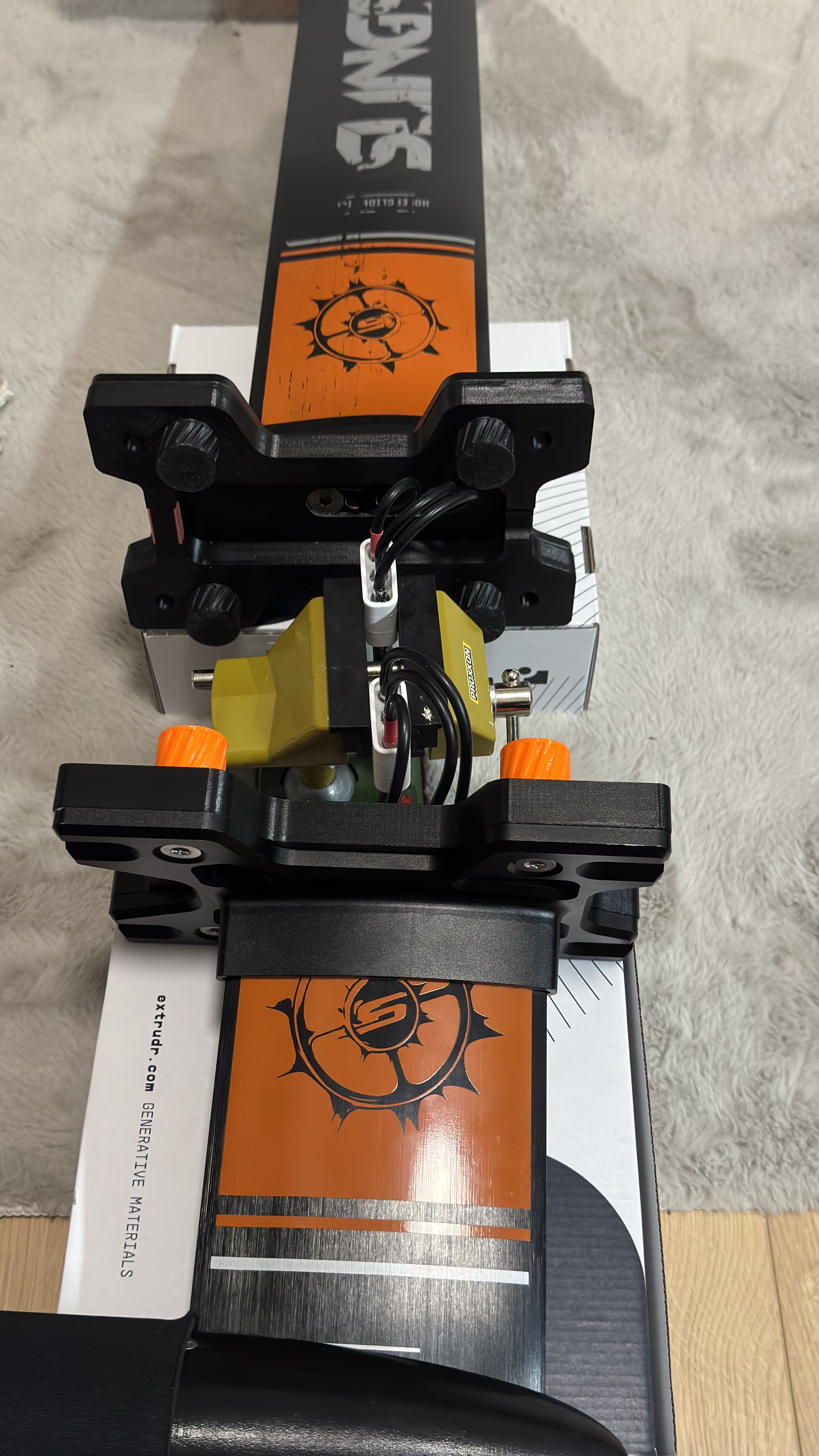

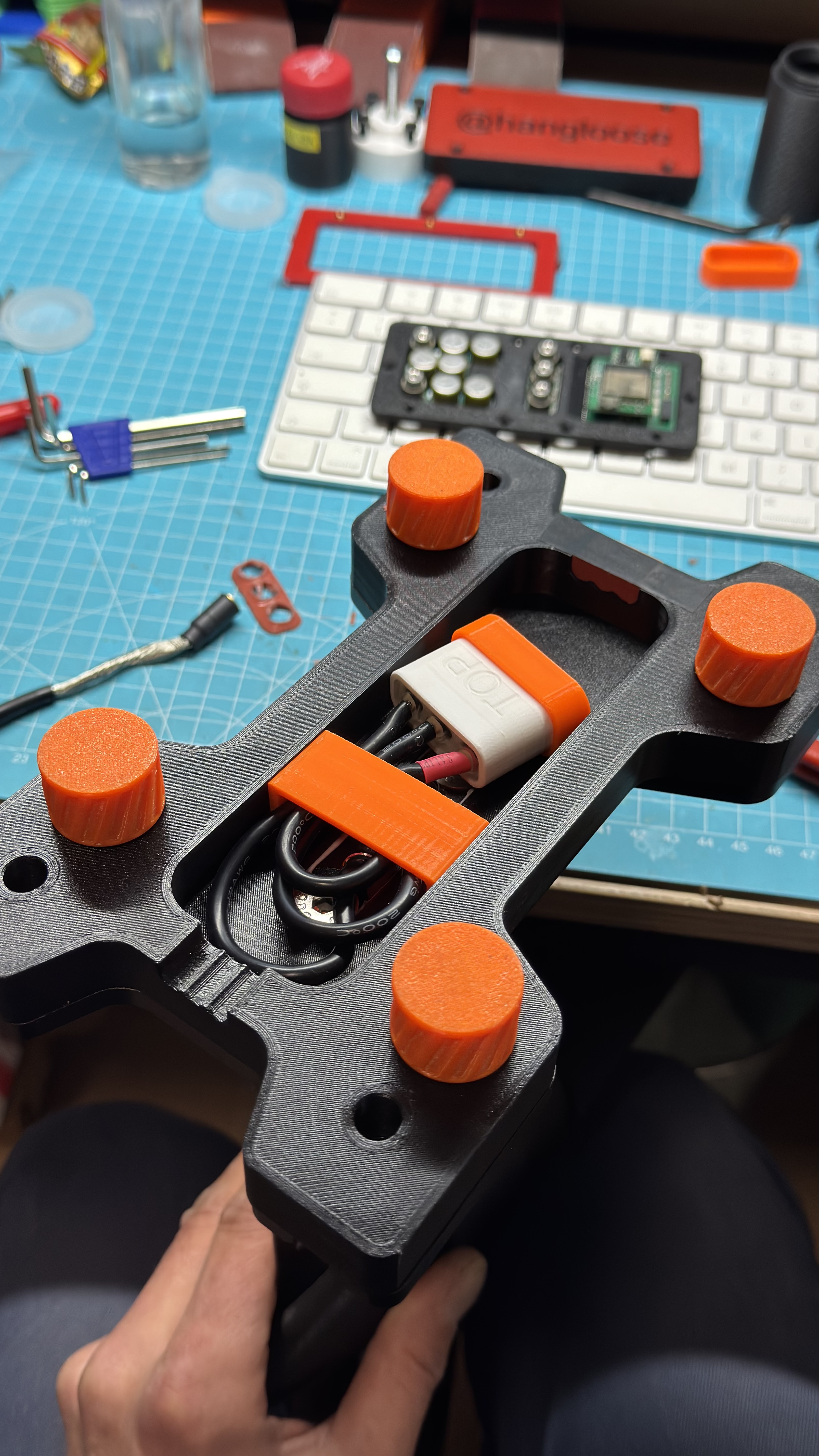

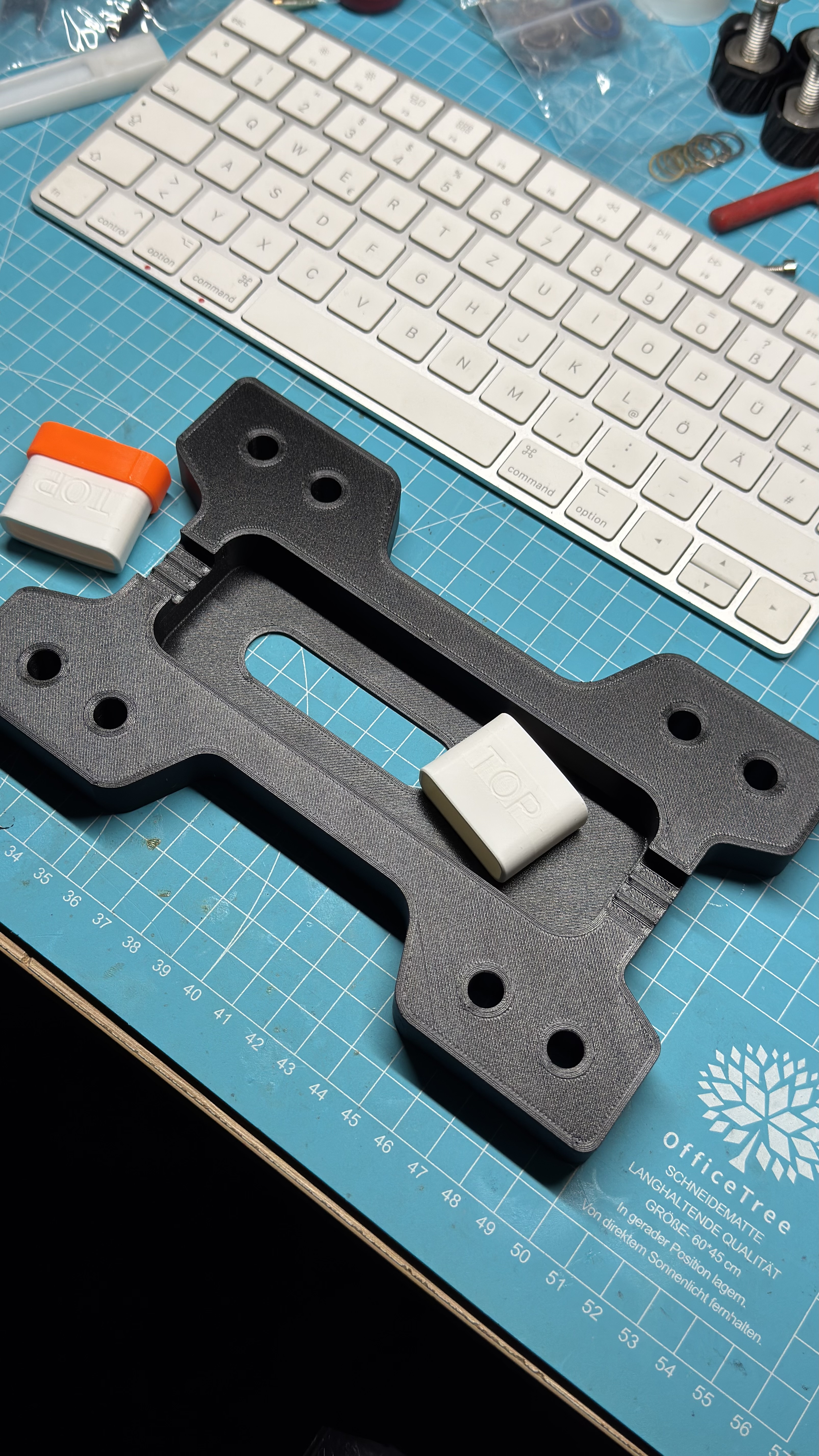

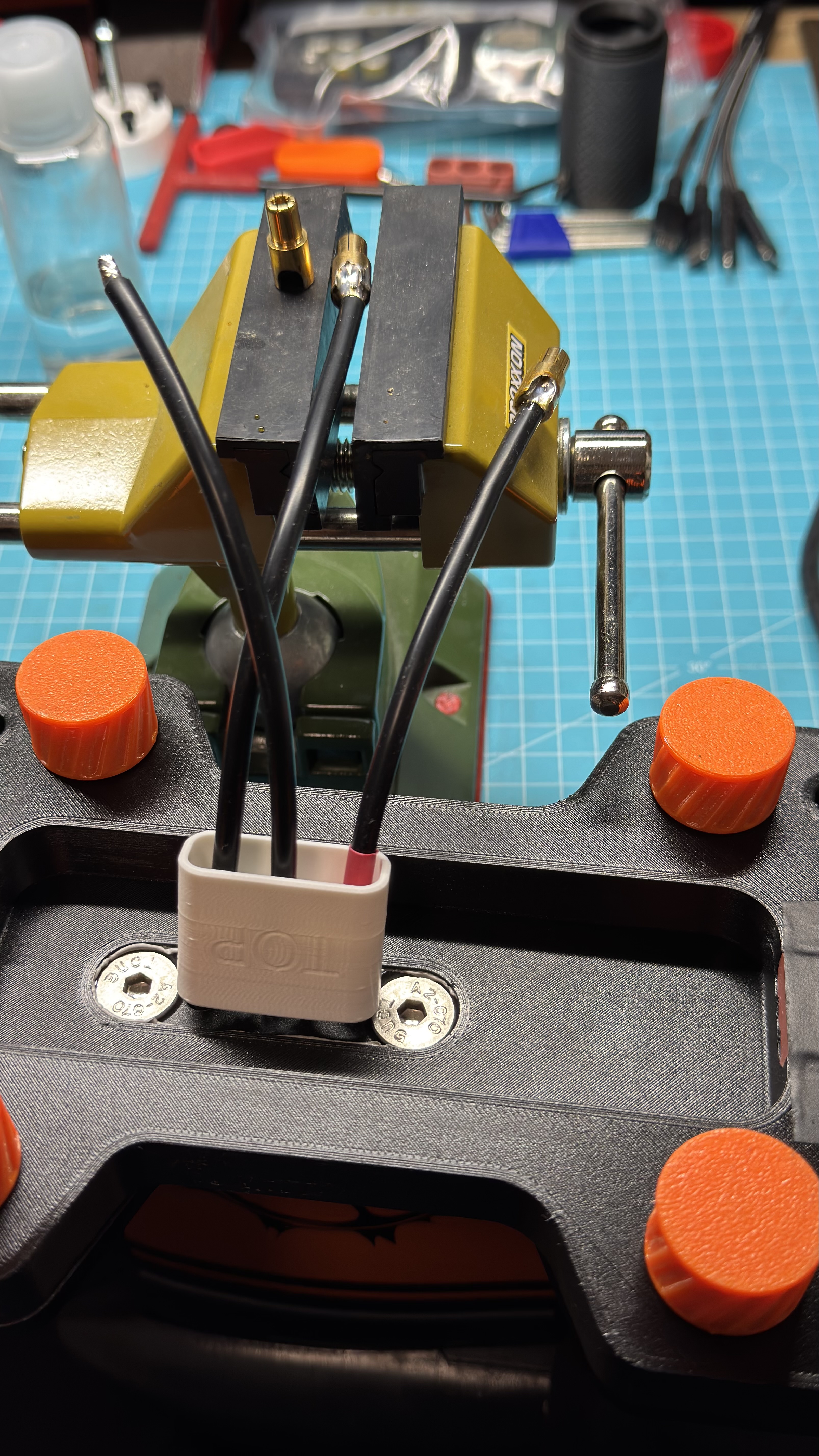

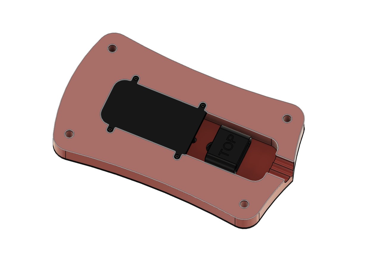

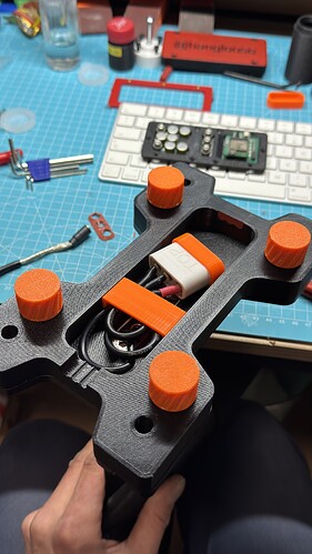

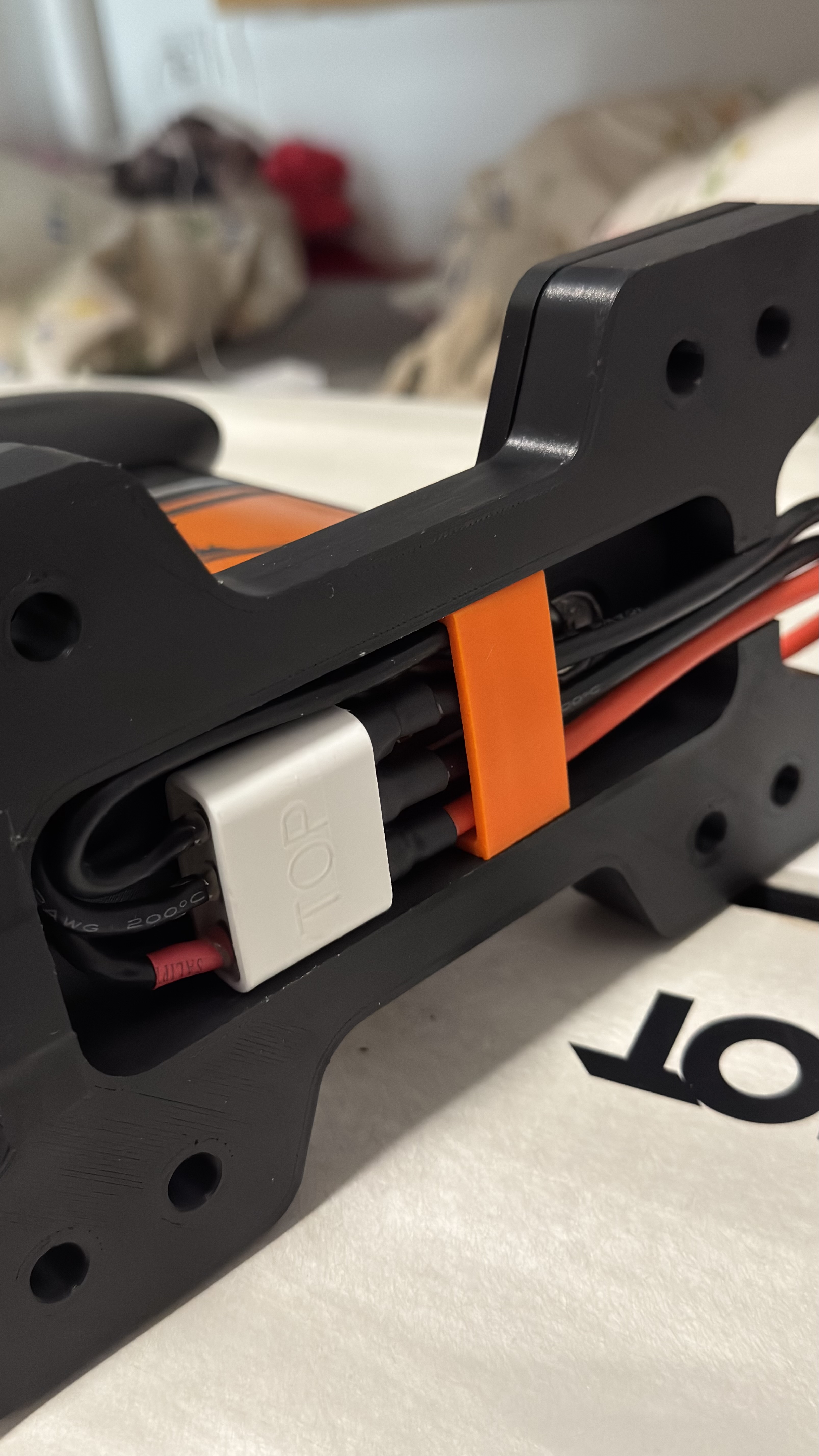

I modified my mast spacer plate.
Now I can also route the cables from the front.

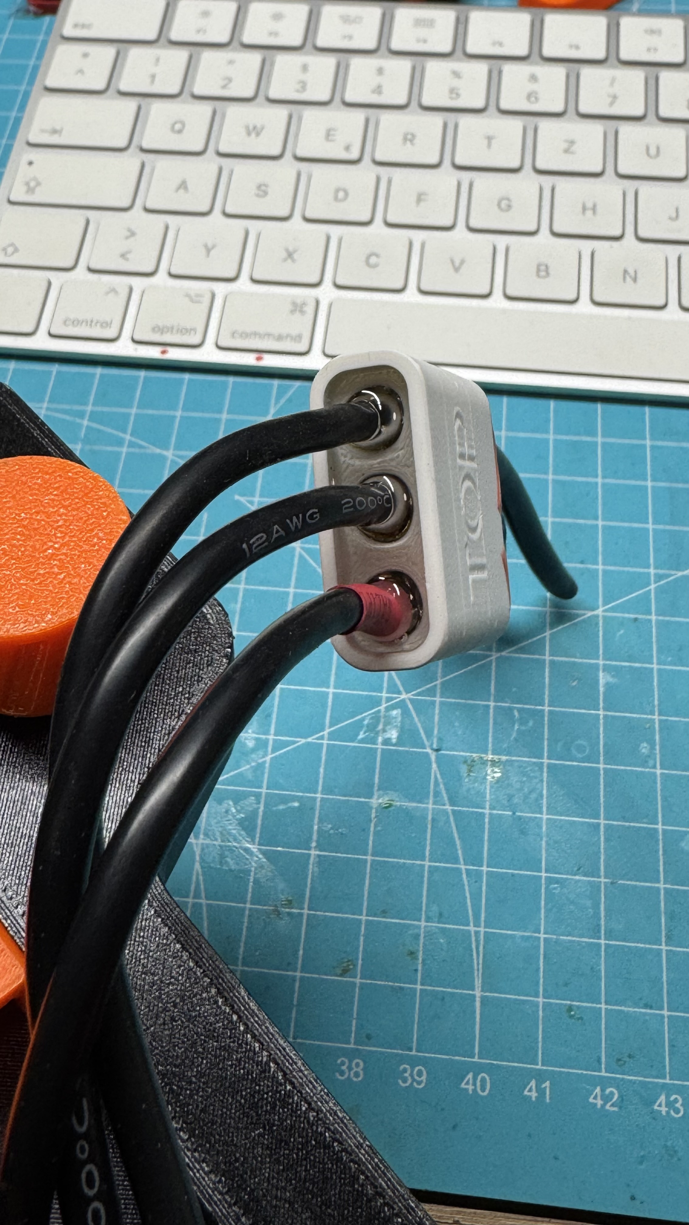

This time I’m using LMT-6 connectors made from PA12.

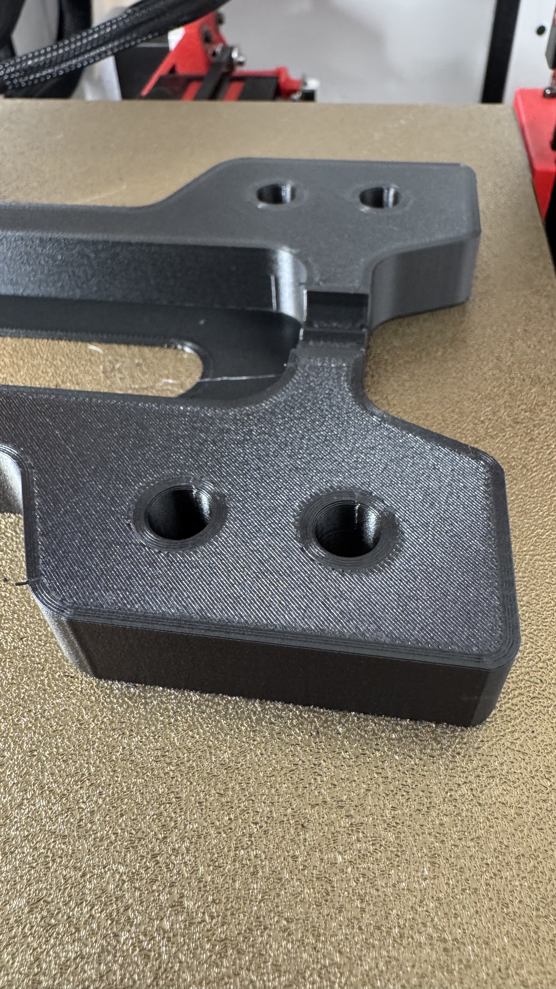

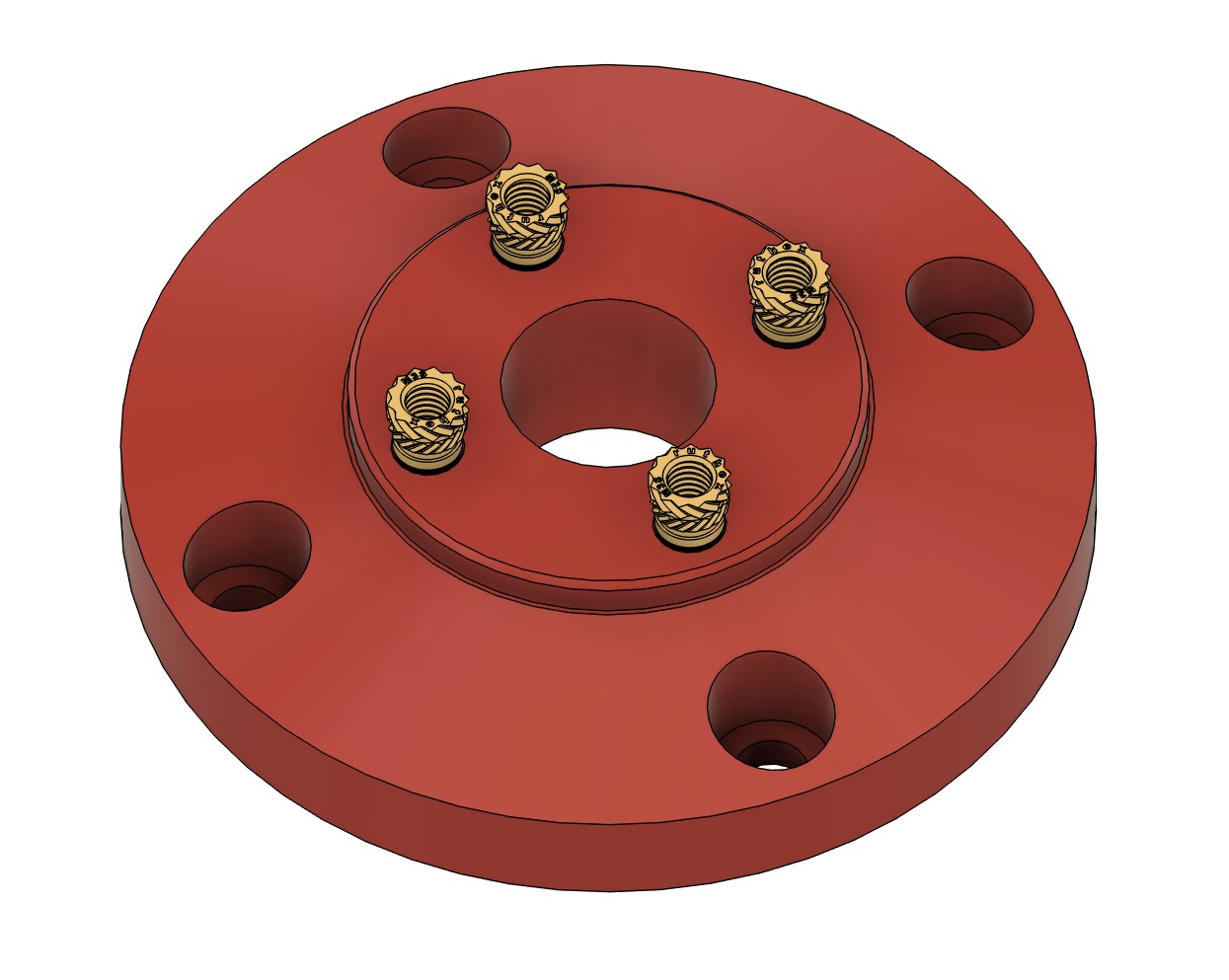

Is the adapter disc meant to fit the flipsky waterproof motor to a hub with the old motor spacing, or the other way around? Are you able to share the file? I have the flipsky waterproof motor but a prop that doesn’t fit that hole pattern
Hello.
I created the adapter disk to attach a prop with a BDUAV hole pattern to a Flipsky motor hole pattern.
Here is the file.
For the adapter you need M4 or M4s melt nuts.
That’s perfect! Thanks so much :slight_smile:
hi marcus
do u have the template for the box plate?
i want to make one for my project in progres (gong mast/board) but shud be compatibel
and no need to cut the mast for the wiring on the top

I have already created the Gong Mast Adapter Plate for someone.

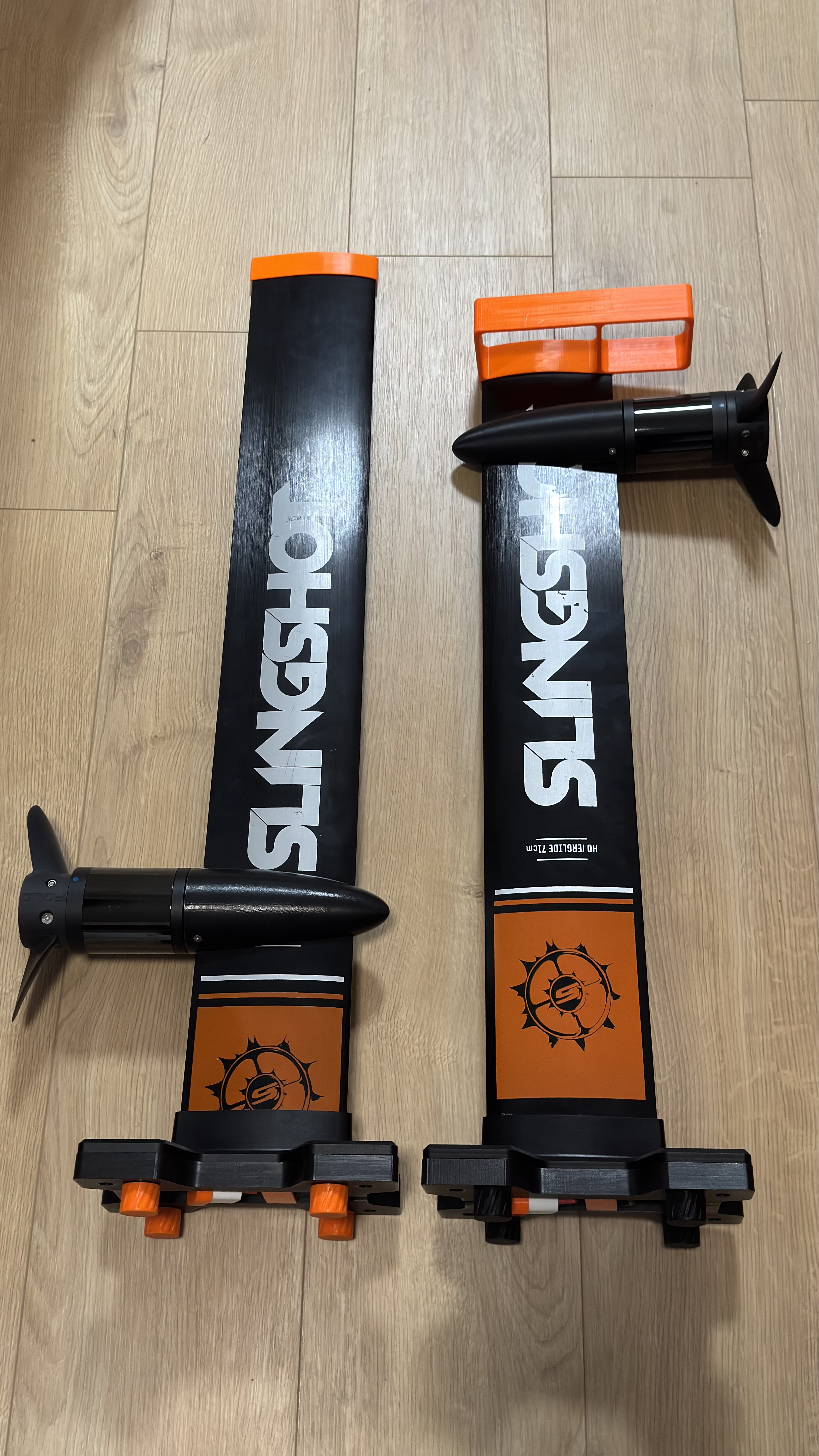

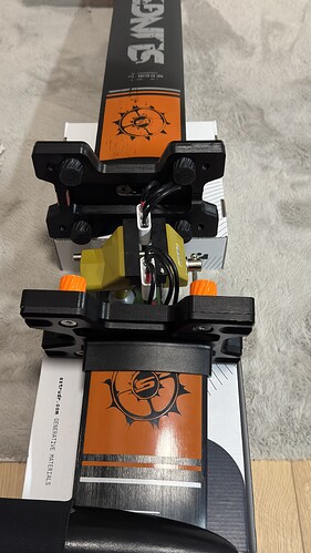

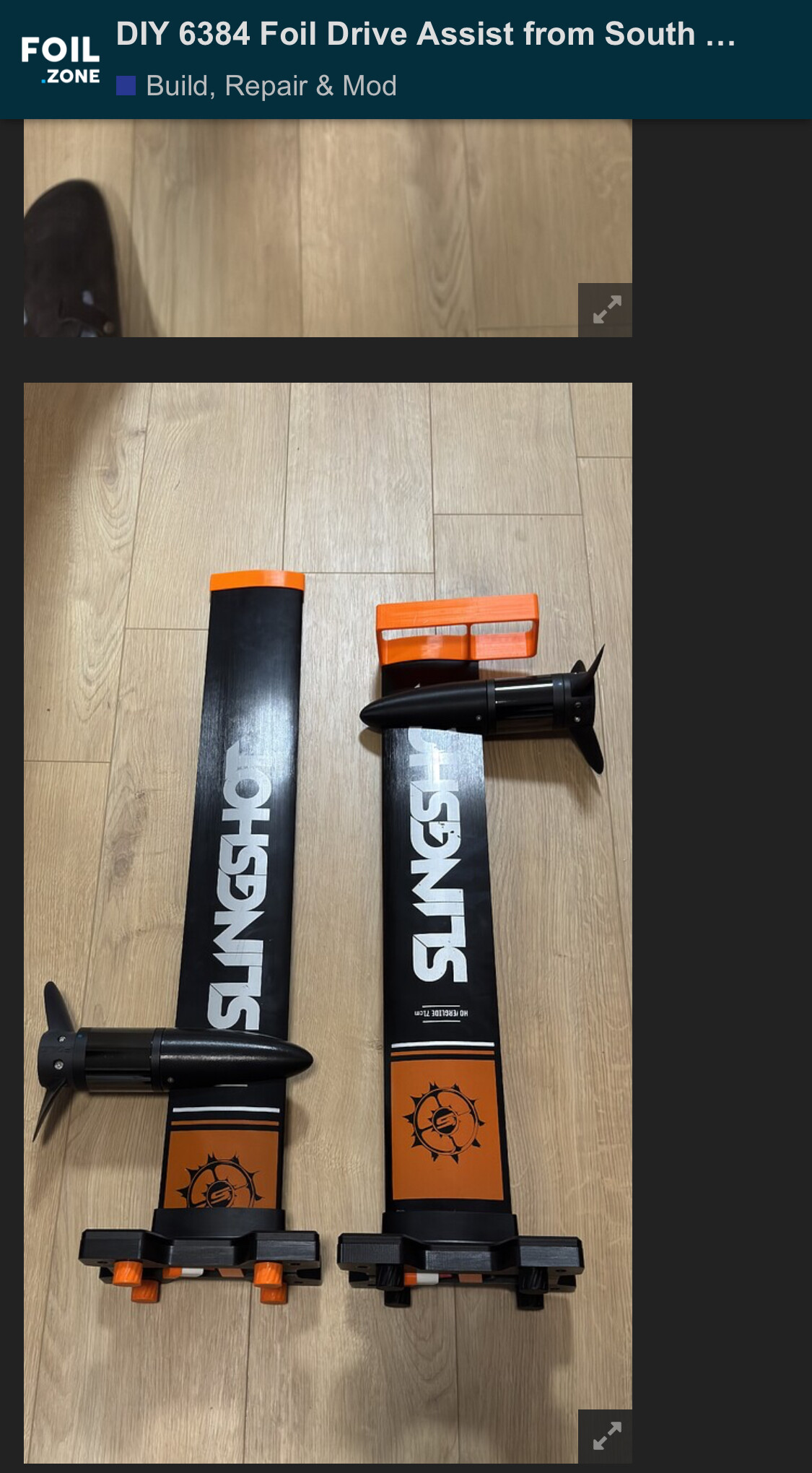

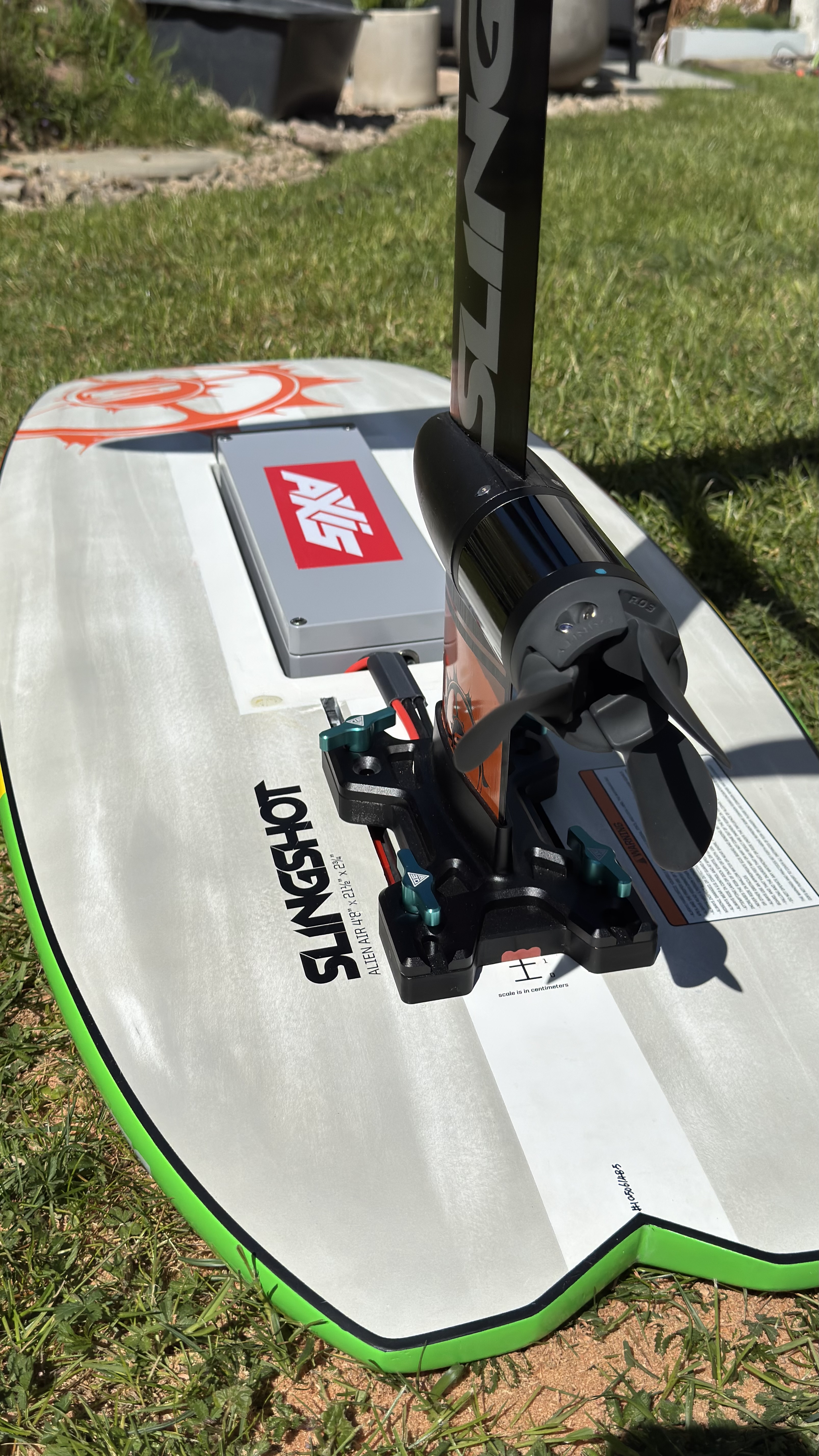

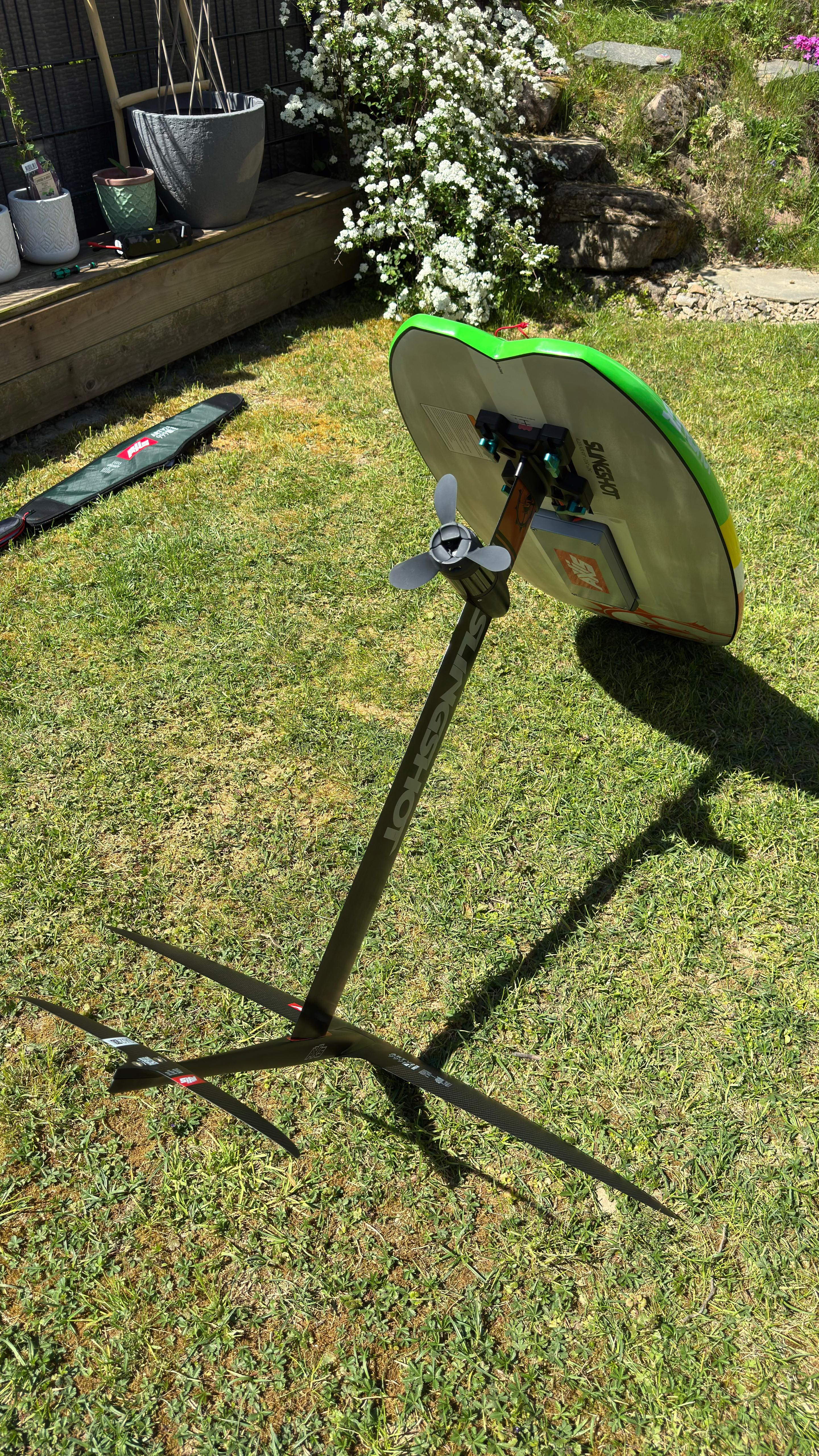

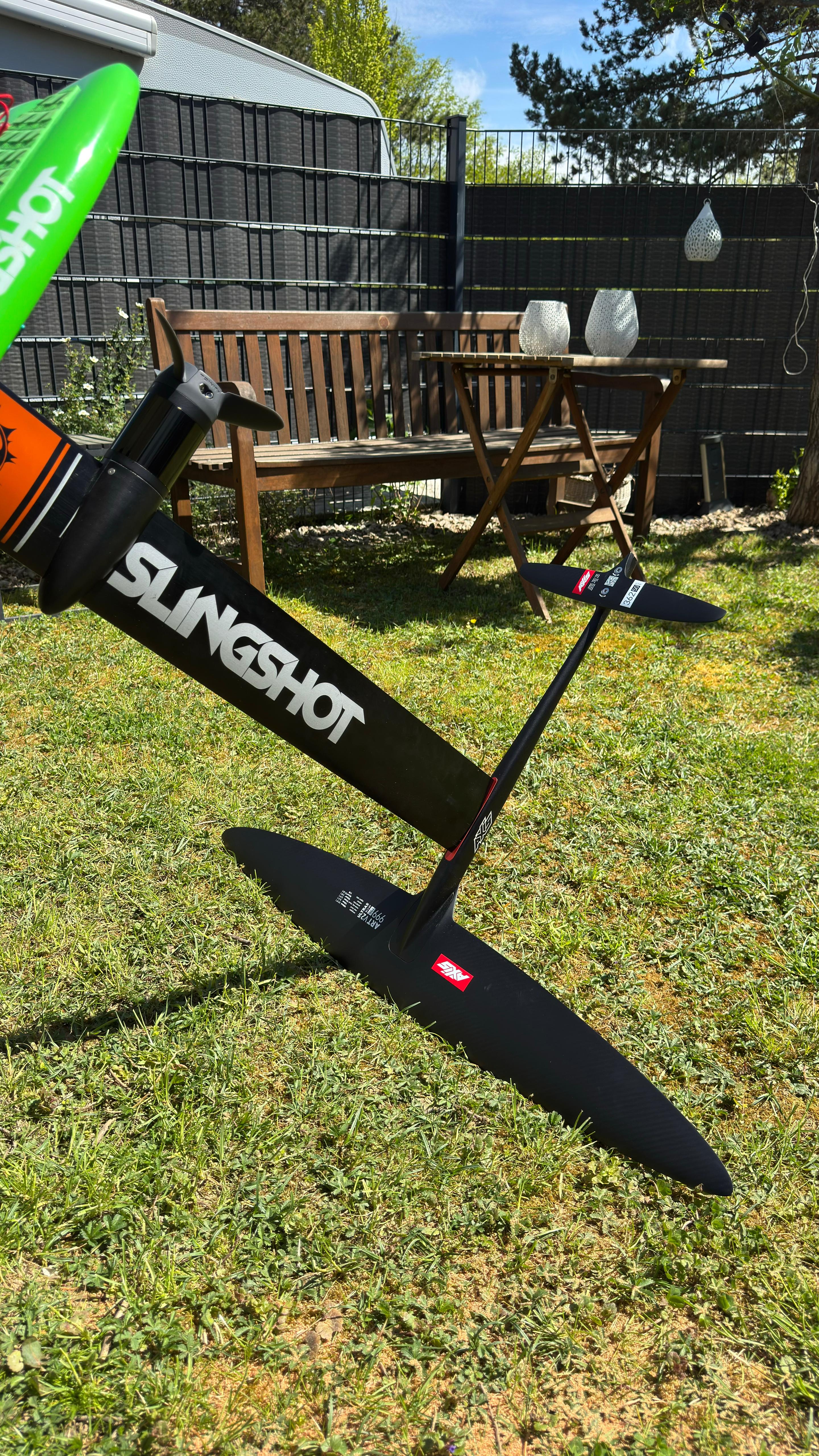

Today I finished my mast upgrades.
Now I’m moving to the Harry controller.
Curious why you use a shorter mast for the efoil position vs the longer foil assist one. Wouldn’t a longer mast be better in both uses?
For this I used my third mast with 82cm and 63100 from my 2nd build.
The 71cm EFoil mast is mainly for my daughter and my backup :call_me_hand:

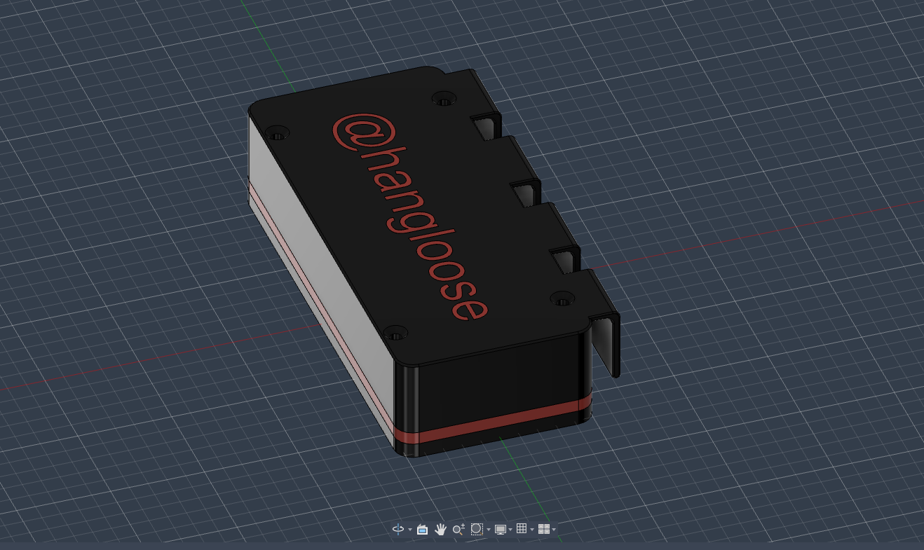

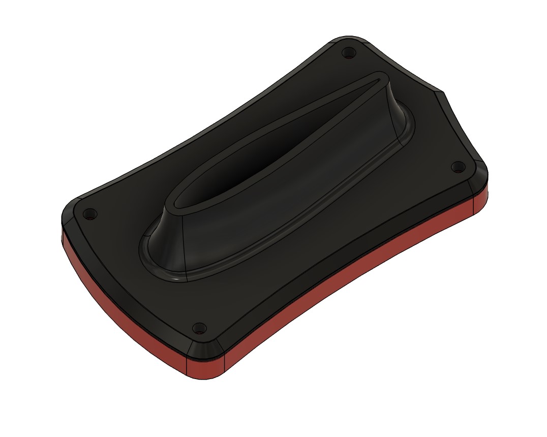

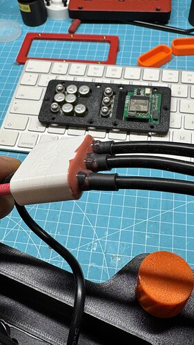

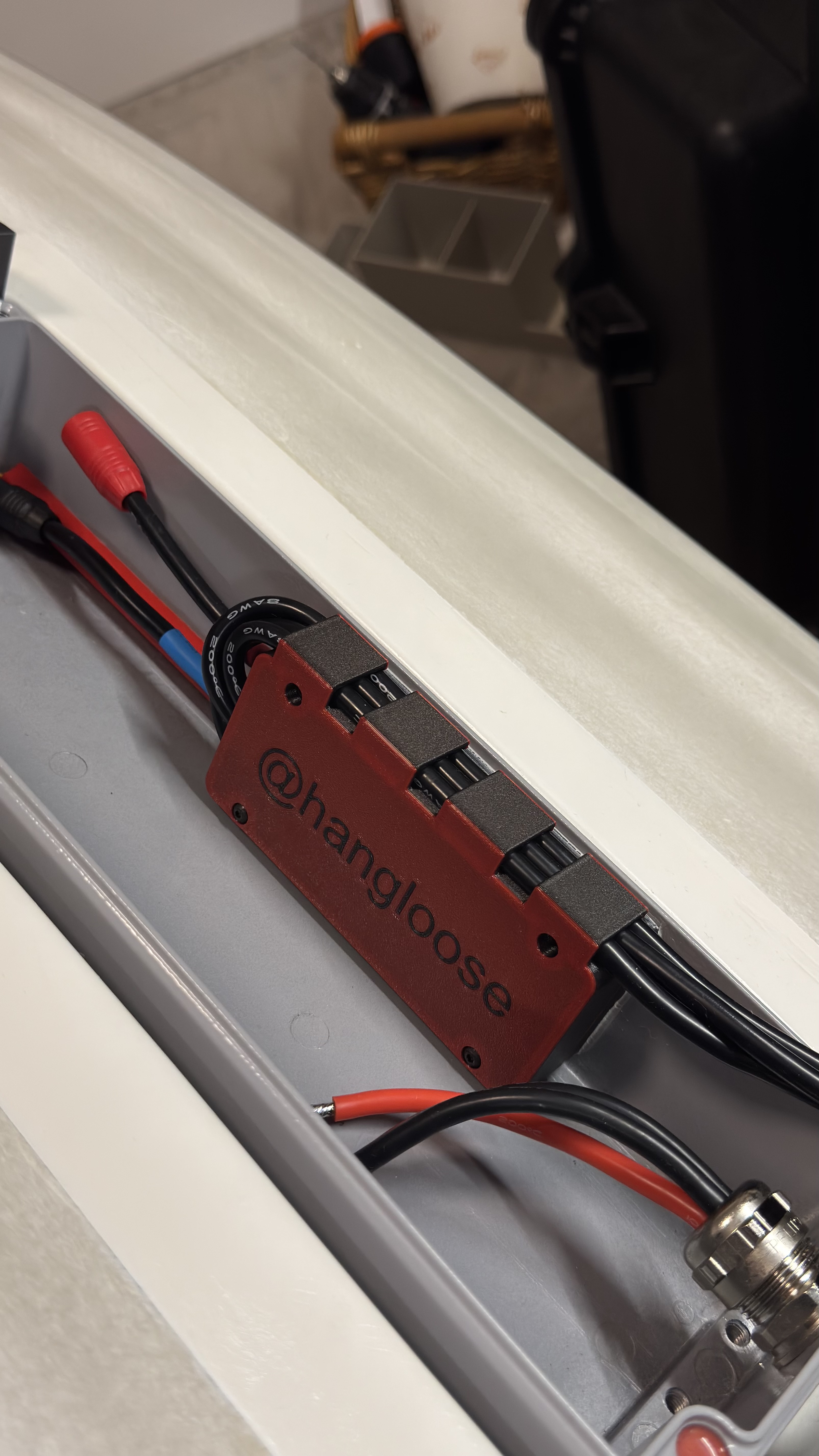

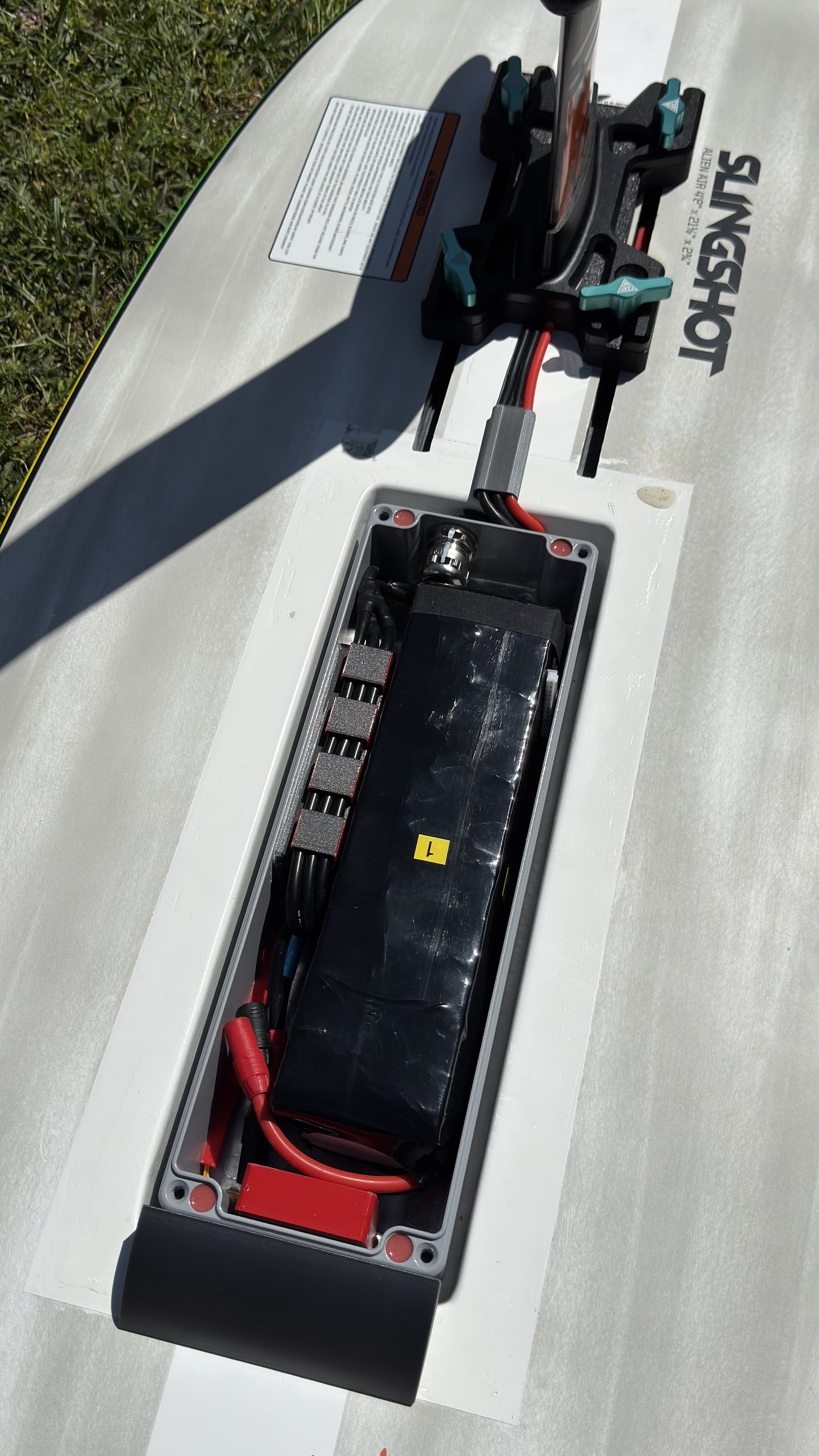

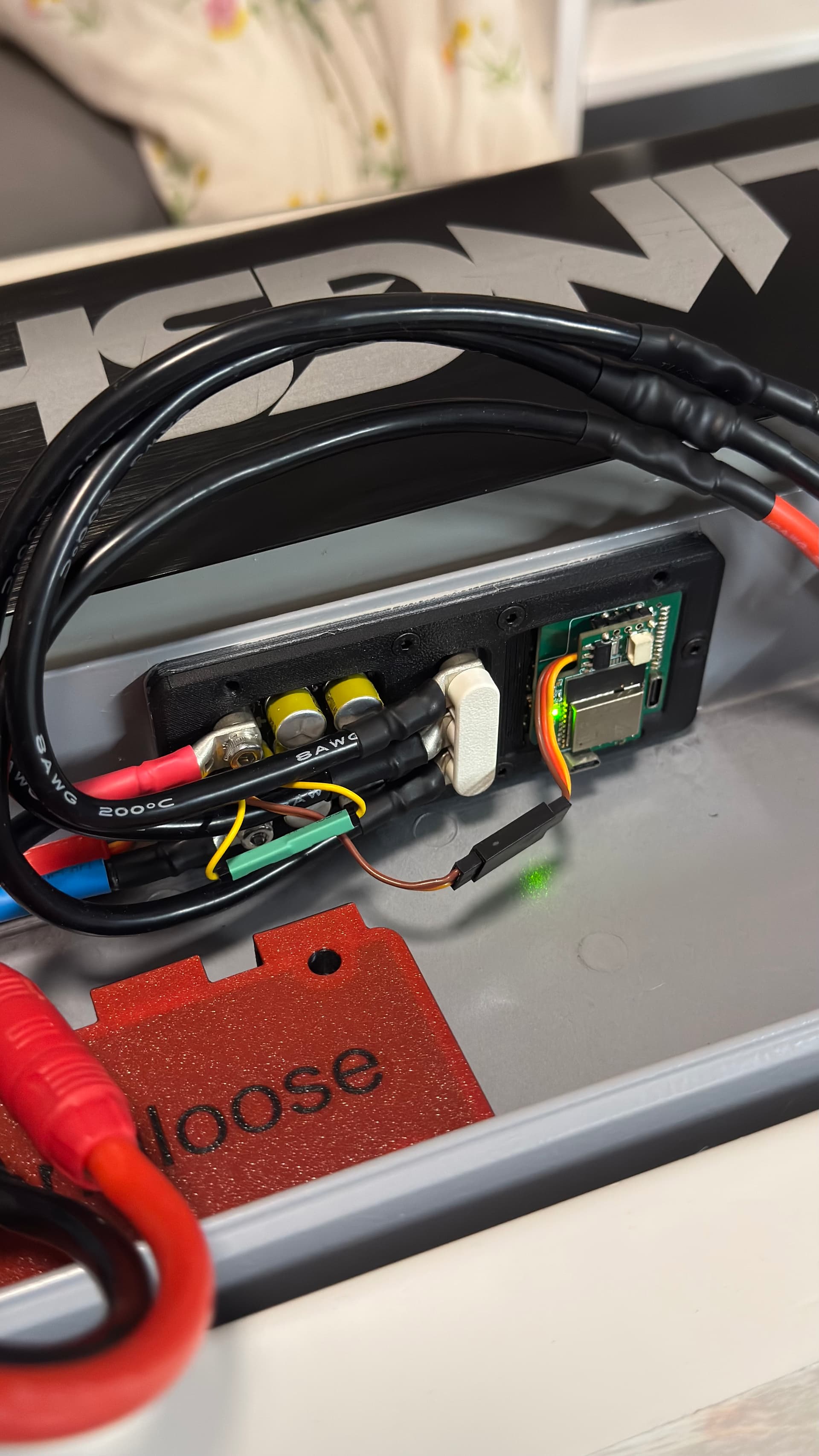

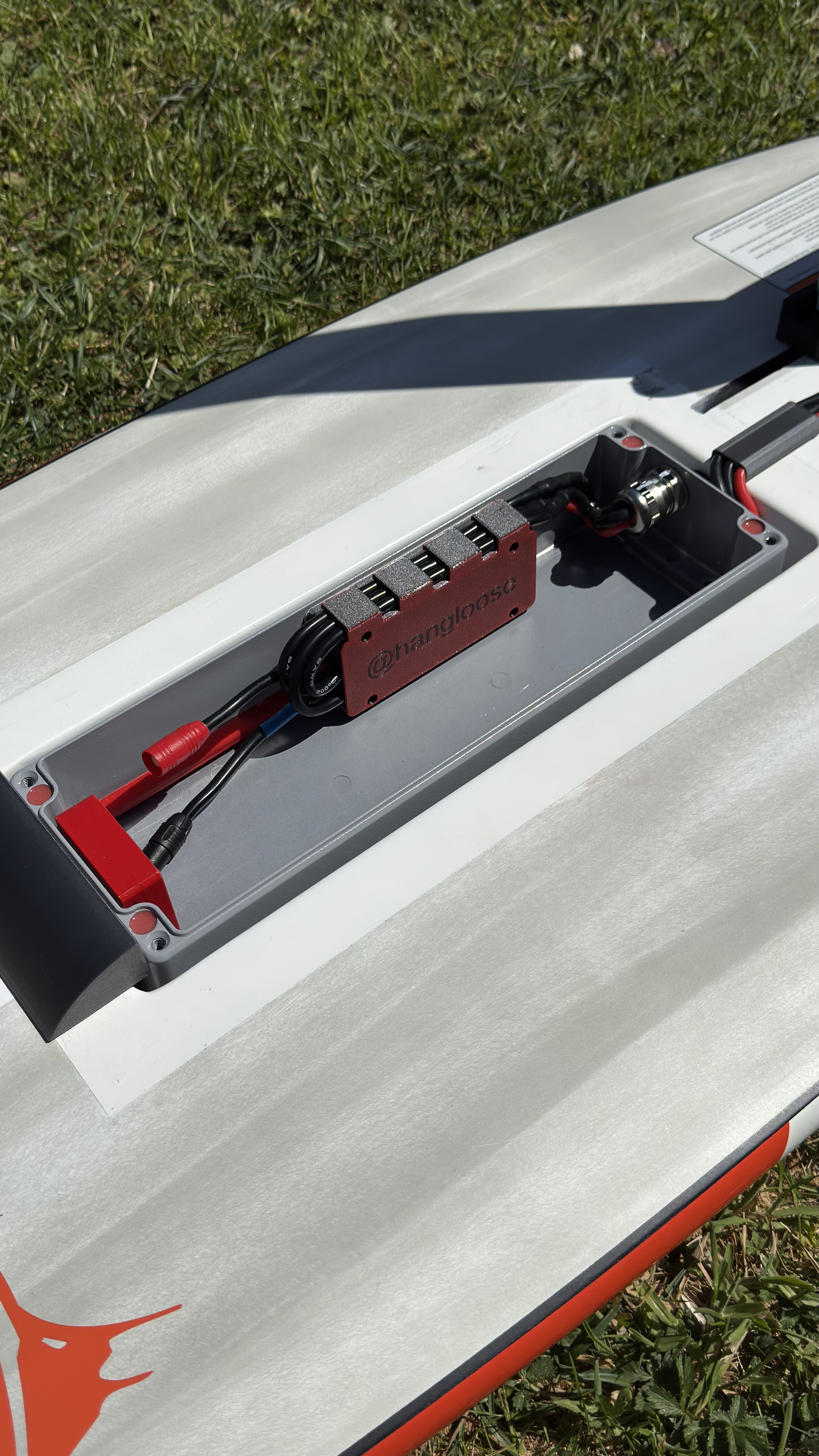

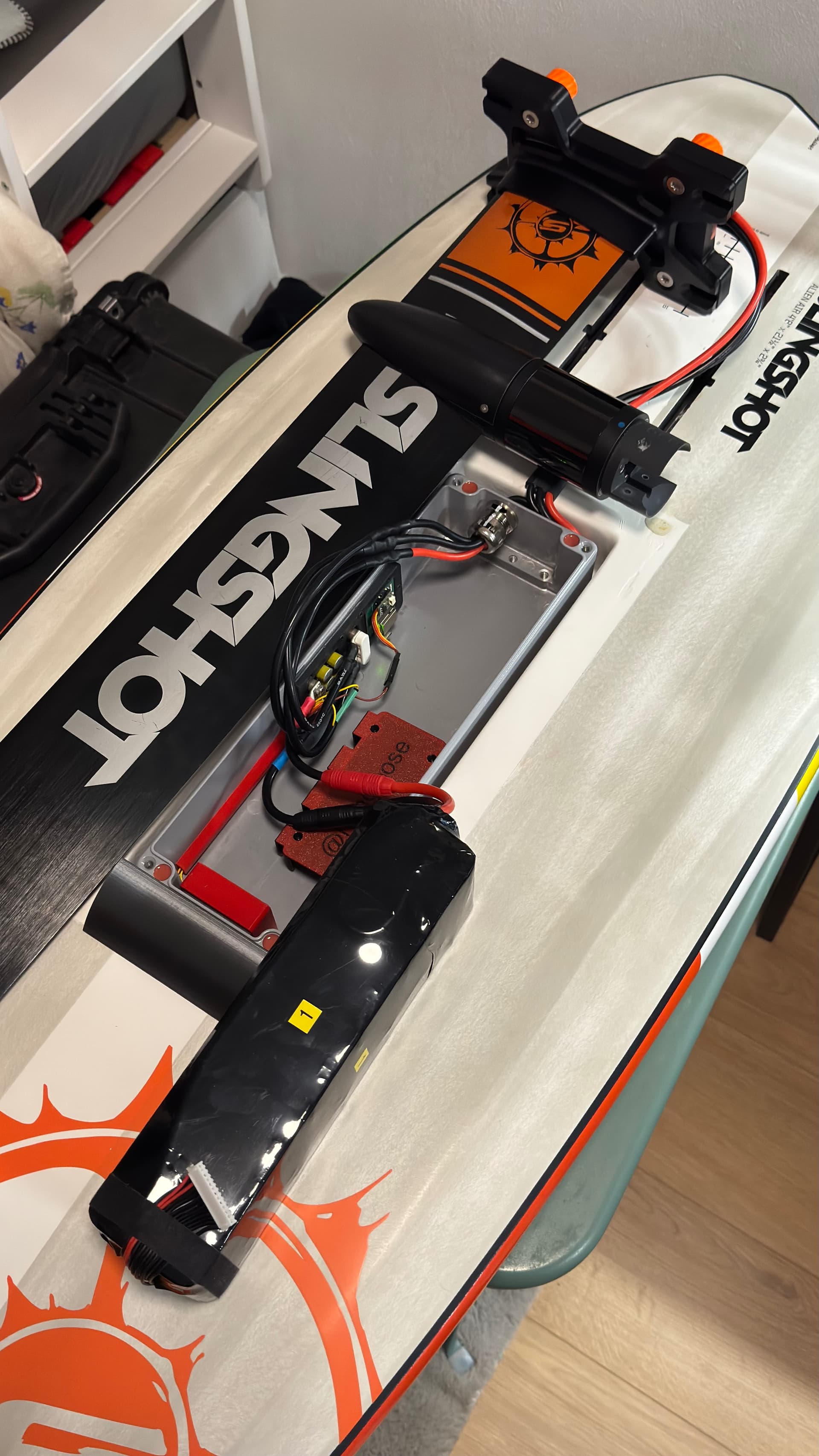

Progress on the ESC.
I’ve further optimized the first ESC Case V1.
Now the motor cables have a clean routing.
The case has also become slightly taller to provide more space inside.

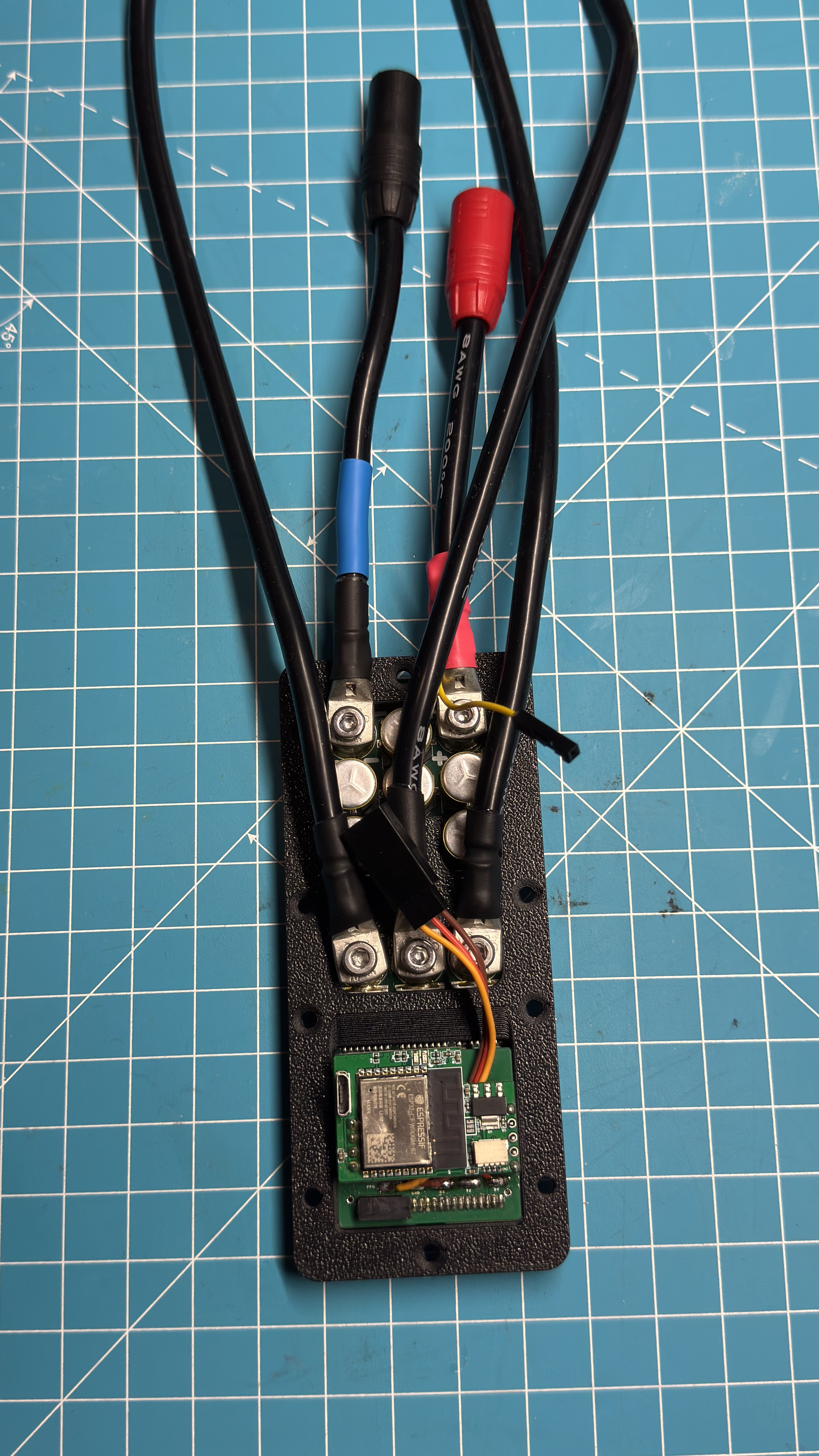

Today I also finished the wiring on the ESC and did a test installation.
The mounting frame on the Bopla is now glued in place.
Next up are the motor cables and the programming of the ESC.

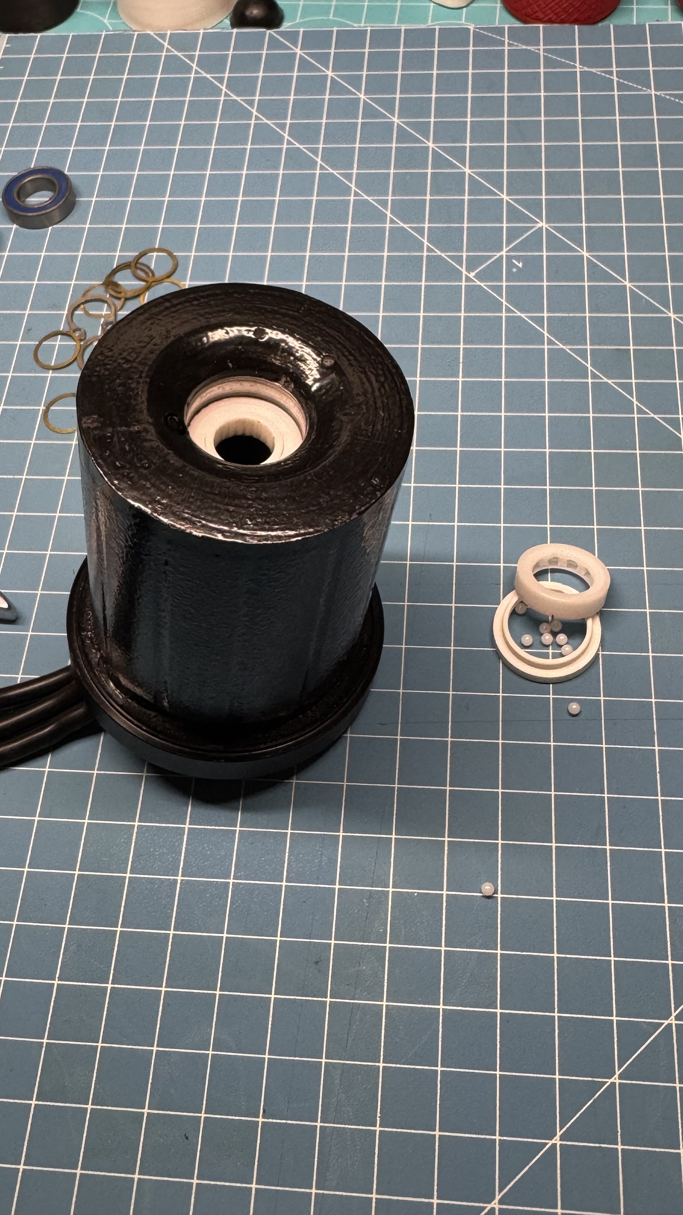

What maintenance do you do on your motor. Do you pull off the cap and wash it.
Mine 6384 has seized up after 7 sessions which I only rinsed the motor after use and didn’t pull apart.
I mainly foil in freshwater.
After that, I pull the rotor, dry everything, and let it dry.
When I’m at the sea, I also pull the rotor and rinse thoroughly with fresh water.
Then I apply some Fluid Film AS-R.
Today my project went a little further. :surfing_man:
Motor cable laid, the plugs soldered and the controller attached to the cooling pad and Bopla.
Then it went to the MAC and the VESC tool.
Motor Wizard and the basic settings are done.
Since it’s my first VESC, I have to really deal with it first.
With my Kontronik ESC it was easier. Plug and play :rofl:

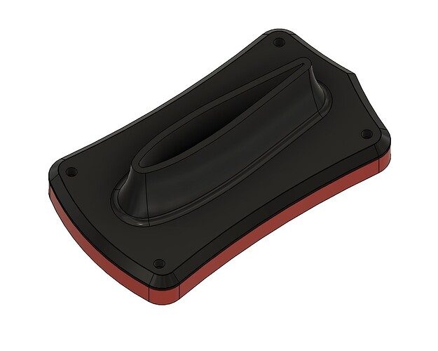

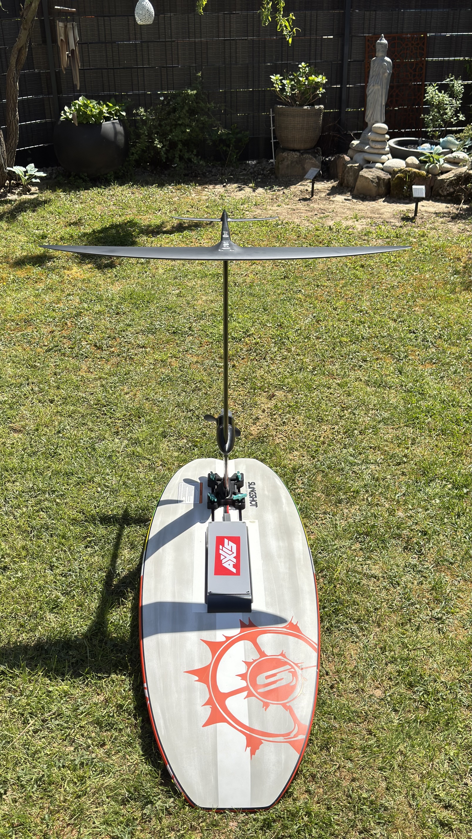

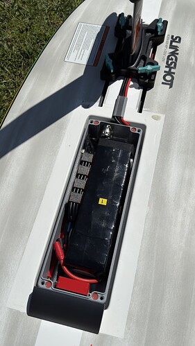

The Bopla Box integration project and the ESC switch to VESC are complete.
I’ve configured VESC over the last few days and everything is working so far.
Next, I’ll put it in my sister’s pool to test everything under load.
Then, in four weeks, I’m off to Sardinia.:man_surfing:
