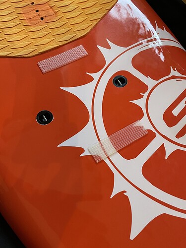

Since I also use my Slingshot board for kiting, I came up with a way to attach the box that doesn’t get in the way with the attachment points when kiting.
For this purpose I installed leash plugs in the board. The battery box is fixed with 3M Velcro tape and then additionally with a rubber band.
I replaced the XT150 connectors on the battery and controller with AS150.
well done ! don’t forget to get a GF sheet on top of your attachement although there is no force.
