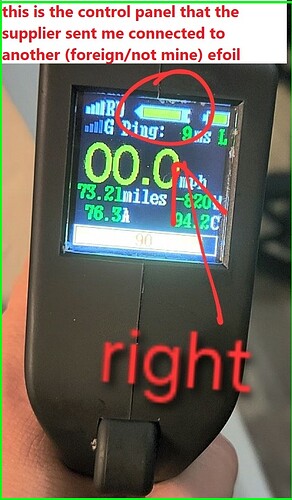

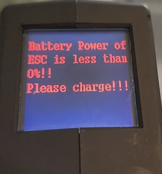

  1. Even when it was still working, the remote showed this error:
    This error is accompanied by a beep and controller vibration, and it repeats every few minutes (2–4 minutes).

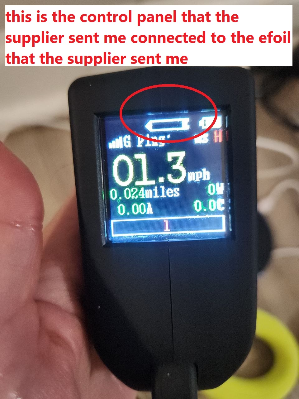

  2. The remote didn’t show the charge level of the main battery (the one inside the board, not the remote’s battery):
But it still worked! Exactly twice, for 20 minutes each.
Now it doesn’t move at all.
  1. Sometimes, while riding, the battery level indicator would suddenly start working — but not always:

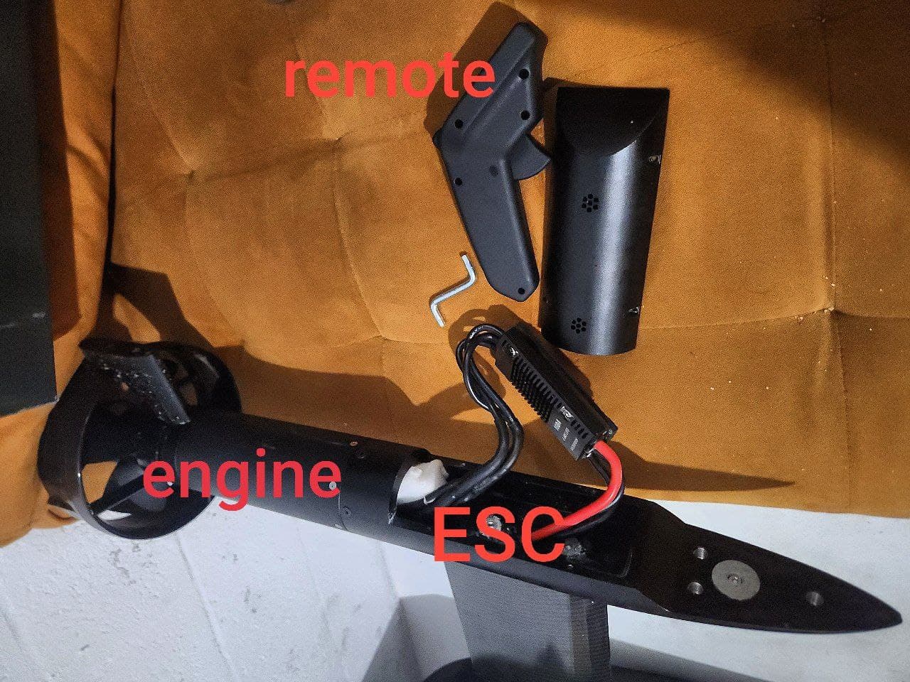

Since it became clear that no one’s going to honor the warranty, I started taking it apart myself:

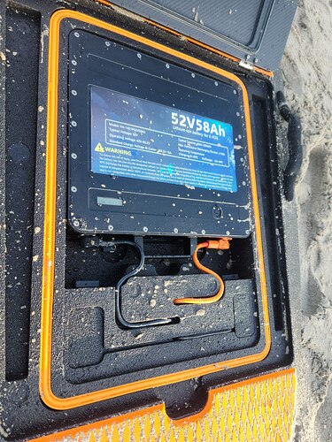

I disassembled the entire board and unscrewed everything I could — found nothing inside except the battery:
Then I opened up the wing, and found two components: the motor and the ESC.

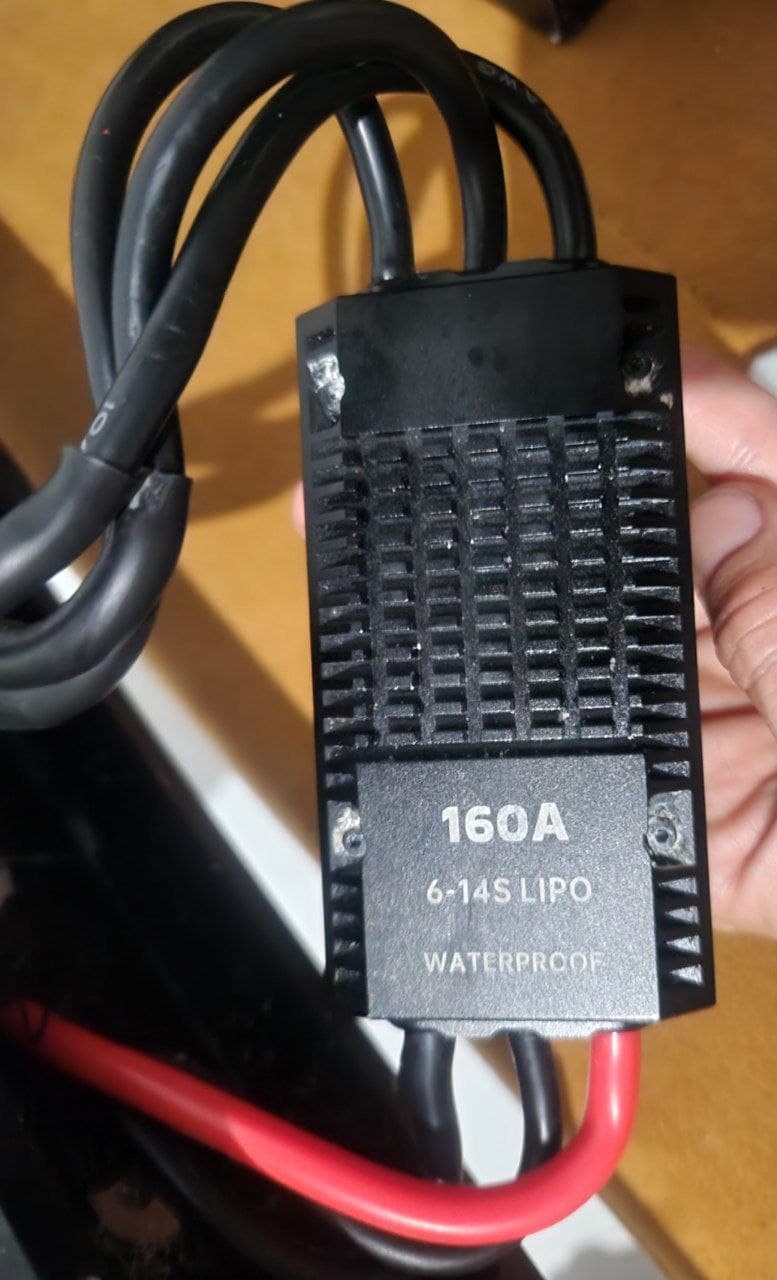

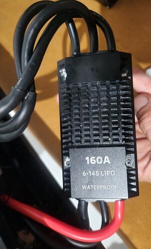

this is esc:
(no make, no model, nothing. no elements can be unscrewed)
Honestly — the ESC smells a bit strange, like something burnt… But anyway — how can I test which part is broken: the motor or the ESC?
I need to make a decision and fix this already.
I didn’t find any exposed wires to test with a multimeter… Do I have to cut them? Is there no other way to check?

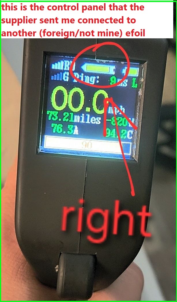

In the video the remote shows a ping value that is good meaning it is connected to the esc. But RP means ppm not uart. The voltage display in ppm mode only works if its wired in a certain way.
I would take it home and clean all that sand out of the seal as you dont want a leak!
Then with a voltmeter measure the battery voltage. Need too start at the beginning.
thanks for the advice. i took a multimeter and measured the voltage on the battery. everything is fine there. i cleaned out the sand.

SInce we have no clue about the esc not much troubleshooting we can there. The remote looks like a standard flipsky vx3 and I think its working.

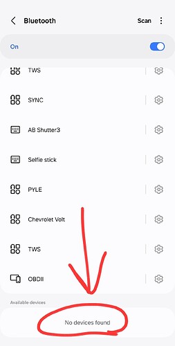

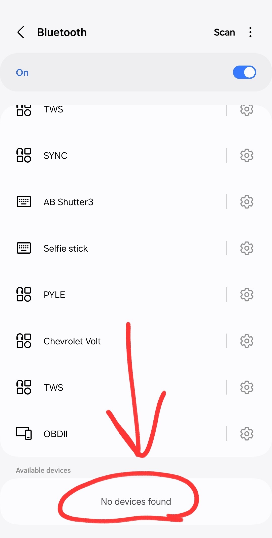

WIth a phone does a bluetooth device appear from the esc?
On a flipsky remote there are 2 options for throttle.
PPM display RP
UART display RU

on what phone? it’s a regular remote control, the same as FLIPSKY, yes, and I bought it as a replacement, I thought it would work with it. and what does the phone have to do with it? what needs to be connected to the phone? how? turn on bluetooth on the phone and then look for what? ESC? or remote?
The esc can be programmed either by a usb cable or a BT connection to a phone running roper software.
Depends on the esc. You really need to get the supplier to help or send it back.
sorry proper software. flipsky esc are called vesc and use vesctool

esc i think is either partially dead or programming lost. Probably dead as it looks too small and no good cooling.
Most likely the Electronic Speed Controller (ESC) is gone. The smell and the on and off battery voltage indicate this.
Chances are that it’s an off the shelf speed controller and can be replaced. Try do a reverse image search for it. Will need to be able to solder etc to do this. See if the company you bought it from can send you a new speed controller and receiver pre wired, this will make it simpler.

Just a few things regarding your problems. If it has Bluetooth, it won’t appear as a Bluetooth device for connection. An app is required to find it. VESC Tool can do that, or the manufacturer has their own app.
The easiest way to fix this is to replace the electronics yourself, which is the ESC, remote transmitter and Bluetooth unit. That way you can set it up and access everything to find any problems.

Motors don’t usually fail after a couple of sessions.
Since you are sometimes getting telemetry data (battery voltage) points to the speed controller. A drop of water inside would cause the issues you are having.
Both maytech and freerchobby sell this speed controller.
