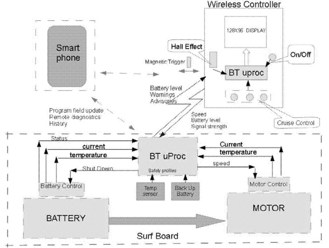

For me, like a mobile phone, the link is bidirectional, that is board AND remote can transmit AND receive. So we have an uplink (board to remote) and a downlink (remote to board) traffic.
Whereas the remote transmits the essential information (trigger position or governor level (pwm=speed), radio beacon to let the board decide when motor should be switched off = remote to board distance is too far),
the board is also an important transmitter as it transmits:
1- board battery level to display on the remote
2- different warnings: battery/motor heat excess, board battery level under x% capacity, reduced motor power, tbd …
3- advisories: “please go back to starting point” (?)
