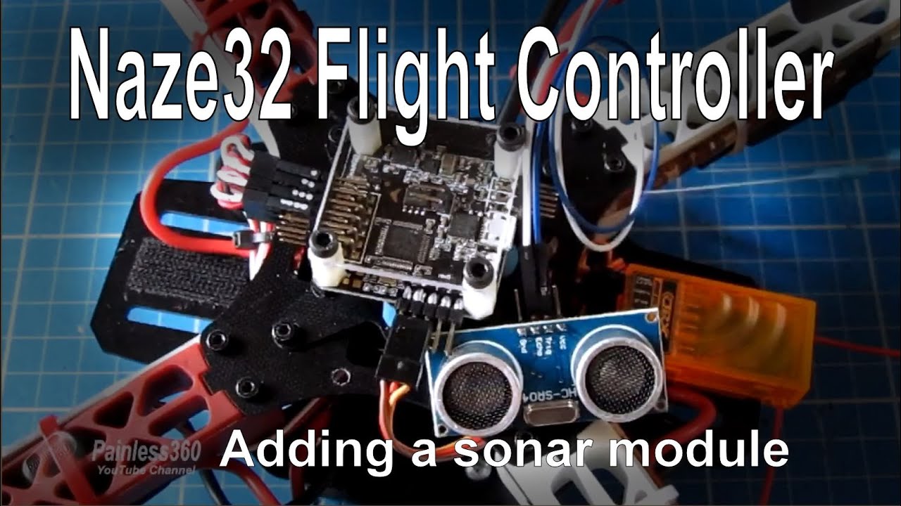

For the ultrasound, many of the FCBs (flight control boards) for quads/drones have these built in and integrated to the controls…along with gyros and accelerometers. With a bit of firmeware modification to one of these boards and you have your efoil height control system.
Ulstrasound module for less than $1
