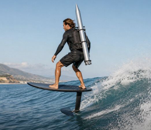

Don’t be afraid to think outside the box–literally. I had a hard time finding a comfortable box that fit my battery. And they usually have a lot of sealing surface just waiting to leak. This system has been working great for me. Rocket Man. :slight_smile:

Awesome! i need more pictures!!
Hi, what is the weight of the belt ? Thanks
Do you have more pics of your build somewhere, Foilfun? I don’t want to hijack Jezza’s thread :slight_smile:
Where can I check them out? Would love to have them on my boogie
I guess I should consider posting a build thread. But I just built it without taking pictures of the process. I didn’t intend to derail this thread. I just went through different boxes before landing on a tube, so I thought I would toss it out there. I’ve never seen a tube foil assist anywhere.
