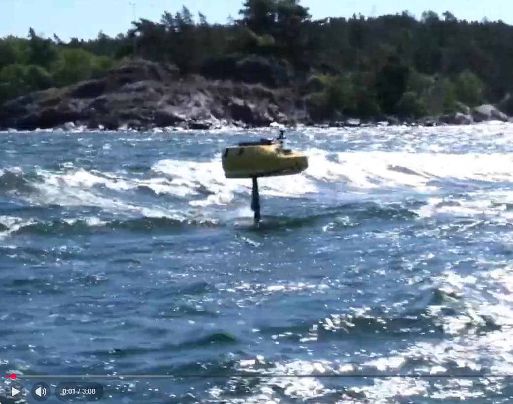

Clearly not open to different design and it aināt new @Jan12 if you havenāt got anything positive or actually factul to add just wheesht! You go watch any beginners whats there main problem nose diving. Take the shape compare to majority offshore boats its pretty identical and if they canāt plain that would be strange lol. The aim of the board is to maintain speed in ruff conditions https://youtu.be/qQzdAsjWGPg

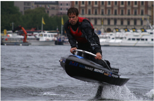

17 years ago a group of students built what you are proposing:
It was unstable and rode like SH1T. But the overall concept was very clever and then a company called Lift bought the patents. Then they redesigned the boards in an intelligent manner and it was their first video that sparked various peoples imagination and collaboration and eventually this forum was born where we are today.

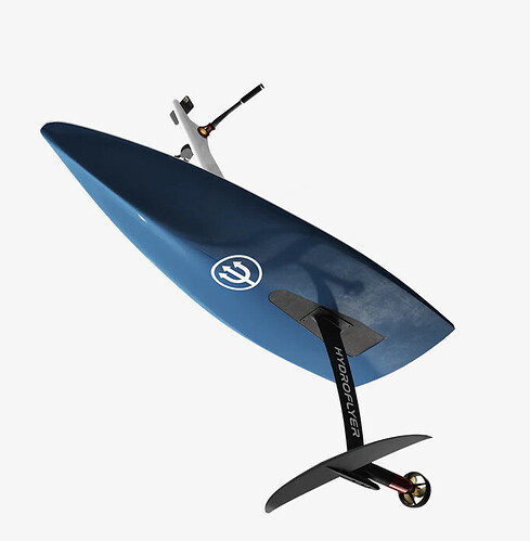

The very same company that design the unstable V shape now designs autonomous versions and guess what bottoms they haveā¦flat
This is pretty simple, flat releases better and faster off the water surface and is 1000x easier to recover nosedives with because it doesnāt pierce water like a V.

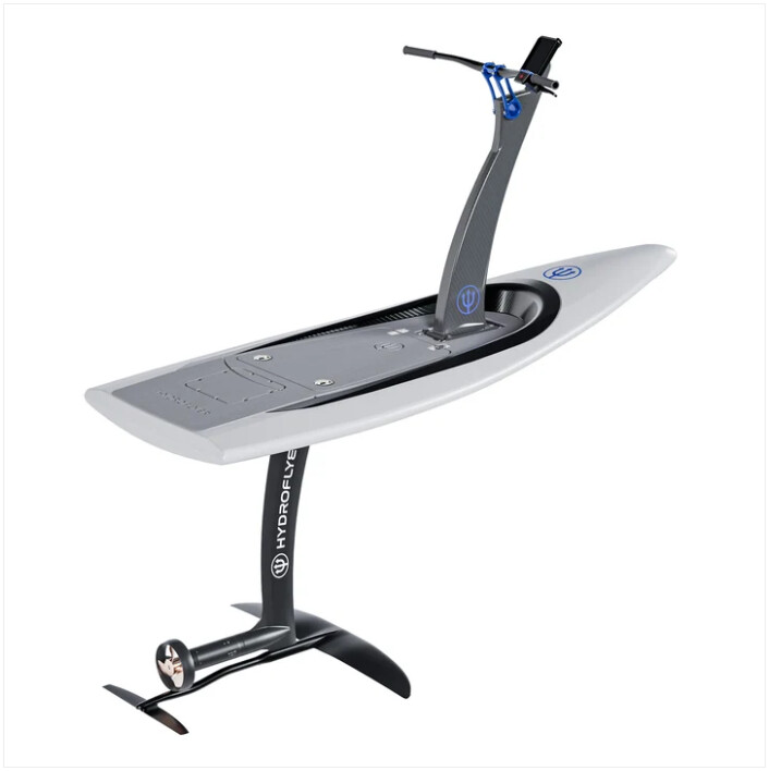

Now onto the only modern design that kind of meets the path you are going down. You get the Hydroflyer (I completely forgot about it because I had a friend try it and he told me he was bored after 5 mins). But this is big and requires scooter-like handlebars. Its so heavy you need a trolley to carry it, but maybe that suits you and what you are after. It has a bit of a V in the front and is flat at the back:

In all honesty though, if you have a bad back and knee injuries, then build a copy of the hydroflyer as the handlebars will be a massive help to you.
