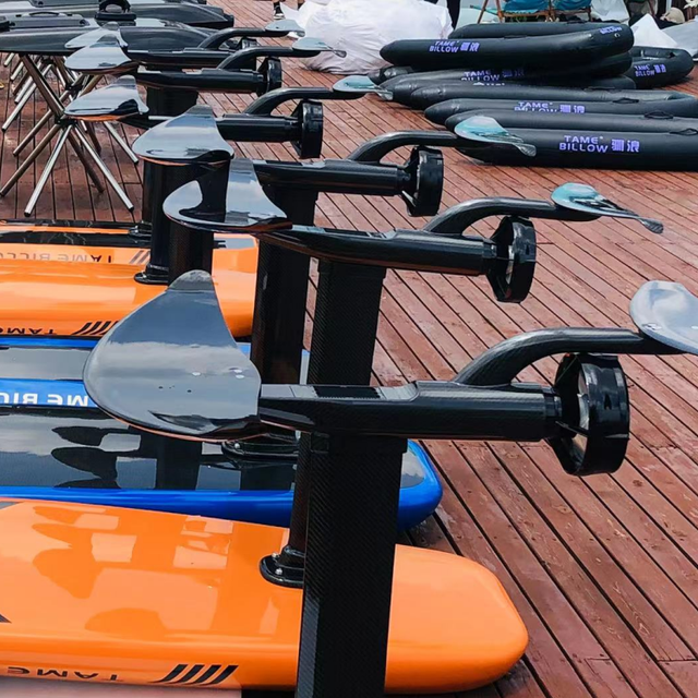

Thinking about the mountng I like idea of making a custom Fuselage which the motors mount either side and the stab is relocated deeper in the water to avoid disturbed water. Another option could be to have one motor in the normal location and create a dagger board under the mast for the second motor this would stop the pull to oneside if a motor stops. whats your guys thoughts on this go big or go home idea😆https://s.alicdn.com/@sc04/kf/Hc9c3dca2d9c448a8893ac7cde642475fT.jpg_640x640.jpg

I would however keep complexity low
I only recommended 2nd VESC because it adds almost 0 complexity
Adding a 2nd motor will add complexity in choice, mounting, cable routing,…
While I definitely see the appeal, it may be overkill for the first prototype?
Having the motor break completely is unlikely, you may break a bearing but can limp home with that… a broken VESC won’t limp :smiley:
Breaking a propeller is also likely, so take a spare of that for the singular motor.
For your weight/setup you should use 65161 or bigger, to ride on it as a single motor imo. It is quite efficient too, just long and heavy.
That’s possible with multiple simple ways to choose
Not at all Sir. I am glad you got me thinking about it most of mad things I have done in my life always have a Plan A, Plan B and Plan C. Only on very few occasions have I made it to C tho. The original plan (A) if the system goes down its swim ashore or pan pan its straight to plan C. Twin motor gives me Plan B without having to be dependent on others. If the remote is just giving signals I really shouldn’t need to do anything just limp home. Multiple times members have brought up mast flex and looking at builds people are chopping there masts to make room for the motor weakening the structural strength of the mast. Taking a Fuselage and Tig welding some Alu pipe vertically and half pipe mounts for motors seems more logical to me. I also plotted the trip I want to be able to accomplish round Cape St. Vincent and its 26 nautical miles total and catching it with right tide I am thinking could be possible on a twin 2kwh system. So let me know your folks thoughts.

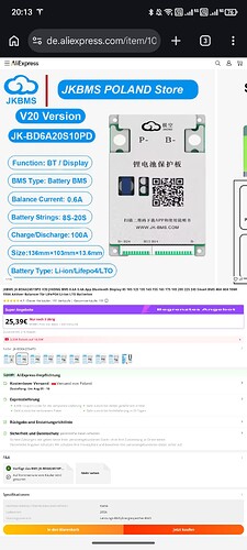

@ludwig_bre is this the bms you where recommending?
https://amzn.eu/d/07Sdblhp
How high is the motor normally placed above the front wing the diameter of the prop is 153mm?

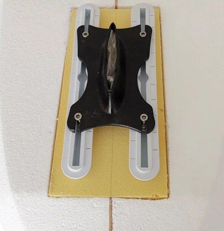

How is everyone dealing with foil mounting having fish bones for foil adjustment would be nice but then how do you deal with cable slack if I have used epoxy to seal the cables to board?
This is where I will conduct my sea trials perfect inland lagoon for it only 6 km from home 2
Definitely not recommending any of the BMS haha :smiley:
This is the one I have
https://de.aliexpress.com/item/1005012471464165.html
But again, would not trust it with my life
I place it as low as possible, maybe 5 to 10mm gap to the fuselage
My motor cables are sealed with silicone on the top of the mast towards the mounting plate
No slack really, just enough to exchange the motor mount adapter
What you mean it don’t come with a 10 year Ludwig guarantee lol
That link ain’t working for me.
I heard someone call them fish bones but I think there actually called rail mounts or box would be nice to have mast adjustment but it creates an issue with cable slack. Didn’t know people still used silicone haha get yourself some sika flex or epoxy for a proper seal.

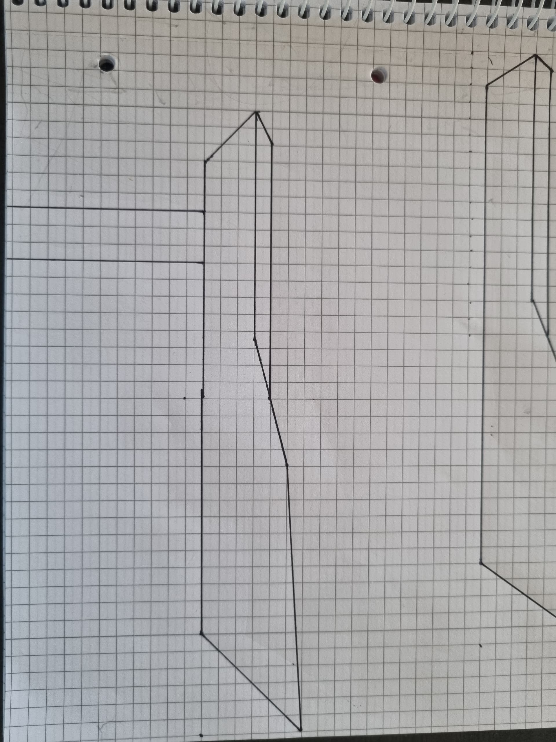

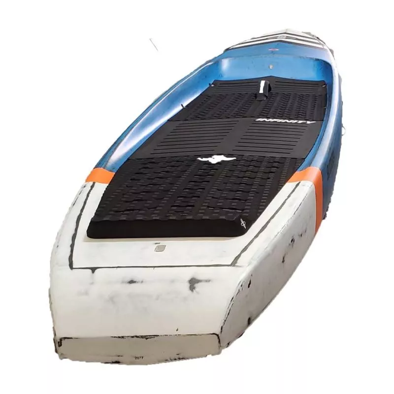

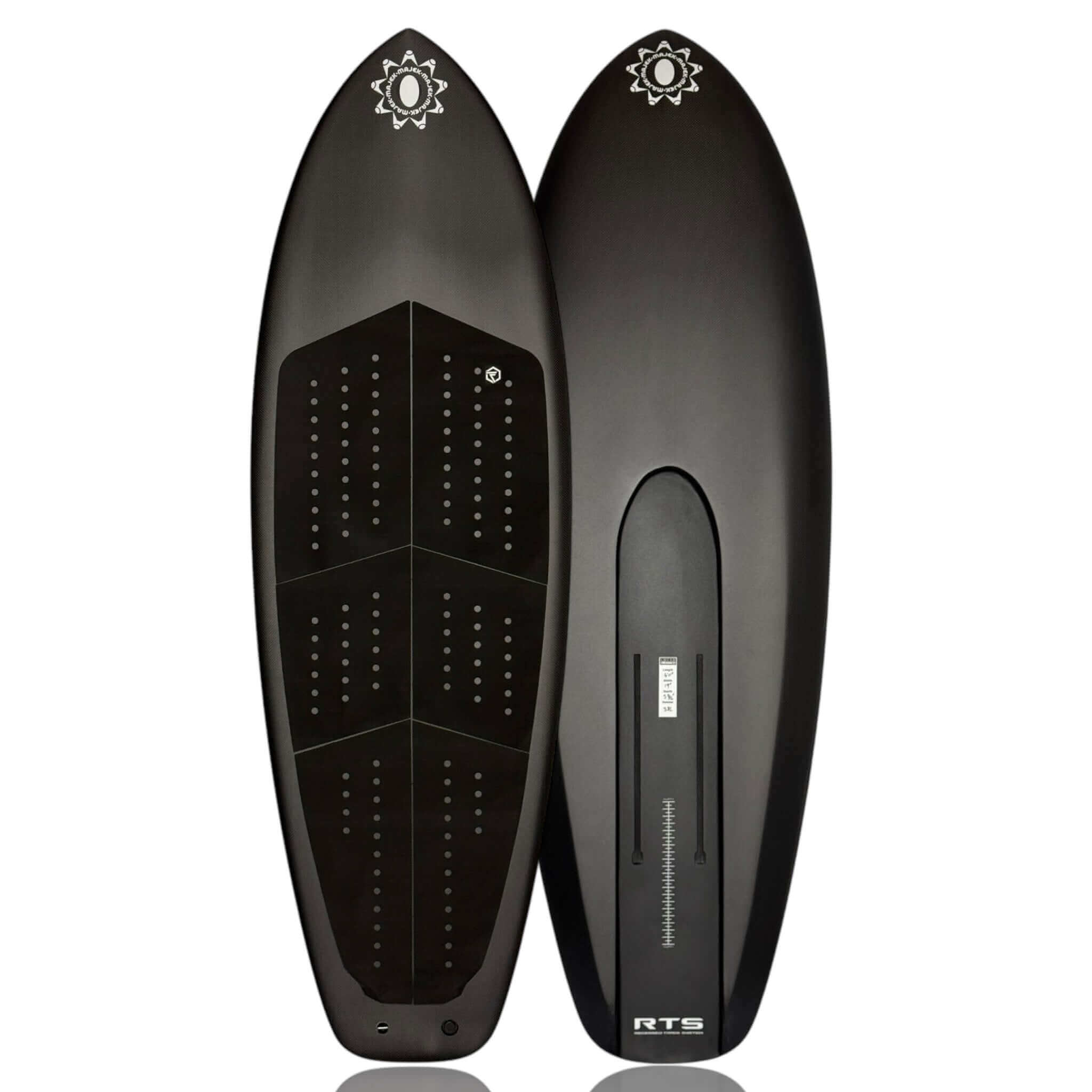

Thanks for your insight. I Agree with keeping it simple theres a reason the Ak47 is the most common gun in the world simplicity and reliability. Currently trying to get some board inspiration and design the shape is there a software anyone recommends? I like the idea of the board having a dugout with a point nose/raised wave breaker nose a flat deck at the stern and a gunwale. Some images I like and yes I understand some are paddle boards and are far too long I am purely look at shape

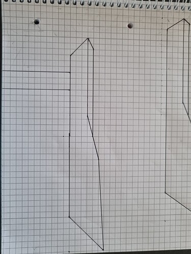

Its no cad drawing but it works. Getting pretty close with side profile I want. The board will have double thickness on the flared nose and a small gunwale on the deck with an open stern considering placing one battery pack behind the mast for better balance.
