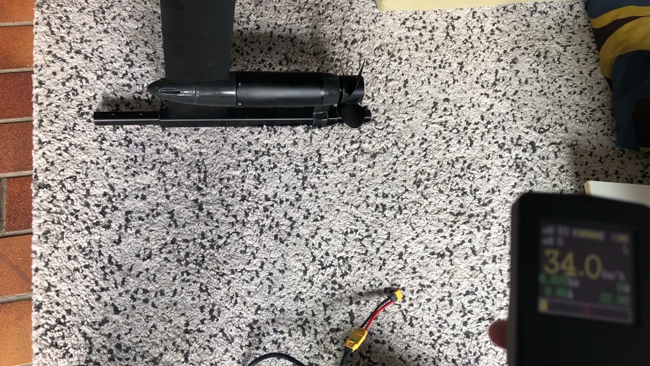

The test Today => Sucess
I tested for 1 hour with no problem.
max temperature of VESC 37 ° C, very happy with the cooling without pump.
I installed a new antenna on the nose, under the pad, for a better reception
Because with this small board, there is too many water on the center of the bord when I start
I am a little disappointed with the FR prop, it is more powerful but consumes more
: mini 23A, and it’s too loud for me.
I’ll try again tomorrow, with less wind
