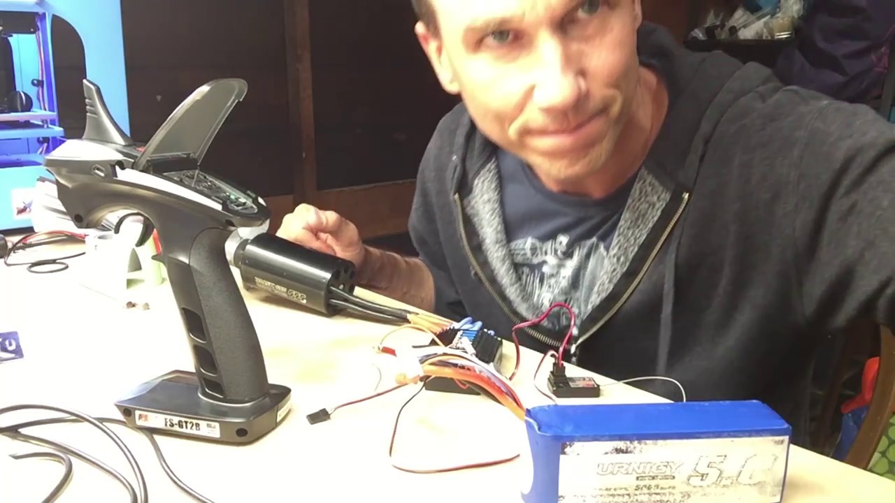

-this is the video I was referring to. He uses 1 battery and achieves a lot of power.

Ubec has to be for 12s , calibration 100% on the remote thorttle on start with the esc ( pairing) and 100% power selected on the esc parameter ( with card or software ) ?
