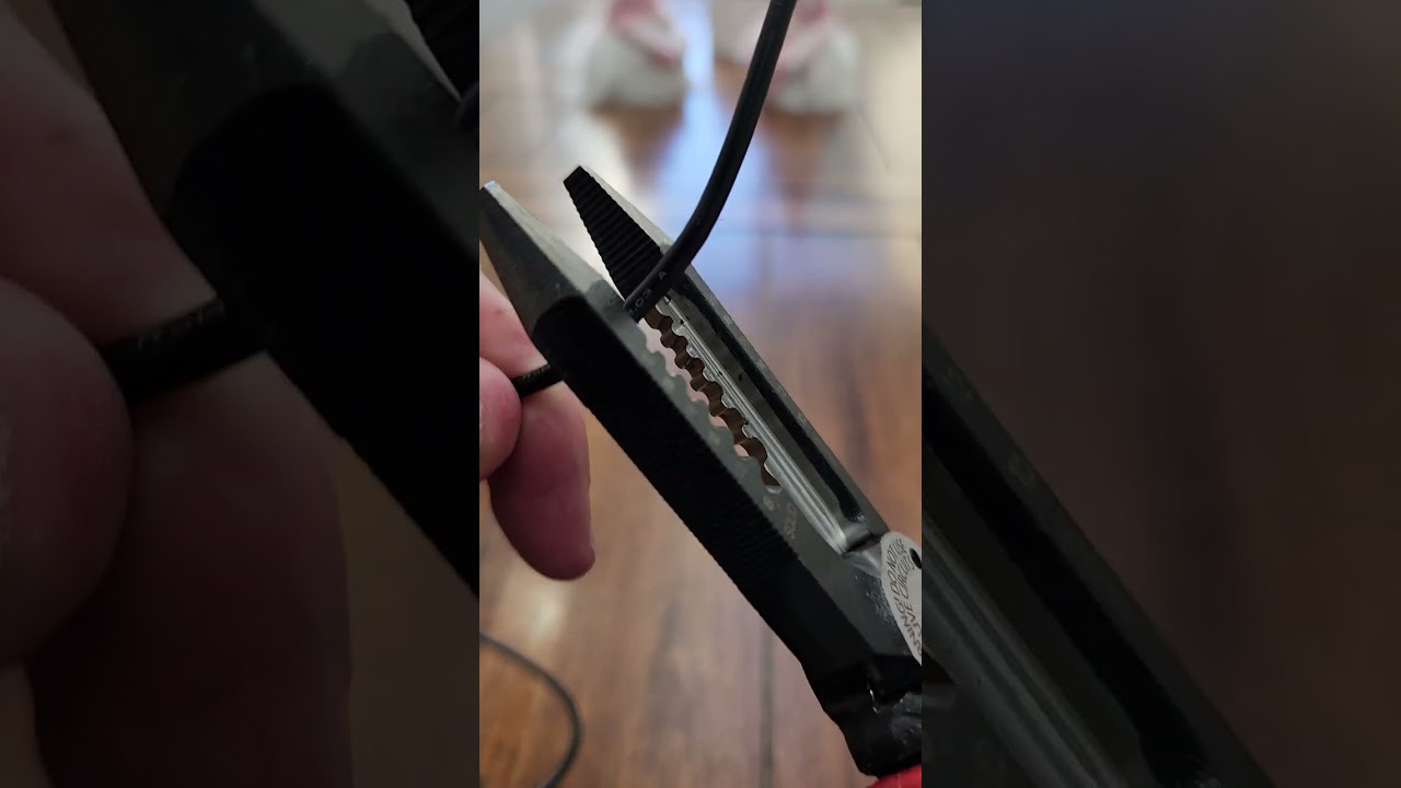

I also got a 2.4ghz antenna, chopped the connector and exposed 31.8mm out.
Went back out yesterday night and the session was a success! Started with the external antenna touching the window and routed to the front. Signal was perfect and very strong, not a single cut.
After a while, removed the antenna and relied only on the signal going through the nose window, to the tracks to the plastic on top of the case. Signal was still good but weaker, I had to make sure I pop up quickly but once foiling and out of water was great!!
Good job, any more details about your external antenna setup?
Sure!
I copied this setup from YouTube
And bought this antenna from Amazon
I guess the most important thing is to ensure there’s no water in between the two antennas as salt water attenuates the signal pretty quickly.
I used some sealing gum (used in composites) to avoid water in between.
