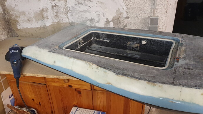

i bought it from someone. Now I need to make some changes to it. I need to relaminate and make a change to the mast connection.

Update:
Rebuilding the complete board. Ripped all components out and stated sanding. Unfortunately the paint is so viscous it always cloggs my sandpaper which makes it very annoying to sand.
Also stay tuned for my new waterproof remote v2 which is currently in a complete rework process. Custom pcb etc
If you had a heat gun (Heißluftpistole), that would help with paint stripping process.
Tried, didn’t help at all. Just made bubbles and the couldn’t be removed. But thanks for the tip
What brand of paint will u use to repaint the board. I was just looking at 2k PU acryl on www.lackmix.de it seems a high quality paint at affordable prices.
Funny that I didn’t recove any notification at all. I use hp textiles epoxy and some carbon fiber. Will work on it after Christmas. Thanks. Am very busy with my remote design right now

So far I had to get my efoil done. I had to take my development a bit back for laminating and sanding my board. Fortunately I’m finished now. Some small things like the silicone on the sides need to be adjusted, but the main thing is the remote. I’m so happy how it turned out and how well it works. Unfortunately the waterproof 75200 has an production issue and needs to be sent back. I went back to my flier esc.

The board looks really professional now. Before it was a real mess. Well done
