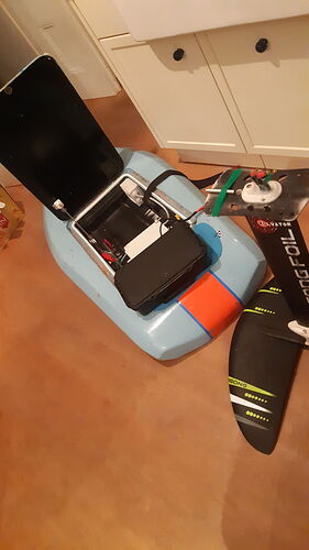

Now I’m nearly finished with my build I programmed the flier esc made the box waterproof and did solder the cables (just need to solder them to the motor) btw I will go foiling on Saturday.

Ok Quick summary WHAT happend:
I DID IT I FLEW OVER THE WATER!!!
WHAT HAPPENED:
first tried the 3d printed prop (100amps low speed)
Then tried a aluminium prop(lift off and at 60amps gliding)
Then tube came off of the watercooling and in pumped WATER inside . Display went off and then I new WATER was inside.
Flier esc…Ok
Pump…Ok
Batteries… Not sure yet but looks ok
Display with ampmeasure thing… had black screen so I think it’s damaged.
Motor… Ok
Reciver…Ok
Overall: I’m very happy that I did it and my feeling of the lift off was insane, now I need to test and fix everything and then next year summer will be fun.
Thanks guys for helping me that far and guiding me. Just ask me if you have any questions left.
