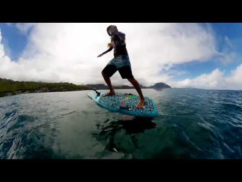

Hi.
I took the SUP e-foil out for it’s first test ride.
After a 1h30min session the compartment was completely dry! The small droplets of water seen splashed in when I opened the lid, I’m pretty sure about that.
I now officially have two efoil boards. ![]()
You need to lick that camera lense so that the water doesn’t stay on it.
Hahahaha…yea. I was doing that. These 360 cameras are very finicky about water messing up the magic.
I was quite distracted with the new board, so the camera wasn’t getting the same level of attention. I apologise for the poor quality.
