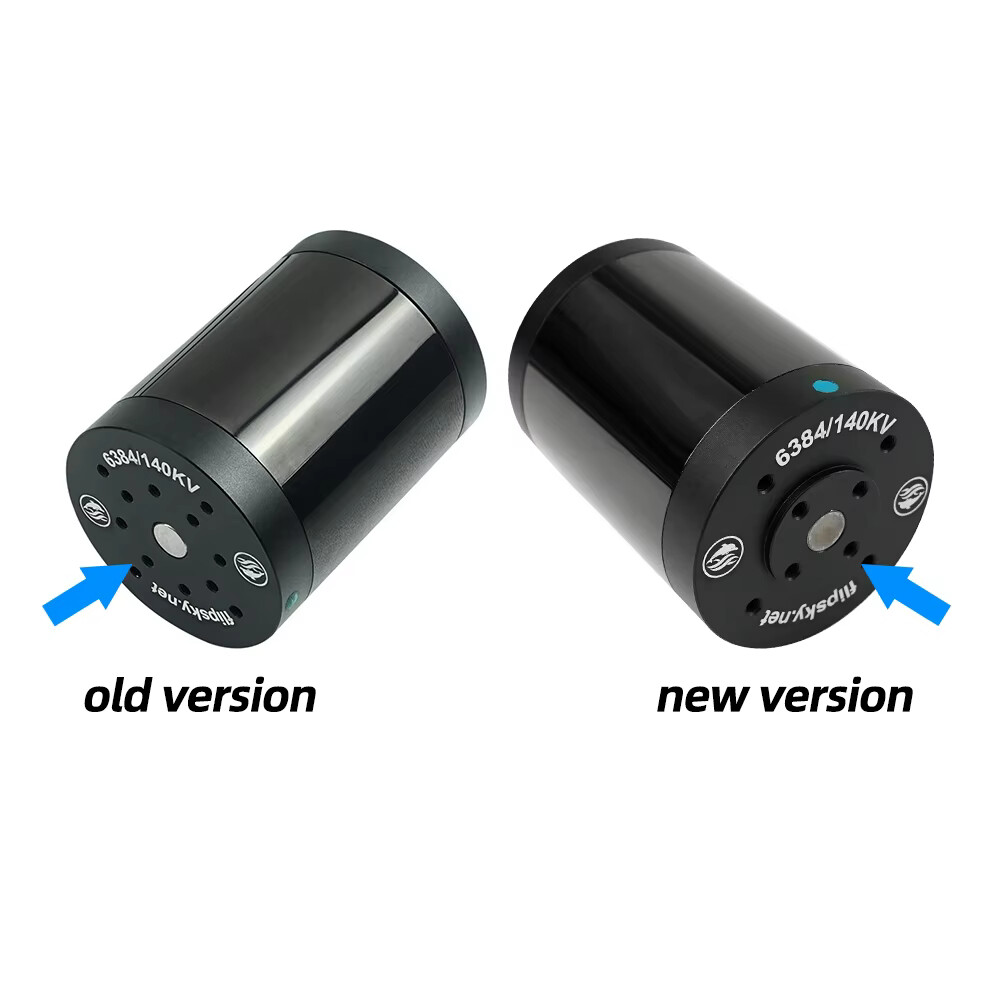

6384 seems to have disappeared from Flipsky’s website for now…?
Could anyone tell me about this new/old version, is it just about the external casing?

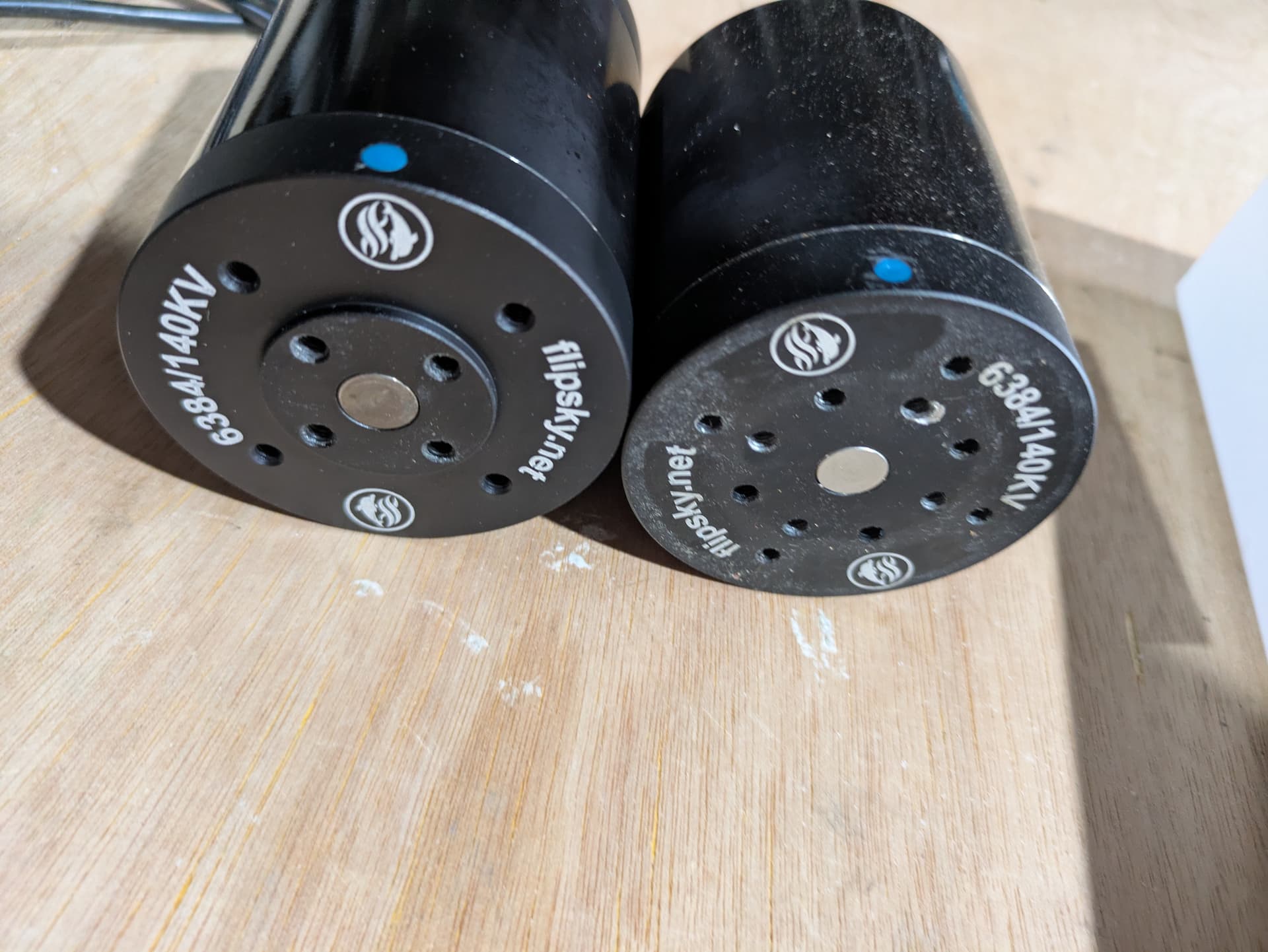

I ordered two motors for tow boogie, and both versions arrived. I had to redesign and print a new hub. Situations like this are incredibly annoying
I ordered on different dates and now have this problem :disappointed:
