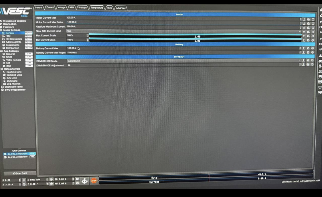

With 65220 they advise me as configuration of the attached photo:
110
-50
230
False (abs)
In your opinion is it ok with a 13s 10p 21700 tenpower 40XG 45A, 40ah.
Is correct ? @HOF
So with 13S you will have more current than I but i guess thats fine. Your screenshot is not the same as the configuration you want.
I would stick with my settings. Flipsky recommends lower values so I am already pushing it a bit but I still feel it is safe and high performant.
EDIT: Also, slow ABS will have to be enabled - I tried without it but it just cuts so so randomly that its not drivable. Also, do not upgrade the FW.
EDIT 2: During my drives I tested a lot of different propellers and found out that two bladed ones are the best choice for this motor since it is not as strong as the 65161. The reason behind the lack of power is the ESC that we need to limit. What I found out is that with three blades the starts are painful, the motor current goes to the max while with two bladed propellers it is more in sync with the battery current, also feels better. At the end, with my settings, I reached peak 4,2kW.
Very kind! Yes the screenshot is the default one I set this:
110
-50
230
True (abs) (you notice!)

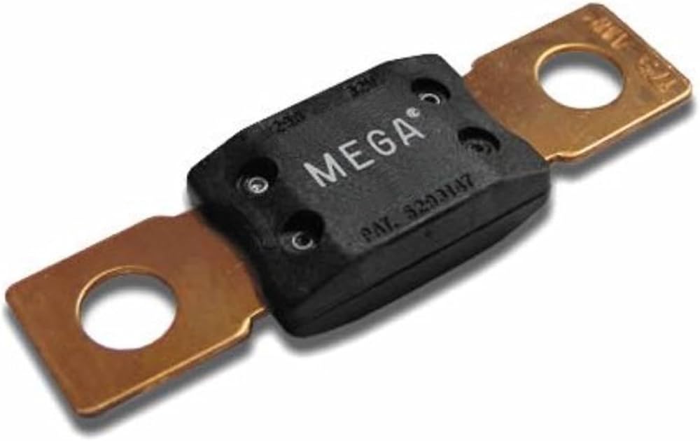

My only concern is could the 200A fuse blow?

Keep it True - do not worry about the warnings on the VESC program - thats how some flipskys esc work :smiley:
200A fuse, where? If its on the battery then dont worry, you will never reach this current, not even close. Also most of fuses this big are slow to pop.

Yes, I installed a 200A Mega fuse right before the QS8 anti-spark connector; I’m spending so much time on this—I have a million doubts!
