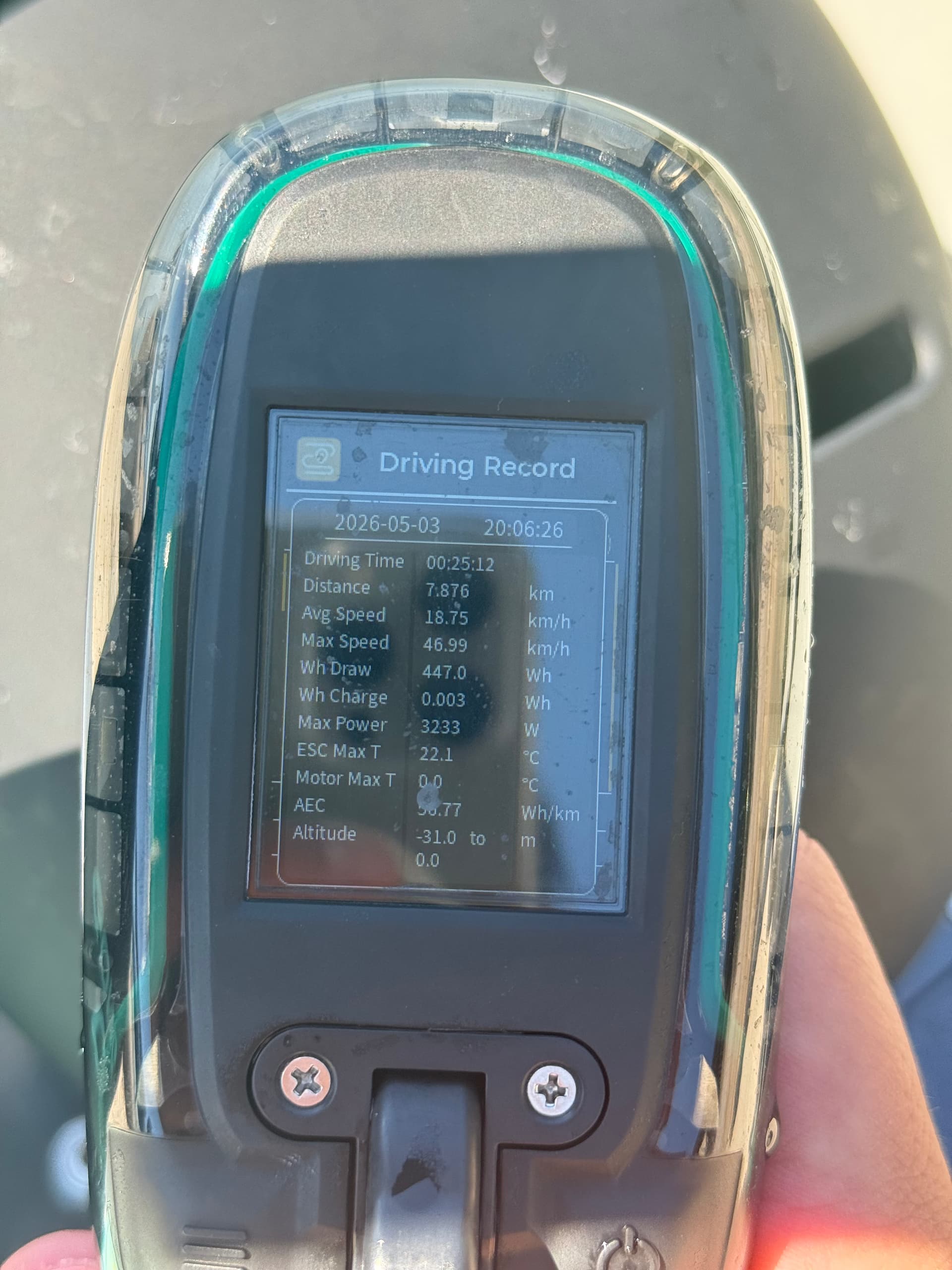

Another two batteries drained and the combo is holding up well. Seems like it is also very efficient and capable of staying at 120A Motor max and 160A absolute max.
The picture is taken mid drive after driving on low end of throttle to test the efficiency. The speed is incorrect.
Woah, 47 kmh at 3300W, thats very impressive. Was this with the Curve XL? Impressive. I also saw you doing almost 50kmh some posts back in this thread? That is very fast on 14S. What kind of prop are you using?
Nono, the speed is incorrect on VX5. I used Strava and it says 38kmh but i was not pushing it. …im using Curve xxl.
Woah. Im surprised your VX5 is off, the GPS should be really accurae. Atleast, from what they claim, and from what I experienced myself. Im using Yours Truly combined with the VX5 and the speed is always matching on both sides, maybe 0.5kmh difference, but 10kmh is defintely a massive difference. Any idea why there is such a big difference?
No really, but you got me thinking why is that yes. Ill write to Flipsky.
