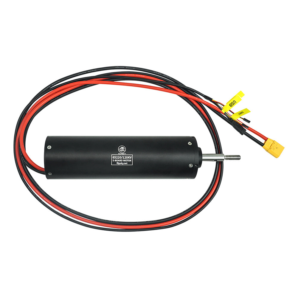

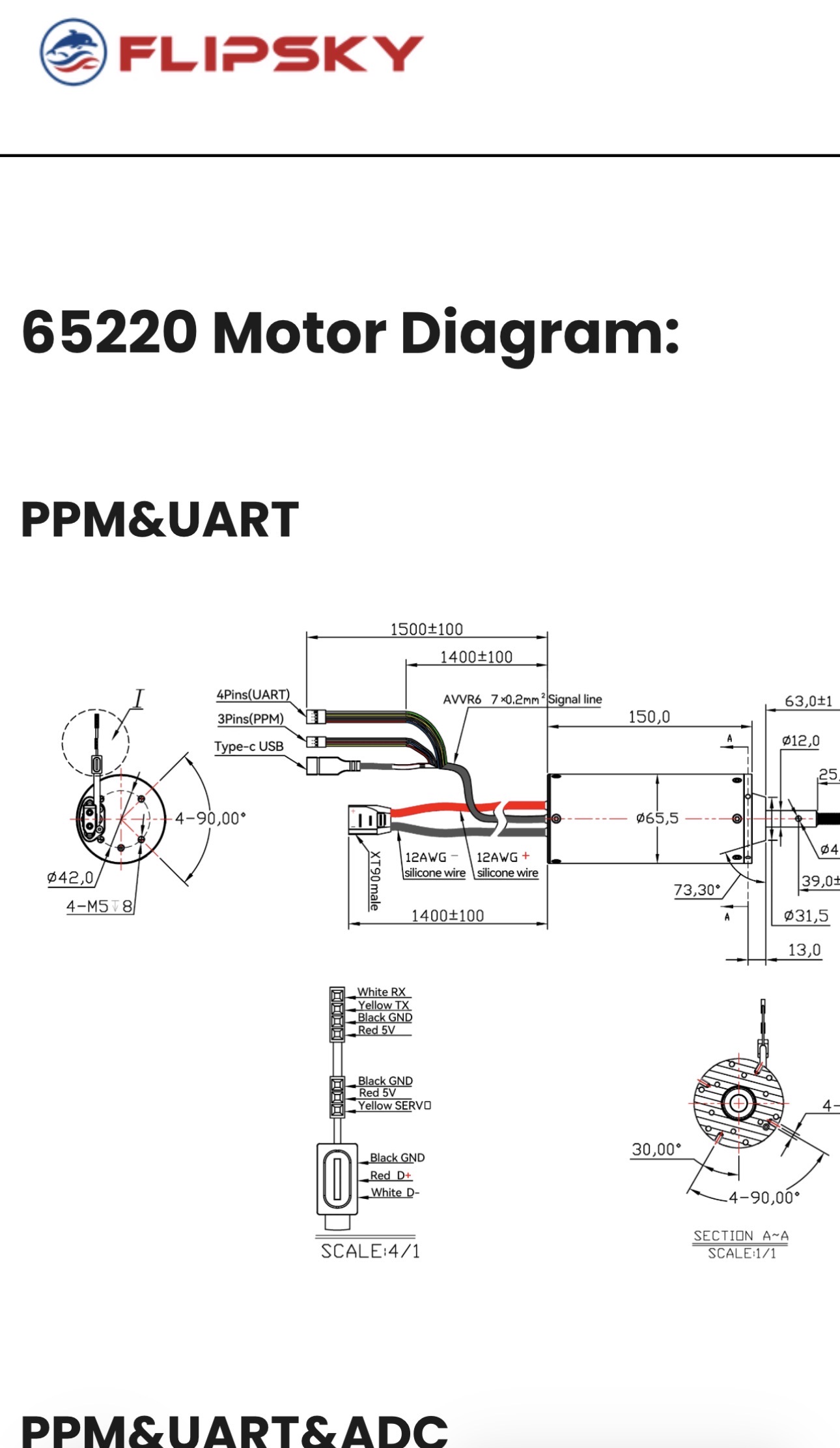

From Flipskys website it looks like the UART connector runs from the motor.

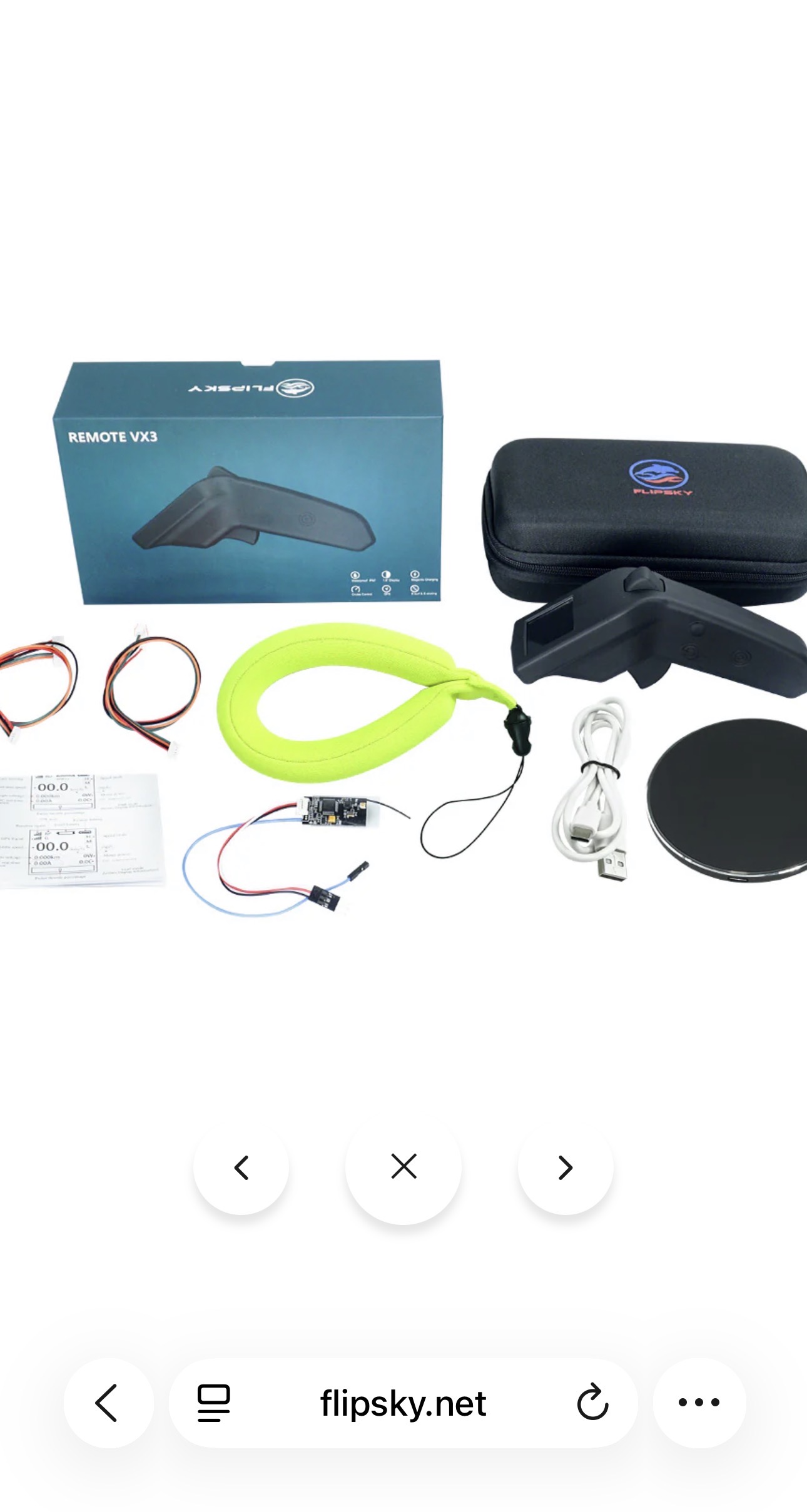

The VX3 package has always included a UART cable like in the photo. Just have to use the correct pinout cable ie RX - TX. Of course you have to use VescTools to configure VESC and set the VX3 for same.

The remote dcome with a 4 pin UART cable. Is there another way to connect th UART? The motor has the UART well labeled
Exactly, i tried using the PPM connection 3 pin and ran the VESC tool. The motor connected perfectly but the remote using the VESC tool doenst want to connect. So am trying to figure out how to connect with the UART

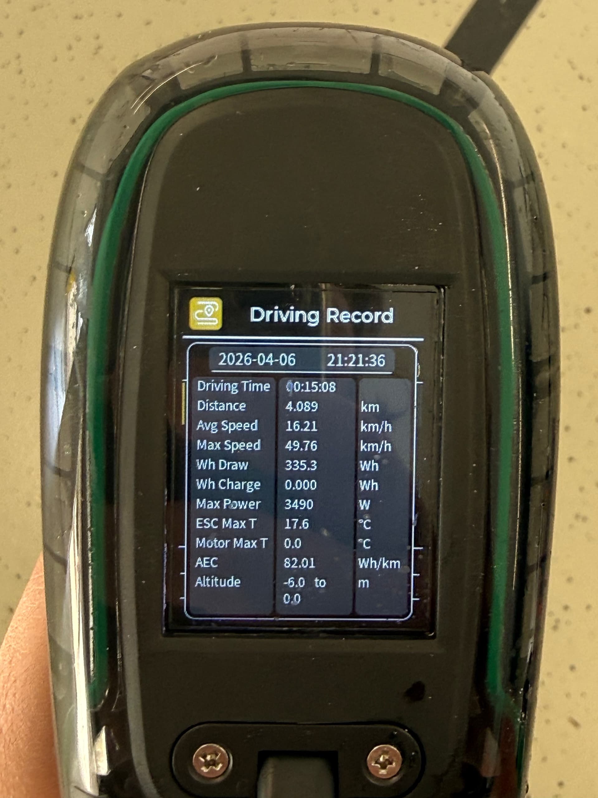

Therefore i reached 3490W max ( at 58v = 14s5p) on a custom 2 blade 3d printed propeller.
The temperatures were surprisingly fine, actually just 3 degrees warmer than the sea water temperature. Sea was at 14 degrees and mosfet max at 17,6.
Tomorrow I will push for 120A and 160A absolute max.
max speed must be off although i was flying around 40kmh
