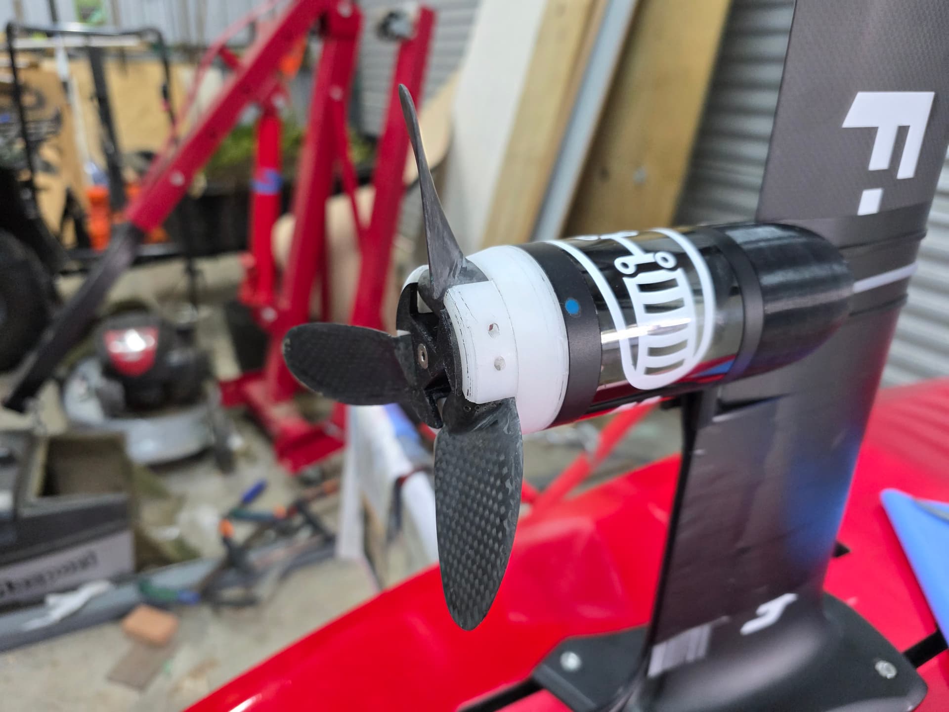

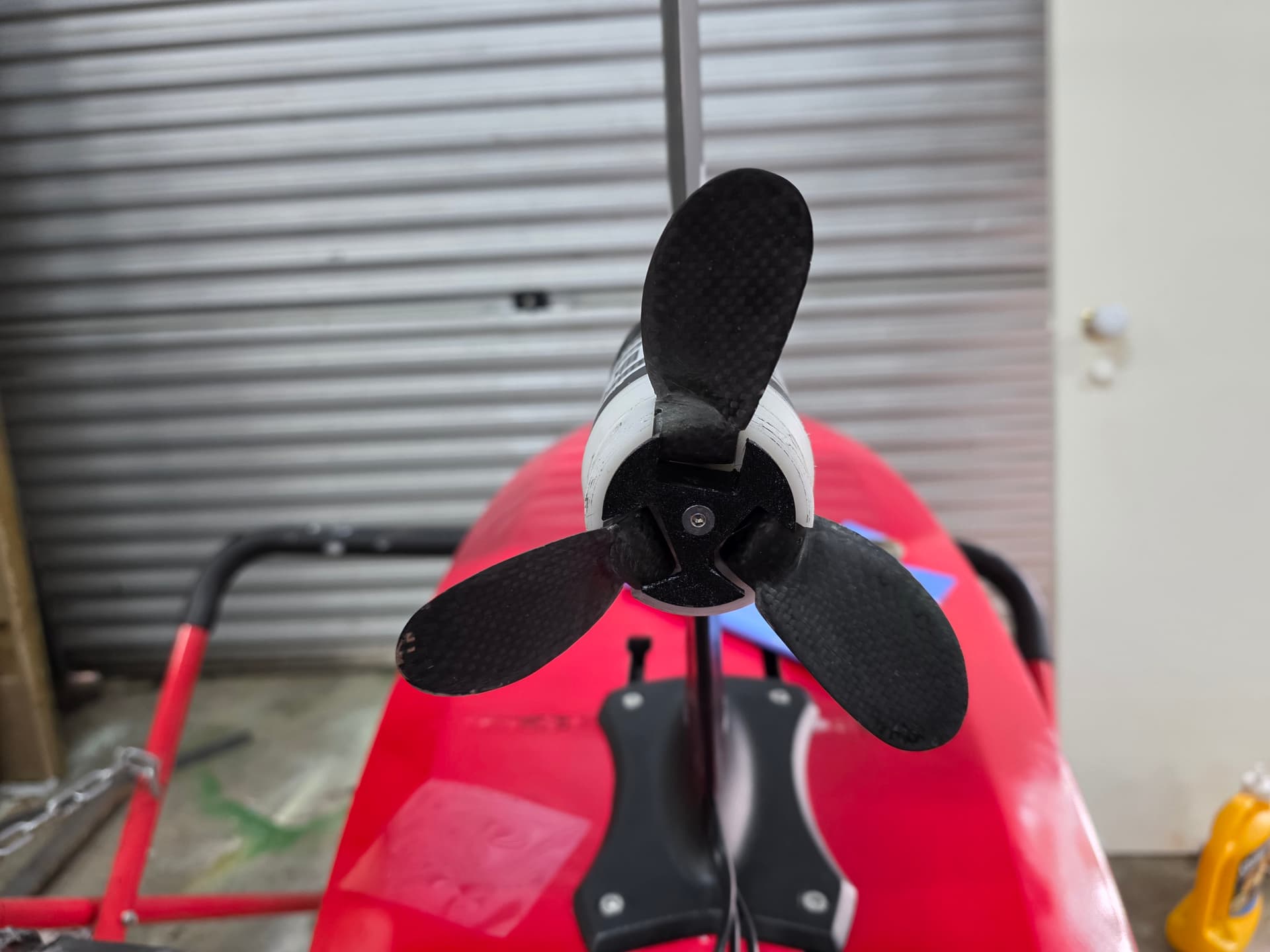

Hi I have built my own 3 bladed prop as the foil drive ones are expensive. The props were 3d printed then silicone molds made from the prints and then carbon fibre props made. They are very strong and light and didn’t need much to balance them. The hub was machined out of acetel / nylon.
Please share any files you have :grin:
Wow, that’s some beautiful work :clap:t3:
