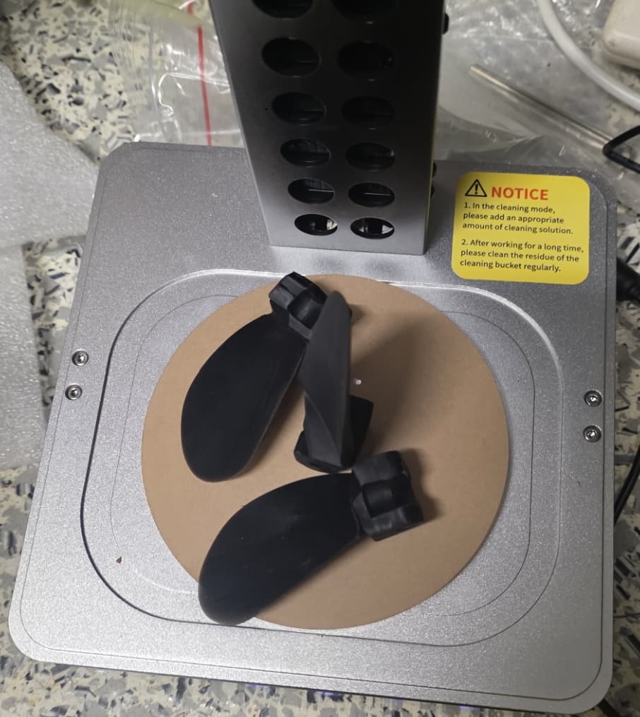

Also I have ditched the original aluminium Flipsky 2-blade folding prop as it is too noisy and I have been using a 3D printed 3-blade prop. This works incredibly well - it is much quieter and has more torque and less battery use.
I got the model from here: Propeller for E-foil / ASSIST - Share Project - PCBWay big thanks to @Bzhwindtalker !!
I printed the hub with an FDM printer (Bambulabs P1S) using PETG-CF (6 layers and 50% infill).
And the most amazing discovery is the Siraya Tech Blu resins - I have used the Black Lava - this is incredible - it has a very high tensile strength and tensile modulus - I am sure on par with the Formlabs printers/resins that the FD team use. So I have printed the props in this resin on my very old AnyCubic Photon printer. I haven’t even sanded them - just washed in IPA (5 mins), dried with a paper towel and post cured for 15 mins (in an Elegoo Cure station).
I have printed spares… but not needed them (to be fair I have only used it 3 times).
