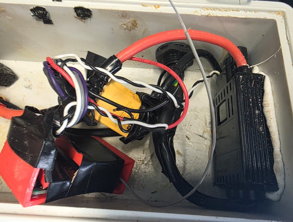

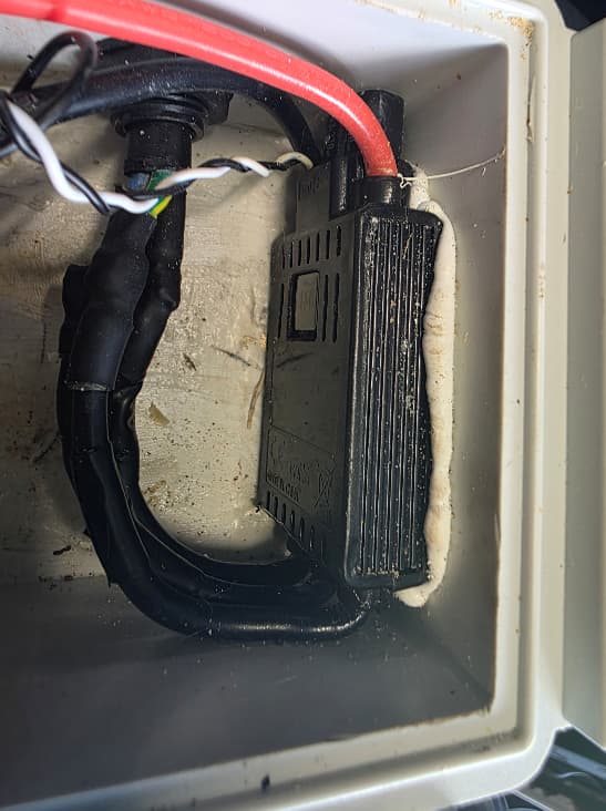

Well done, could you make a closeup picture how you installed the ESC in the Camdenbox?
Hi Luigi
Here’s a photo as requested…

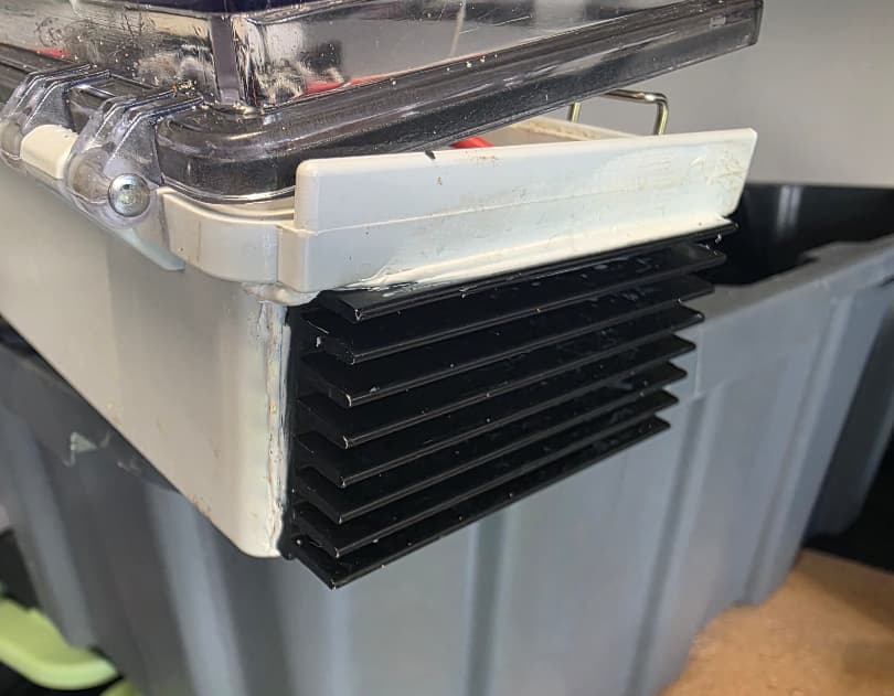

I have used Kafuter K-5204K thermal past to bond the ESC, though the hole in the box, to the large heatsink on the outside (glued on with Fix15). You will also see that I’ve run a bead of Fix15 (white) around the outside of the ESC also - for a bit of insurance to keep it in place.

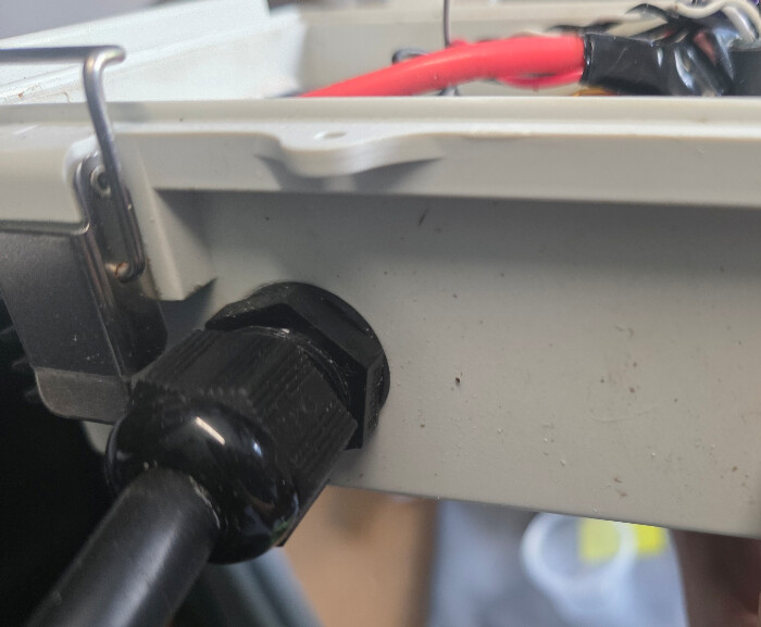

Here’s a few other photos of the general area…
Yes the wiring is a complete mess… this was V1 done in a hurry.
I am now building a V2 which hopefully will look less like a pile of junk - just posted this to show others that if I can get this to work, anyone can :wink:
I still believe that this exact design is probably as simple and quick to build as it can get - flaws an all.
Note also the cable gland… this worked flawlessly… until it didn’t (read above).
