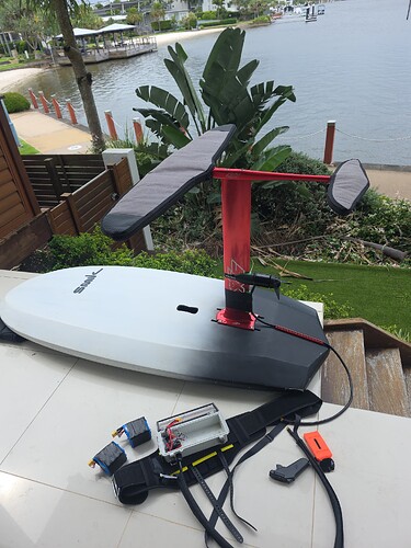

Finally finished my waist belt build. And tested it today. Worked flawlessly. Super happy and frankly couldnt believe how well it worked.
Components:
  • 80A Flycolor/Fly dragon ESC
  • AliExpress BDUAV 6384 120kv motor
  • Maytech remote & RX
  • Flipsky 2 blade folding prop
  • 12S2P battery (2 × 6S2P)
  • BEC
  • Camdenbox waterproof box.
  • flex 3x2.5mm phase cable
  • 3D printed phase cable guides for mast and board
  • velcro cable tidy sleeve for phase cable and leash
  • 25mm webbing leash )
  • cheap weight lifting belt for the harness. Really comfy.

Noce build. I’m also in the process of building a waist belt assist with a Saite6384 and a small vesc. Will be 12S 2P and optional 3P.
I see you ise an 3Pin XT60 to detatch the motor. I wonder where would be the best place for the connector. Either at the end of the board (where it can be fixed), or just at the waist box? I’ve seen both. I lean towards putting it at the end of the board.
Also what cable lenght (from the end of the board to the box) are you using.
Thanks. I dont think it really matters where. But i suspected it to be better closer to the board (just a hunch… no science behind that).
Re phase length, after a few rides mine is a bit too short. Could do with another foot i reckon. I thought the shorter the better but went too short. It is 1200 from box to connector and 1200 to the motor.
My phase cable is quite thick 10mm outer sheath .

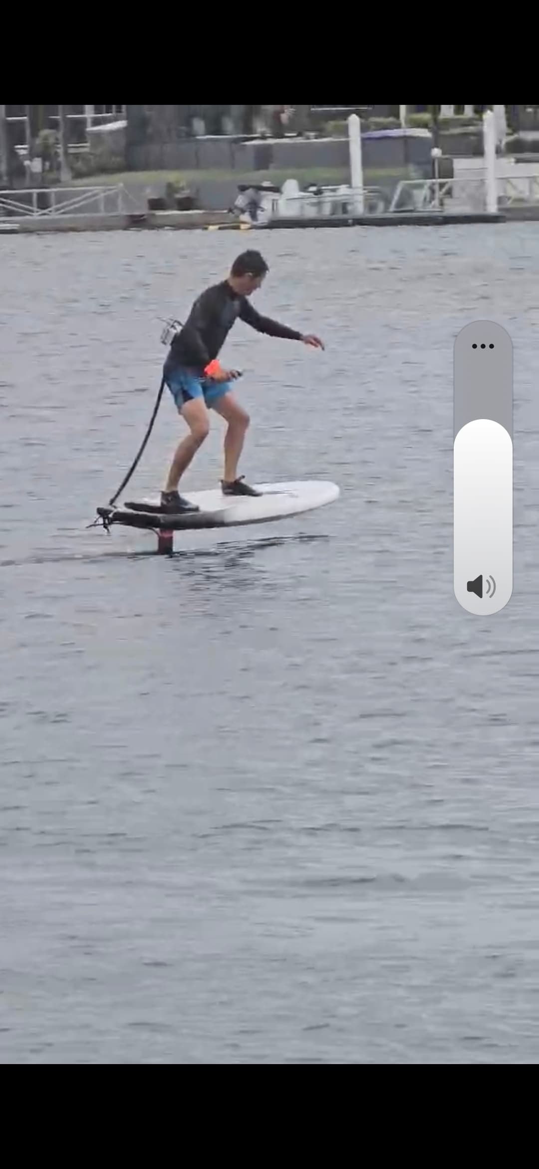

I tried a much smaller board: an old Naish Hover 40L with the smaller foil (BSC890) and it worked really well. I was able to get up on foil and cruise at 71%.
I still think this is too higher power percent for cruising. Can anyone recommend a way to lower this? Maybe a 3 blade prop? Or higher amp ESC/VESC?
Also had a problem… after doing a few laps when i stopped and restarted the motor sounded a but rough and the power cut out at 69%. When back on land it would spin up to 100% out of the water but not in the water. Any suggestions? I cleaned the motor and resprayed with corrosionX and cleaned and regreased the MT60 connectors. The box was dry i side and nothing hot at all.

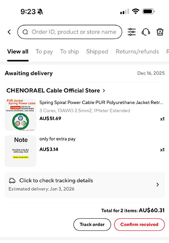

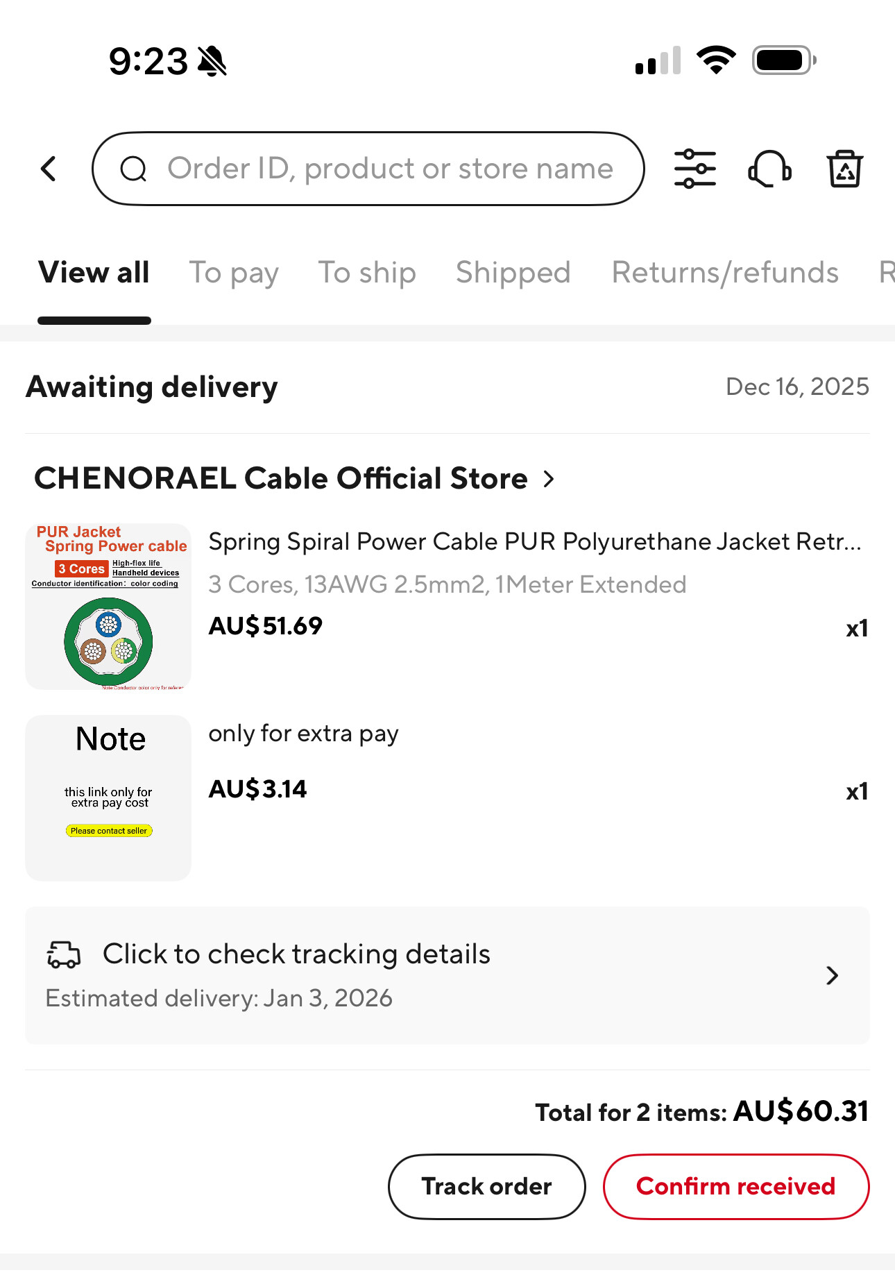

Would have thought 2400 is heaps, is that a curly cord?
I just received one from Aliexpress and the guy was very flexible, I messaged him and he added a metre of straight cable to one end of the coiled section very cheaply. The cable is PUR sheath 3 x 2.5mm2 and the OD is 8.6mm
My straight cable version is about 2m total, it’s pretty short but actually found it to be fine when I’m surfing. Have a regular straight leash a smidge shorter so there is spare cable to allow for the leash stretching.

That cable looks great. How long is it fully stretched out?
I think my.unit was cutting out (at 69%) prob due to water ingress in my MT60 connectors. Will add epoxy.
Coil stretches to 1m and I added an extra metre. Next time I’ll get a bit added onto both sides of the coil to give more mounting and terminating options. It’s pretty heavy but seems good. I’ve found it’s super easy to nick the cable on the prop with straight cable, hoping the coil section keeps enough tension to prevent that happening.
@JonathanC Thanks. I will order some coil.
