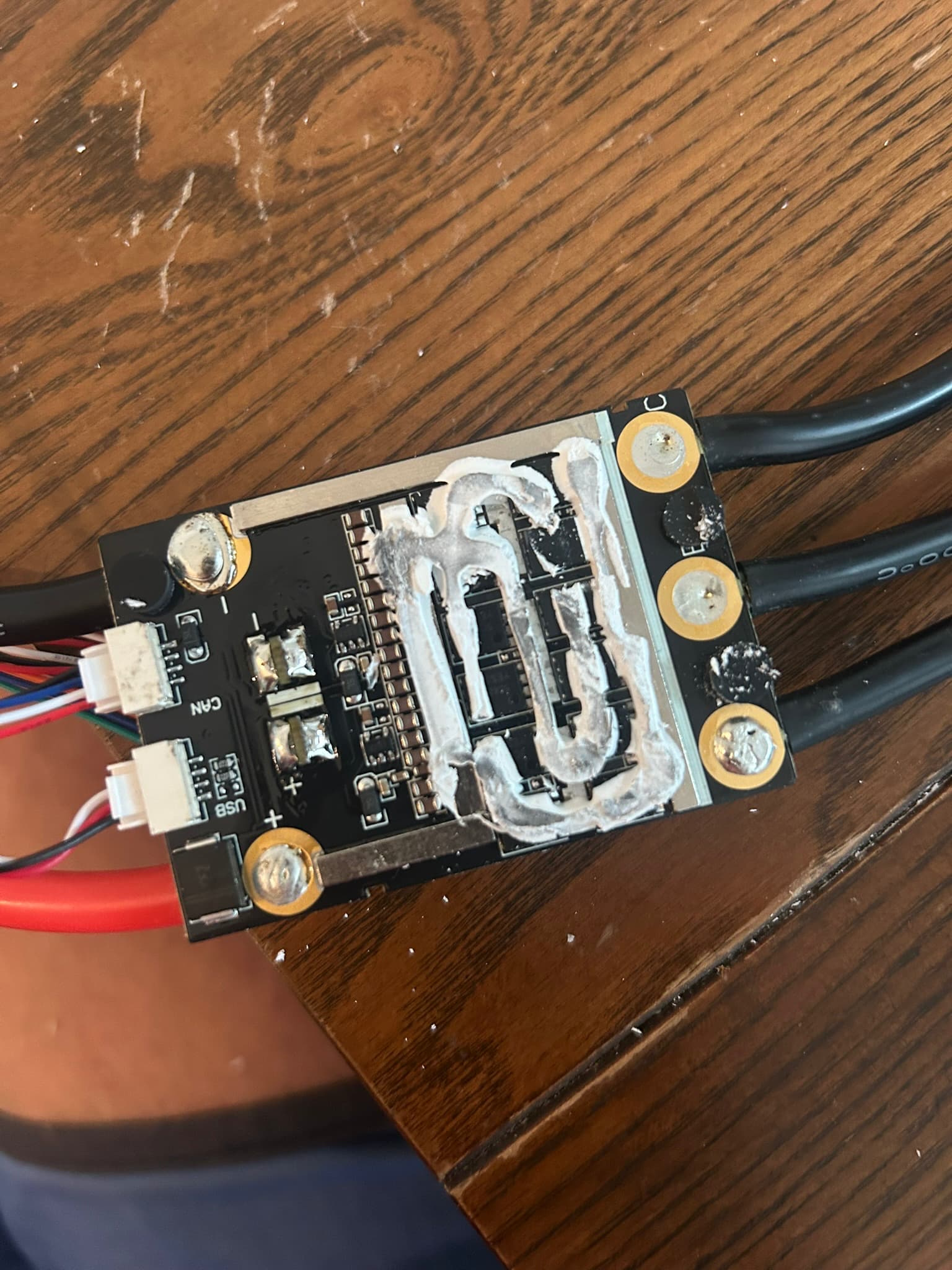

I use FSESC6.8 on mine. From the factory is has bad thermal design but I have removed the stock radiator and used my own solution.
Since my box is metal, I glued the ESC with thermal glue to my battery case. I had to add a couple of copper plates on the mosfets to raise it up 3mm as the two connectors protrude.
I am using it on 13s and 70amp. The temp never goes above 40degrees.
This is how FSEESC6.8 looks after removing the radiator:

I used 10W/mk thermal paste from JEYI. Use the paste only to close any air gaps and make copper stick together better. For comparison thermal conductivity of copper is 40x more than thermal paste. As such you want to use as thin layer of thermal paste as possible.
For my next build I will be using alumina ceramic plates instead of copper as it is also electrical insulator.
