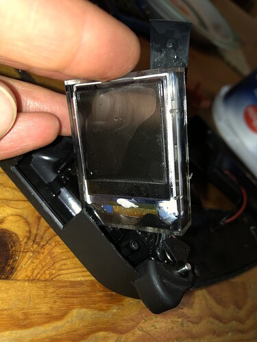

Water can get under that display through the side. Thats where I have seen multiple fail.

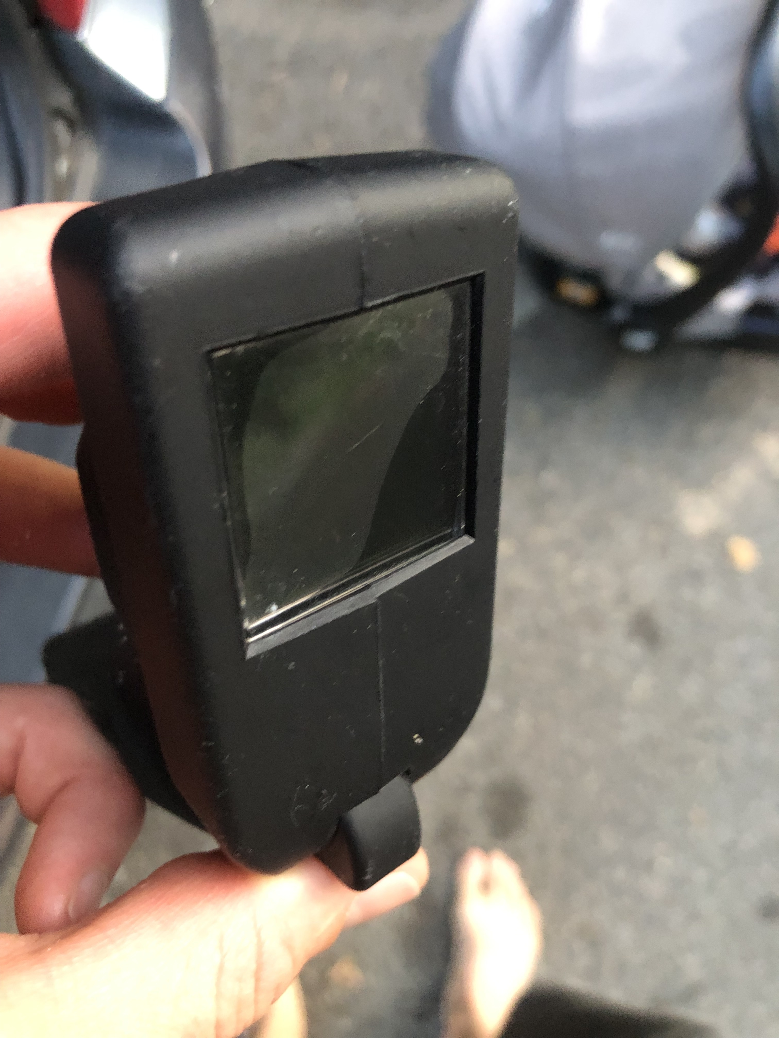

So I checked battery current. Upon turning on current goes to 600ma. While still holding the button, it is at 800ma.
So clearly there is a short somewhere.
I cut 3 suspicious wires to the display, but nothing changed.
There is really nothing I can do anymore other than cut all the wires to the display and see if it works…
If there’s a short something will be getting hot.
Right… Thanks, Ok then, I checked, part of that large main epoxied part gets hot like 45c. But then it cannot be repaired. So don’t know how but water got inside there probably. Or they fail prematurely intentionally
Could be a blown regulator which would explain why the whole thing doesnt turn on

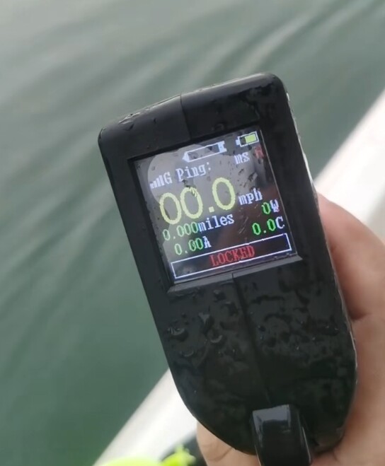

So, mine just started to act up too (VX3 pro).
Of course when it is the most inconvenient, starting of vacation. ![]()
Yesterday it just turned off on the water for no reason and would not turn on again.
So I rinsed it, dried it and tried again. Did not turn on.
Put it on charger and it went into charging, but without display. Still would not turn on.
Put it into a bag with rice overnight and tried charging again this morning and after a while the display came back on.
Now it is working just fine.
So I suspect there is some water getting somewhere it should not.
Has anyone got some ideas that would make this remote survive being used for a few weeks?

. They all had the same problem, their glue does not adhere to the screen protector
Now, as soon as I get a new one, I take it apart and apply epoxy resin to the back of the screen.
