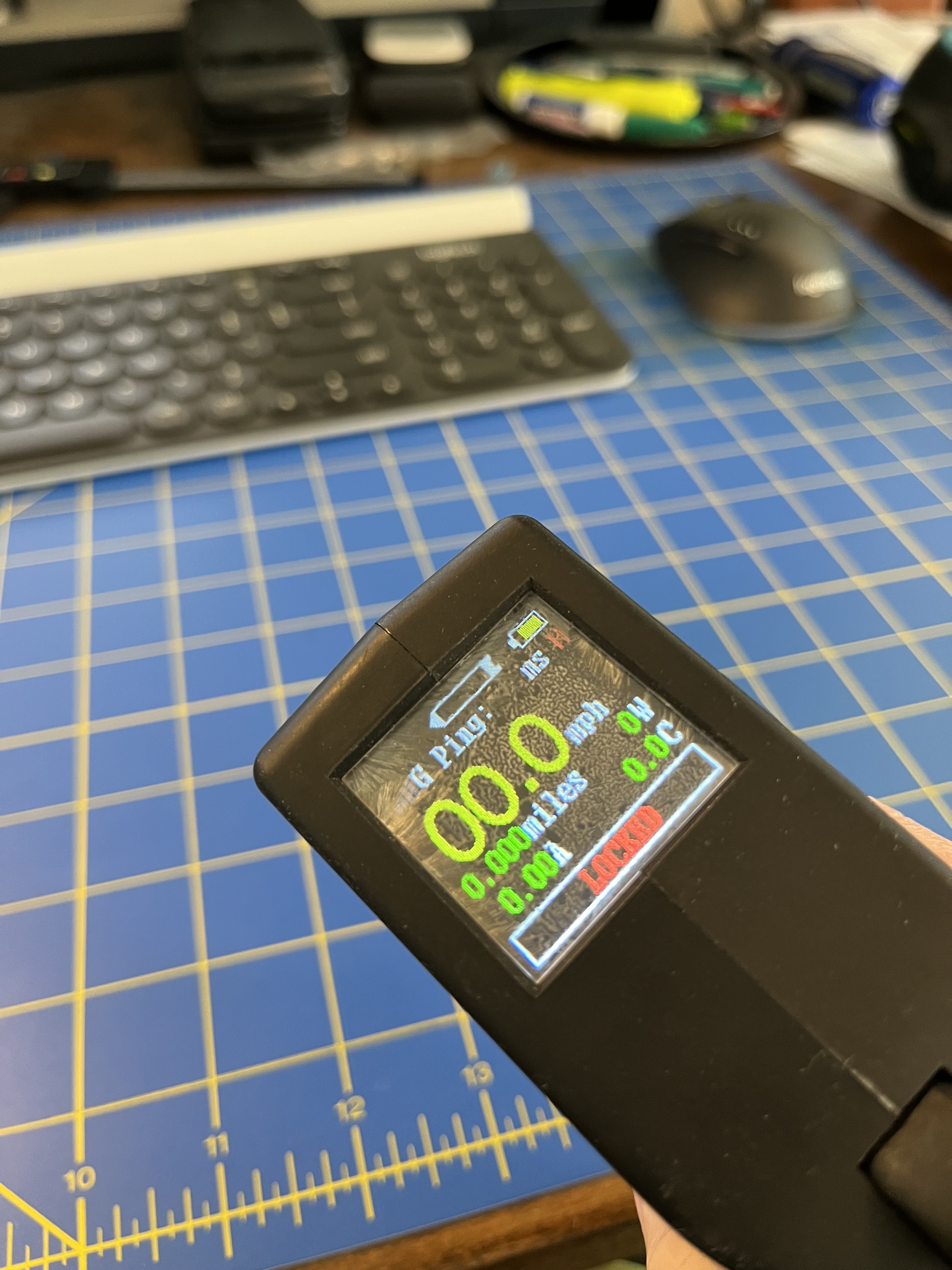

This remote is not waterproof, water penetrates under the screen protection, which is not glued.
I haven’t seen this problem on the forum yet?

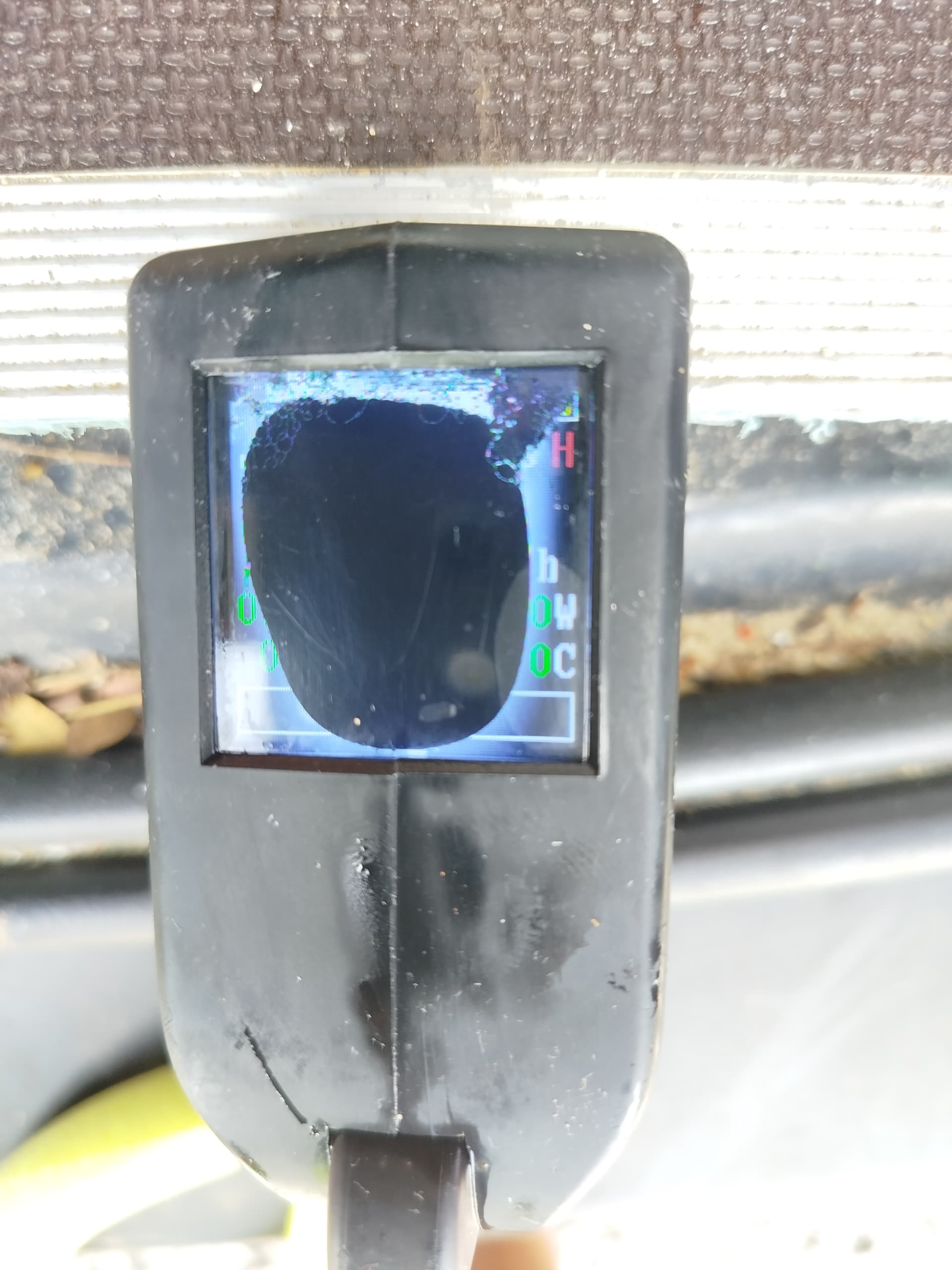

Wow yours really got ruined! I have one that was new a year ago, but now I can see moisture has crept in and around the screen and it is becoming harder to see.

Just wanted to note that I have a VX3 which has failed after 4 uses. I turned it on at the start of the 5th session, it showed the loading screen then shorted out. Despite opening it up and drying it in a bed of rice it never recovered.

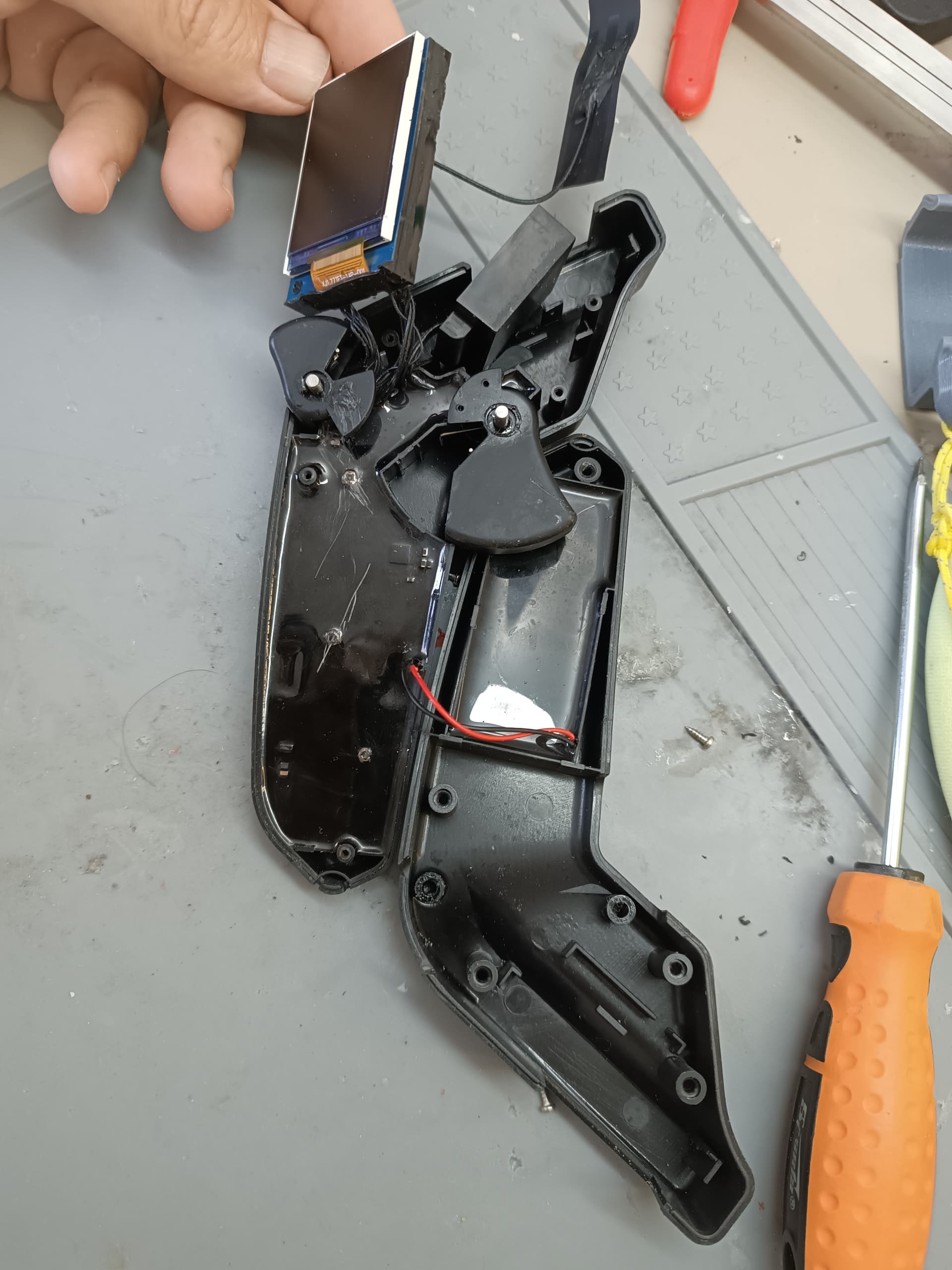

Yes, as mentioned, I recommend at least opening it to check how it’s sealed.

I now have two VX3 Pro remotes that have screen gone white. The remote still works and I can use it, but cannot see any screen information. Does anyone have any idea if this could be fixed? First screen died after a few weeks lost and submerged, second was under 10 sessions.

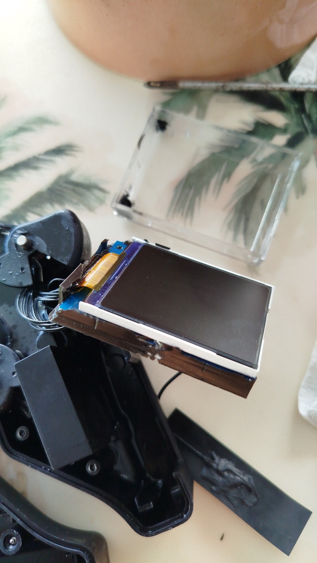

There is no water ingress in the display. Although it should be better insulated.
There is too shallow epoxy coverage with some rust points on that black epoxy.
Not sure if there anything can be done to make it alive and what was the reason it became suddenly dead…
So it think it is not even a matter of waterproofed, it is just a bad product that can suddenly die.
