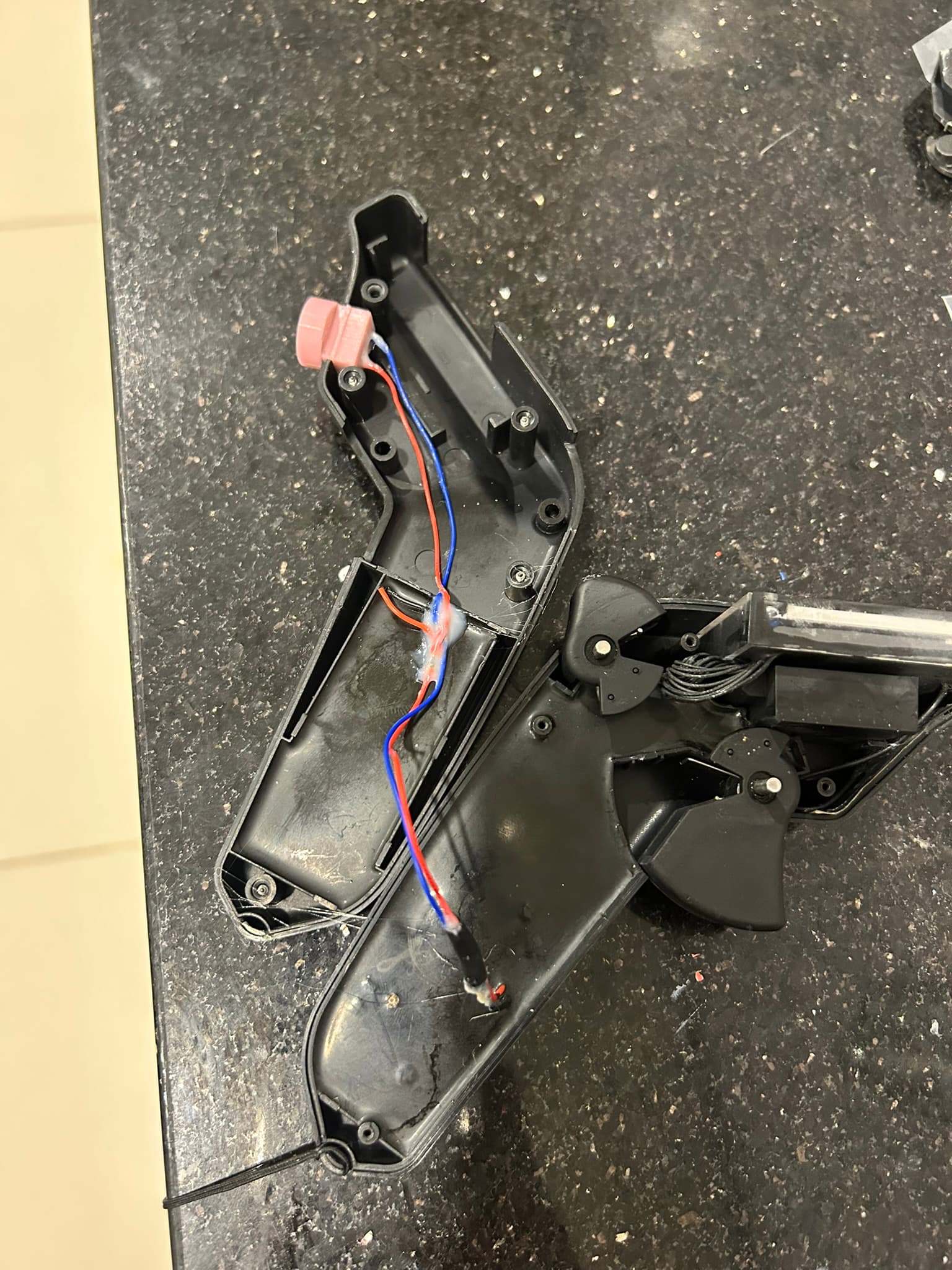

So I revived mine ( It did not charge anymore ).
Opened it up, cut the wires, created a T connection with the extra cables going to the outside of the remote.
Now I have + and - on the outside and directly charge with a RC charger.
Works great so far, always hated that inductive charging thing.
Now it charges 4x as fast and does not heat up (it used to get very hot during charging, I personally think many of its problems are a result of that heat).
So now I have a nice Frankenremote as a backup.
Would not do it to a working one, but if someone has trouble charging, that could be a solution.

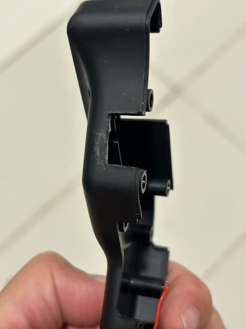

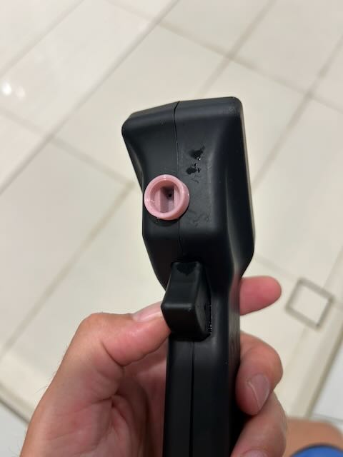

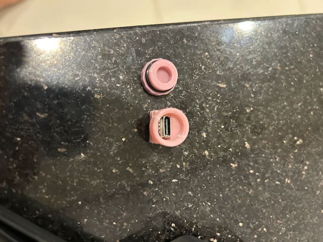

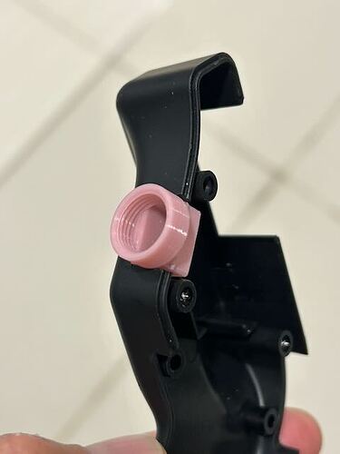

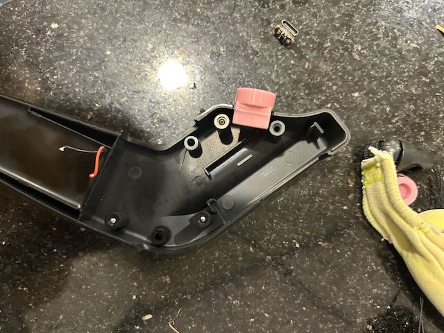

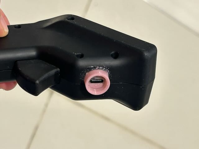

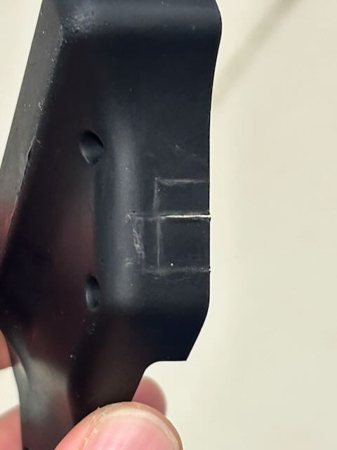

My stopped to charge too. I bought a cheap usb-c charging board, 3d printed a waterproof container for it and now it works again!
