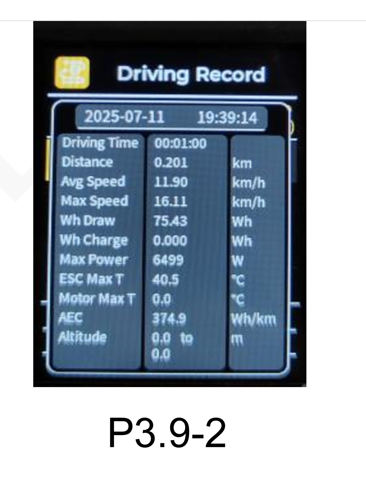

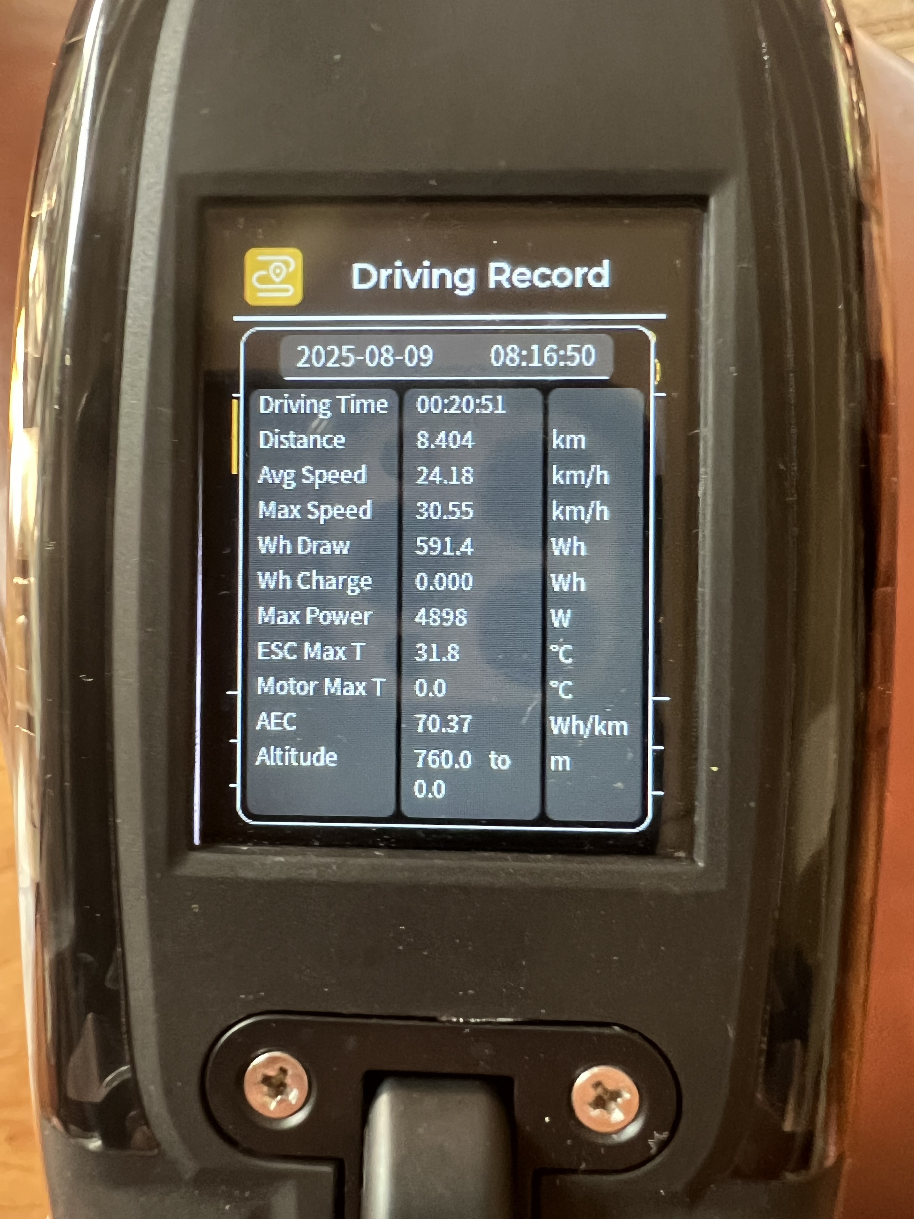

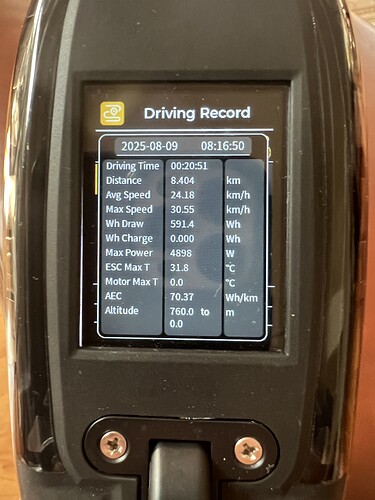

My first real record. Flite prop on 65161 motor 10S11P 21700 battery, 1300 Gong XOver foil
Are thos e all the parameters? Can you get current and voltage too?
That’s the “detailed view” they provide in the initial ver of firmware. No user control over what is displayed.

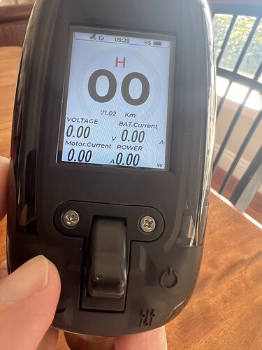

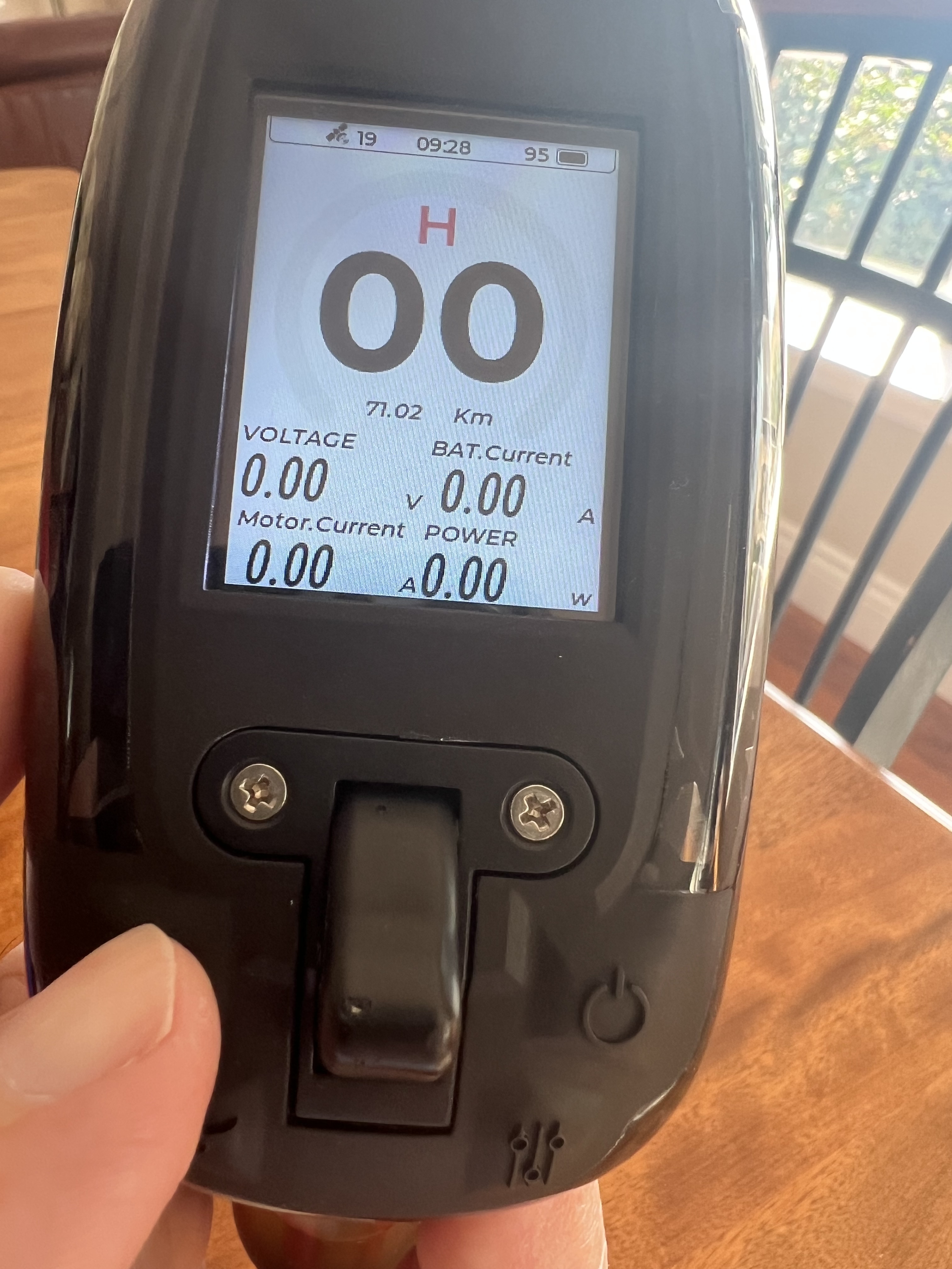

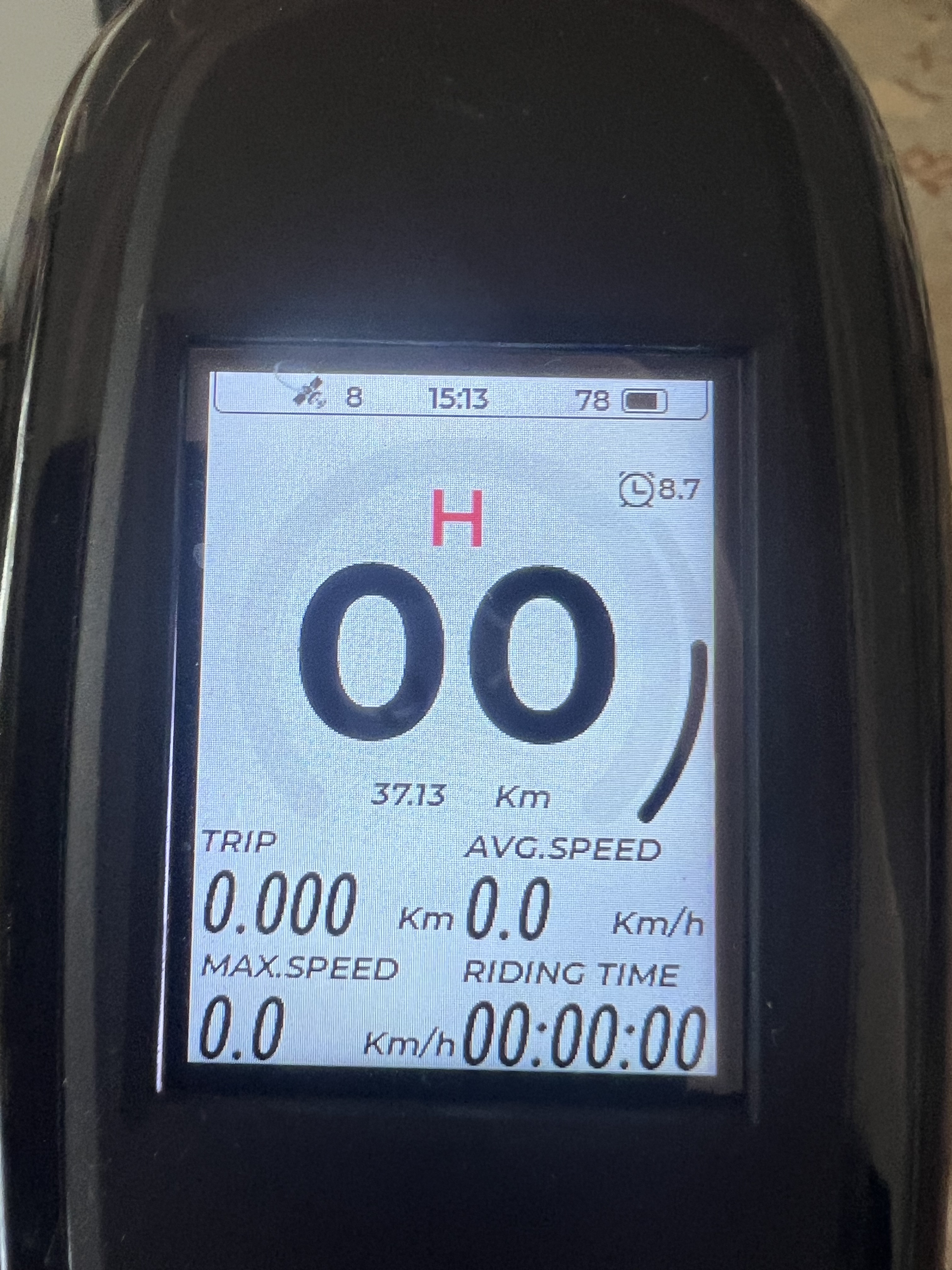

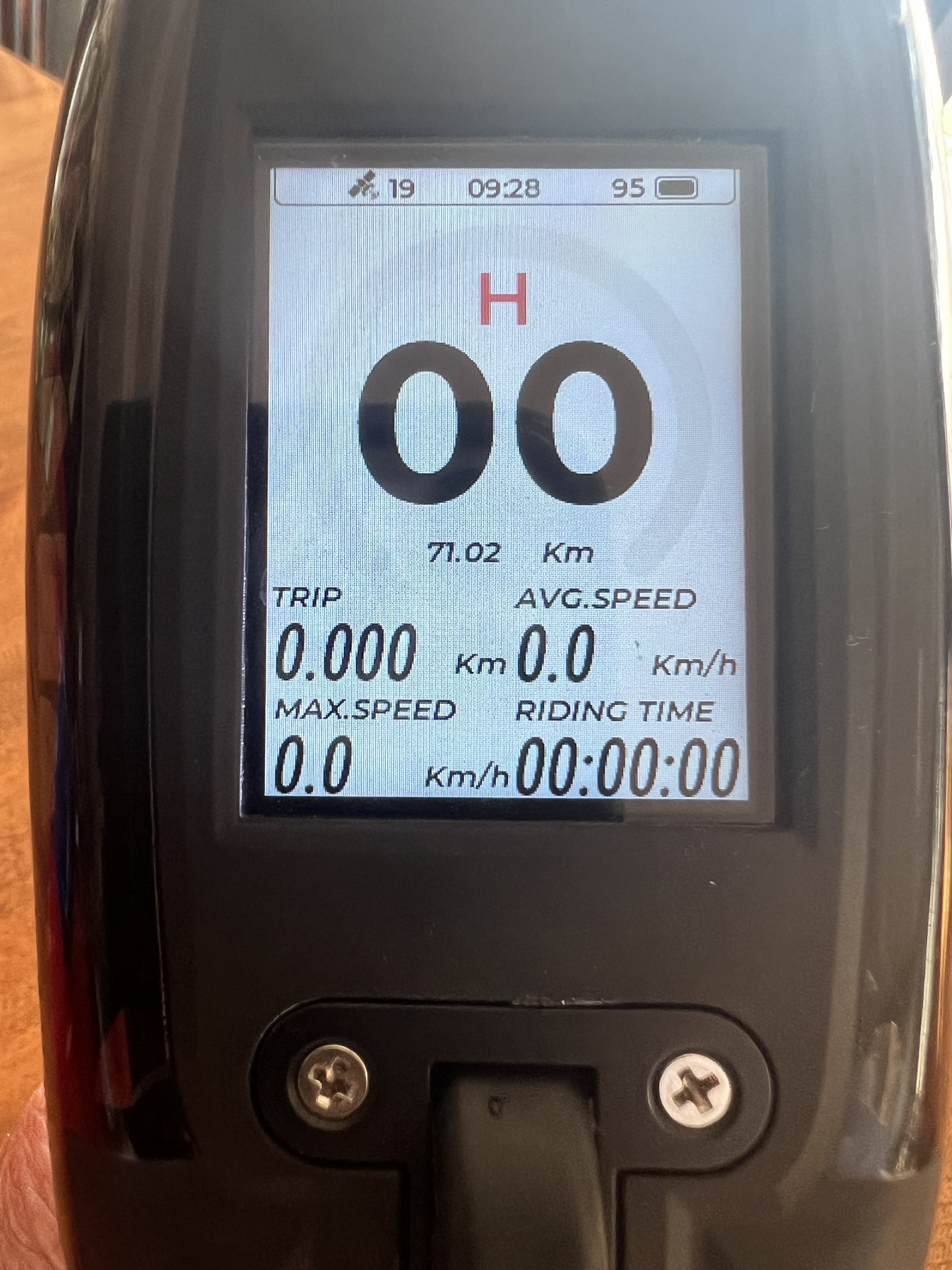

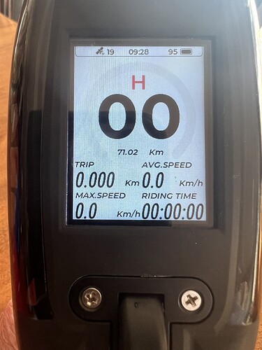

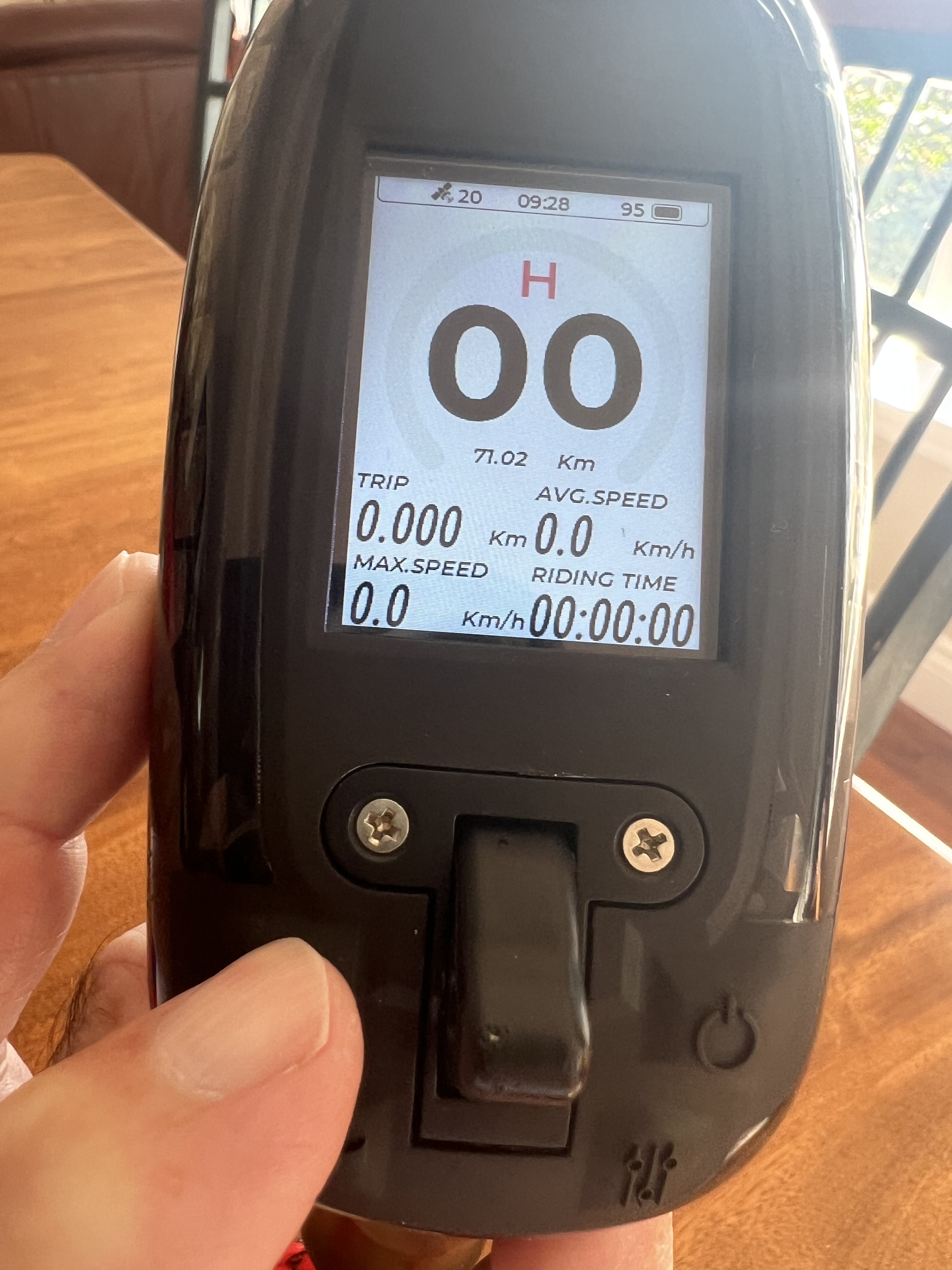

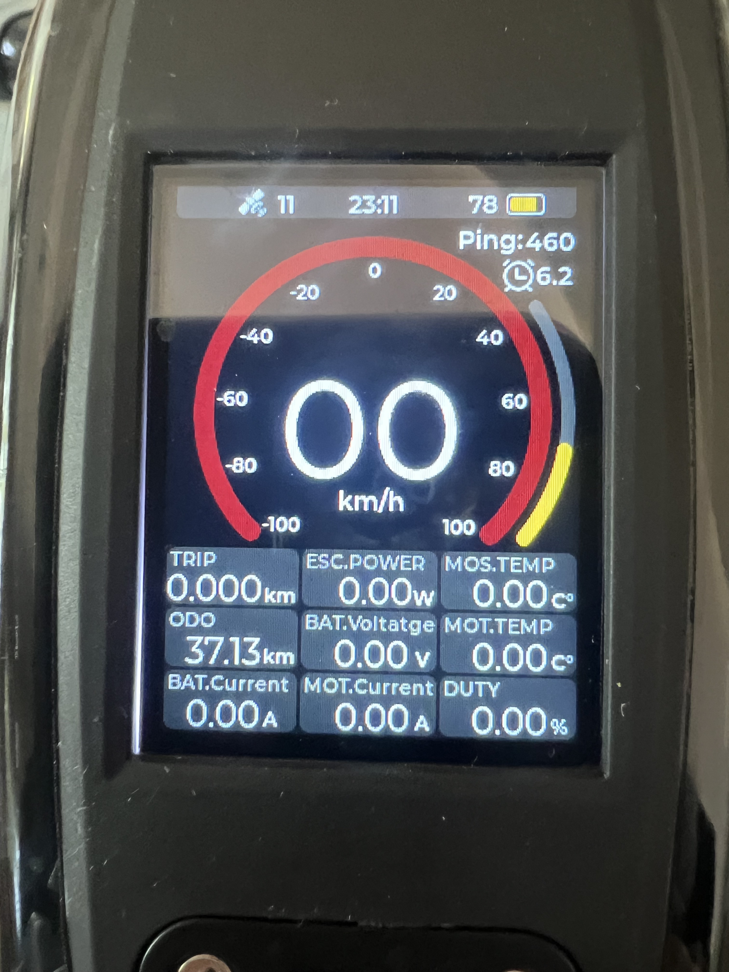

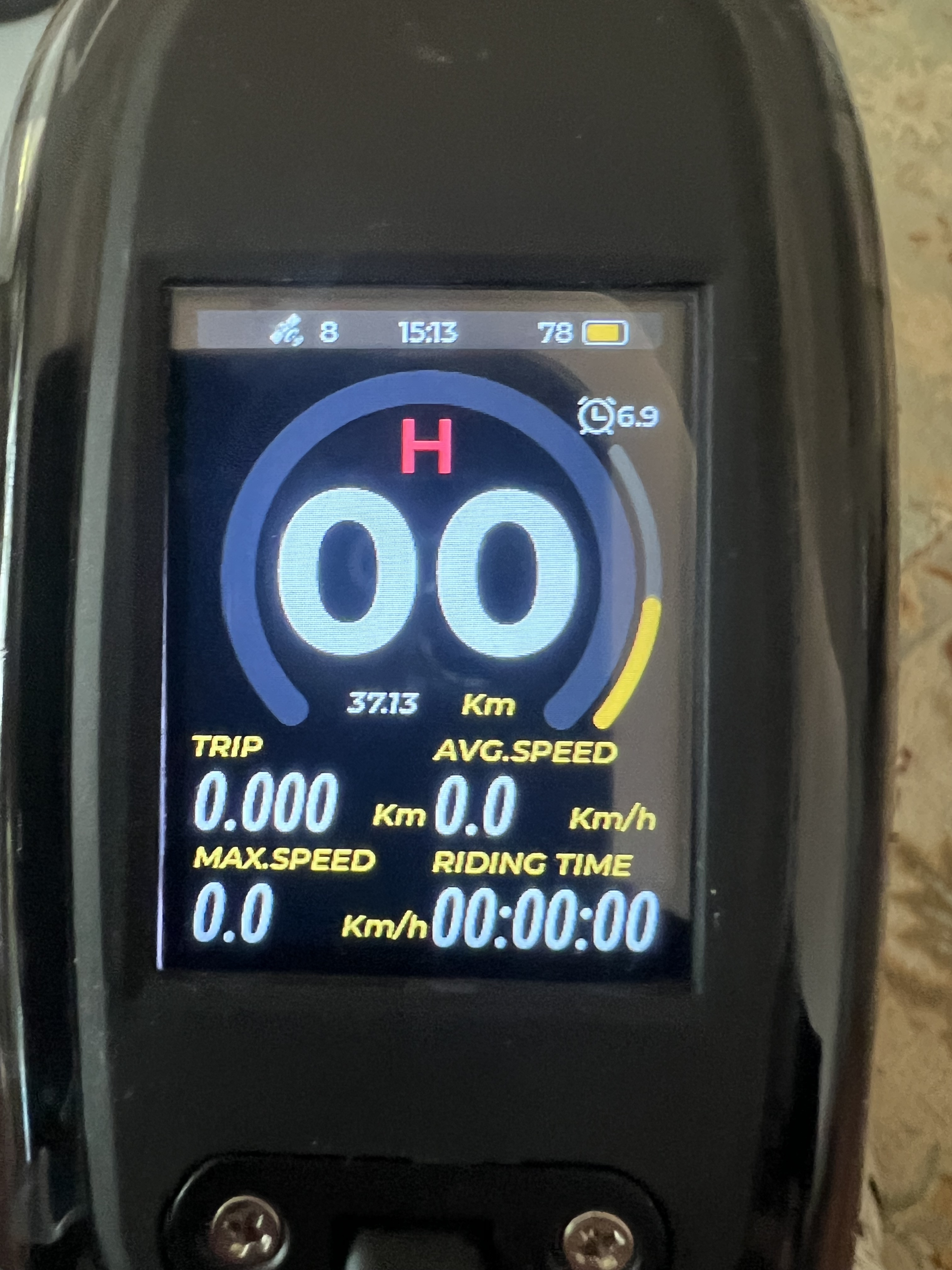

I just updated the firmware of the handheld (this version does not require update to receiver)
The only feature change is the layout of the screen. A new menu item allows a choice of the initial “detailed” screen and two versions of the “simplified” screen. See below for Detailed then Simplified 1 and last Simplified 2
The process was quite easy once I got by Win11 refusal to download an exe extension file🤨
As expected the new firmware version requires the user to reconfigure the remote for their preferences so thankfully I had made some notes on what I changed the first time😀
Haven’t used it in the water yet but I’m liking the BOLD speed numbers in simplified as that’s what I tend to glance at the most.

Just discovered that in the Simplified screen you can rotate through all of the parameters that get displayed by repeatedly pressing the MODE button.

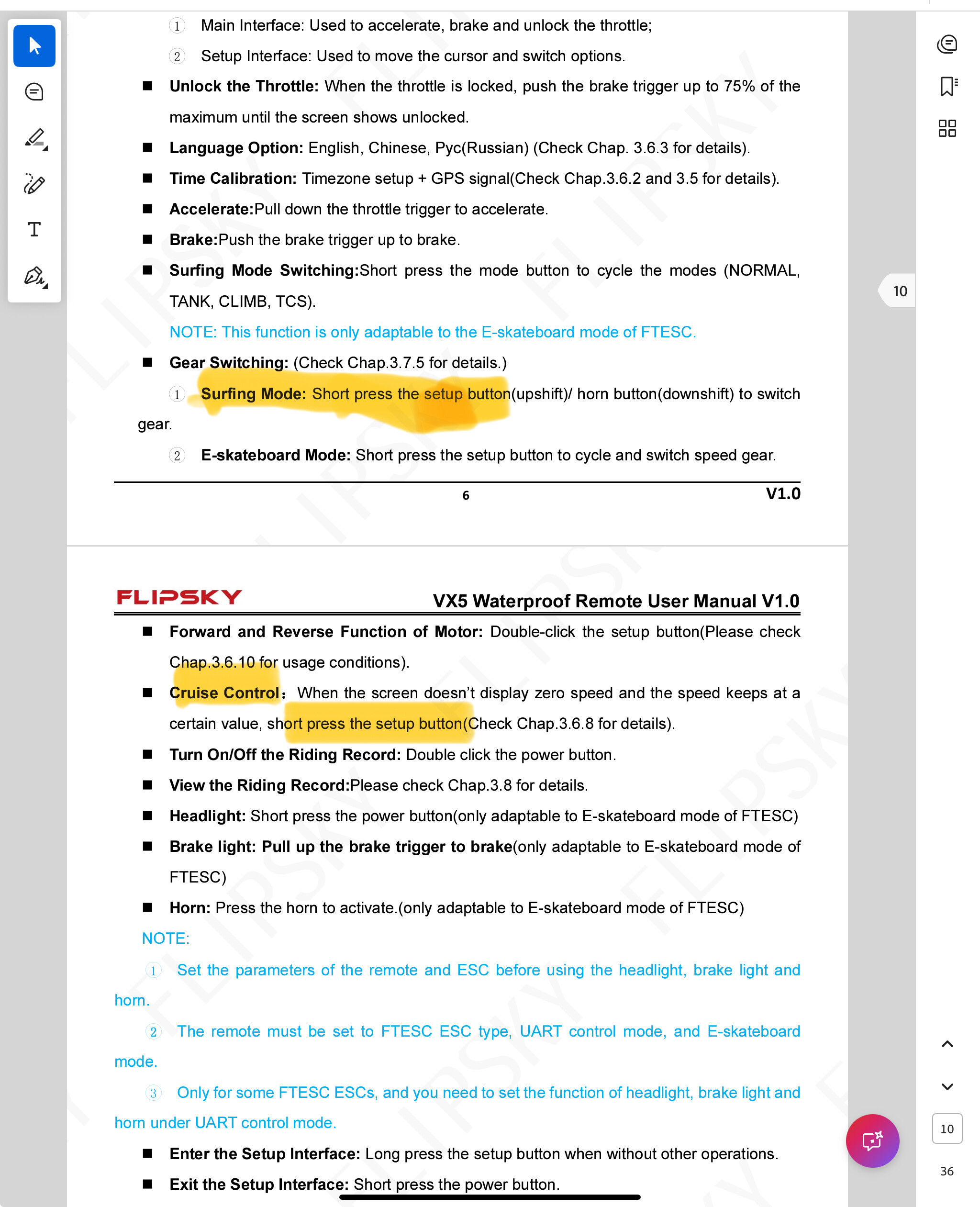

Also I’m having issue with “gear up” button being same as “cruise control” so at speed if I want to gear up it goes to cruise control instead. @Foilguy did you have this kind of issue?
@Anq
Double tap power button to start and stop recording of driving record.
I don’t like cruise control so have it turned off but you are correct as the manual indicates a short press of setup button is stated for both of these functions.
What version of firmware did your remote ship with?
I ended up disabling the cruise mode, now it works really well.
Mine shipped with 1.0.1
Glad you have a solution.

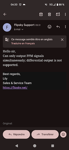

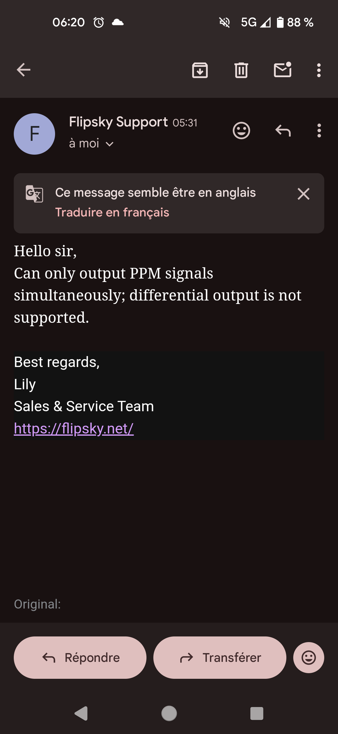

Note for everyone who wish to know if the VX5 is the commercial solution for dual motor tow steering : NO !
