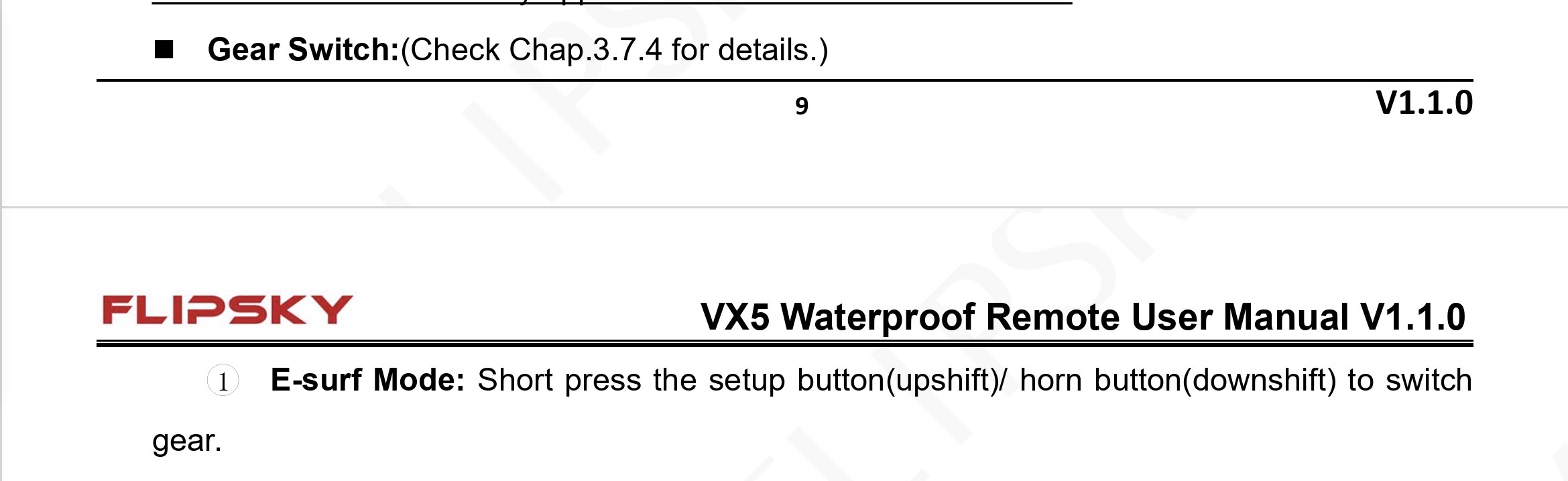

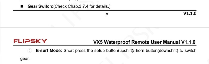

Hi there could you take a minute to describe how the gears are changed up and down please.

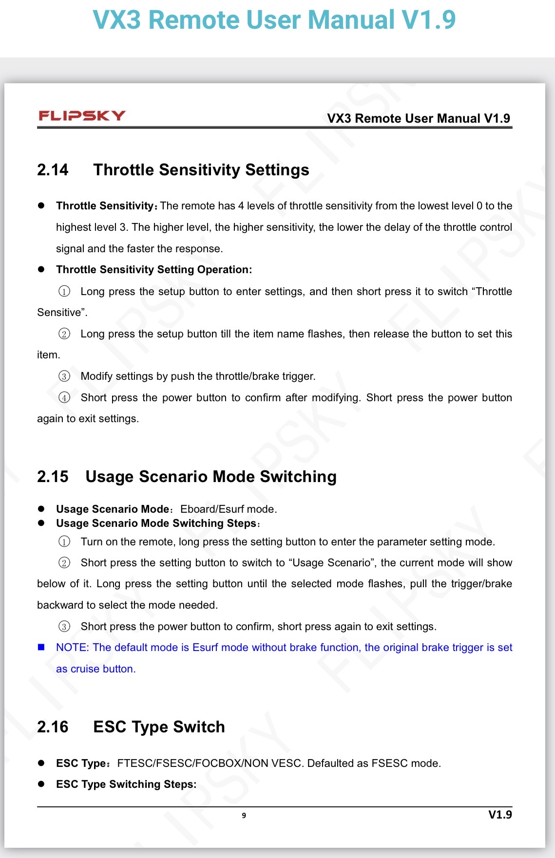

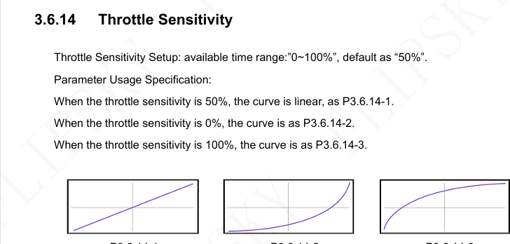

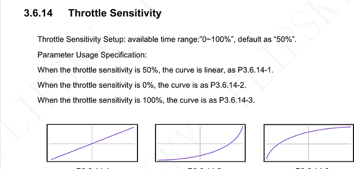

also possible vx5 to change trotle sensitivity. i use like 10% so litlee release you feel instant
(vx 3 i dont know)

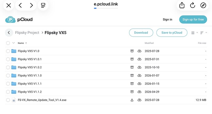

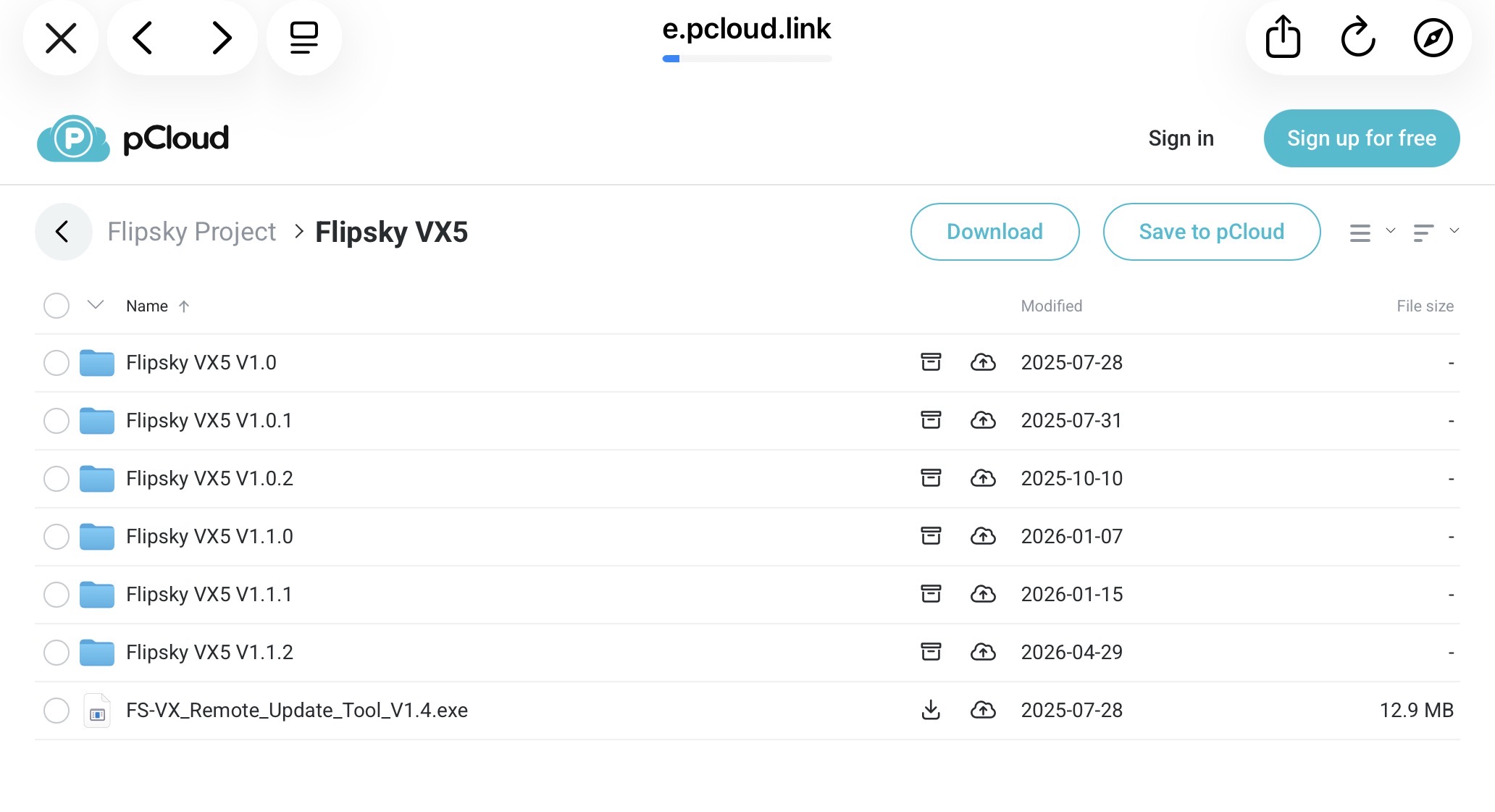

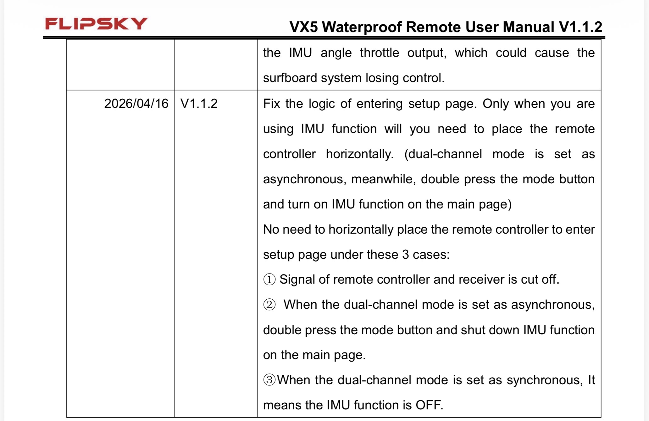

Is 1.1.2 updated? As I remember having issues with it, not showing all the data.
EDIT; I see they uploaded 1.1.3 now.
Recent Flipsky blog about IMU function.

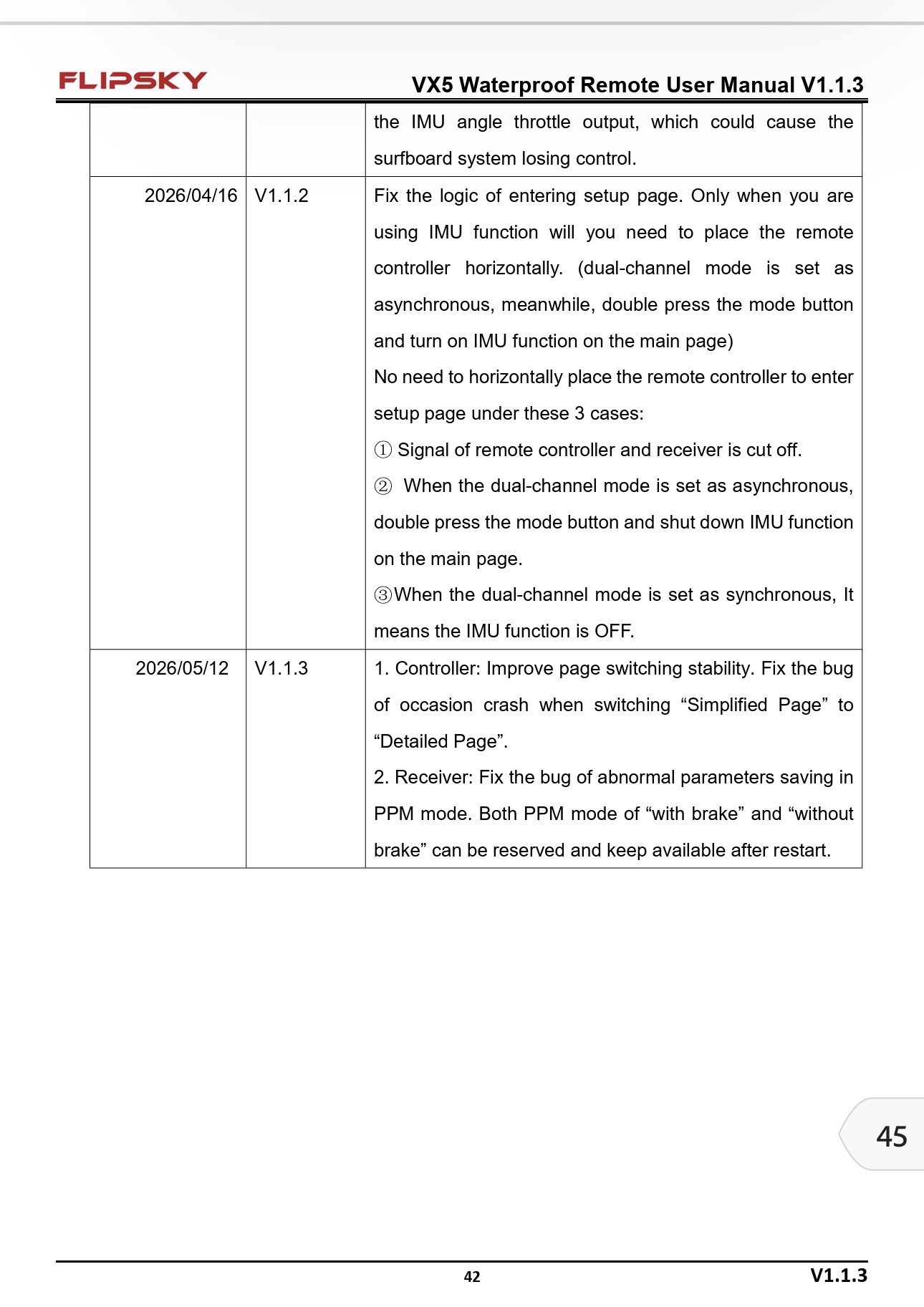

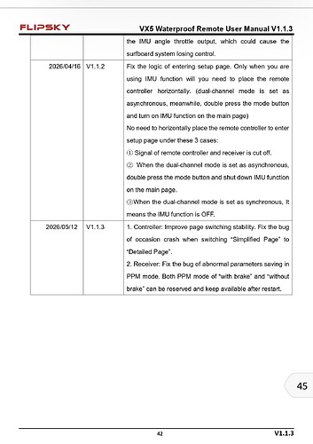

They have also released ver 1.1.3. This is change log at the end of each user manual
