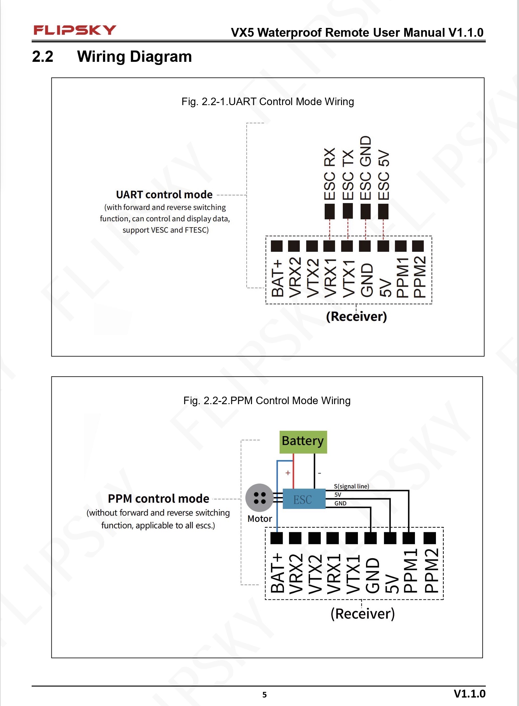

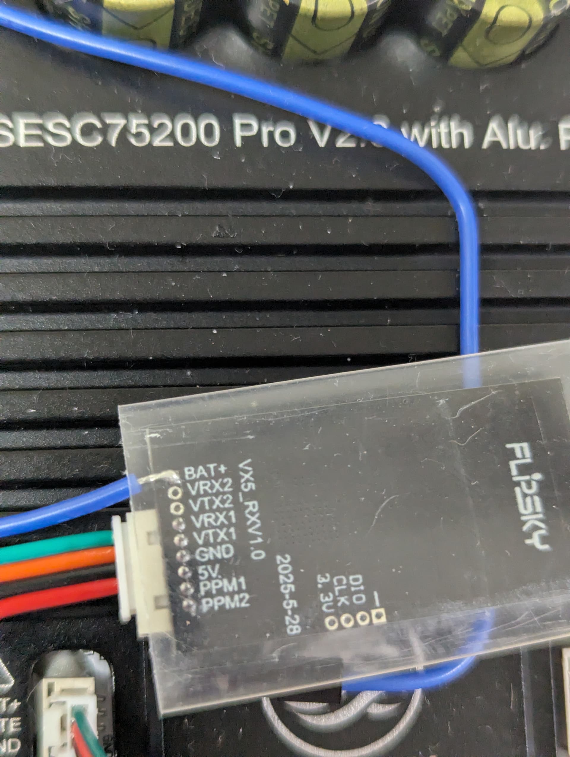

What is this purple wire labeled “Bat” on the receiver?
Its for the + of your battery, now you can see your Voltage. Like to help you out. :partying_face:
Better ask. Are connections on my receiver correct? I was able to run the motor, but I am not fully sure.
By the looks you have a 75200 Vesc. You don’t need the purple bat wire, that’s only useful when using PPM. You can simply use UART and it will show all the data.
Looks like you are wired for UART but without a clear picture of both ends kind of hard to say.
Thanks. It now makes sense. I will verify.

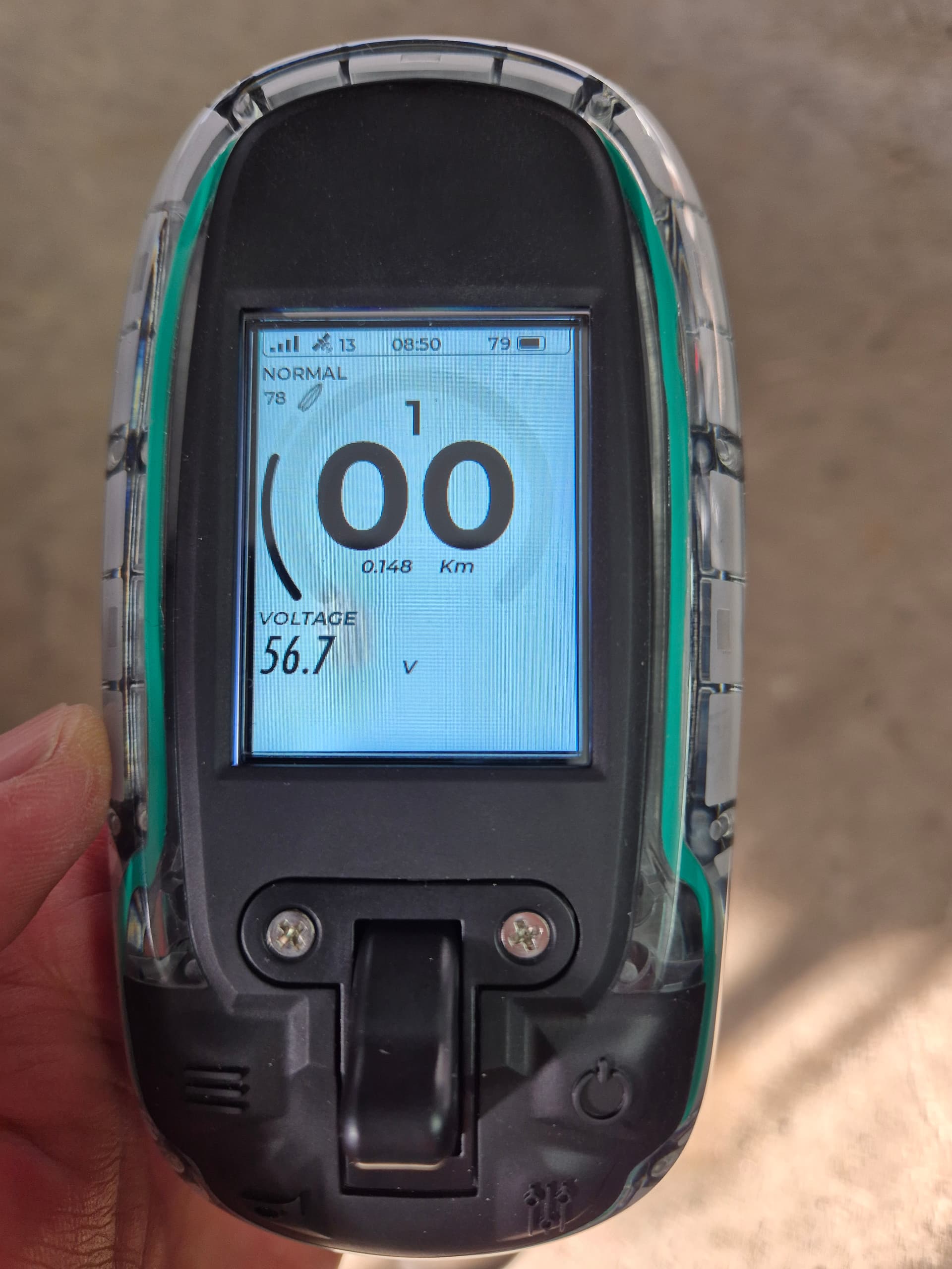

hi all, anyone got a idee how to turn remote VX5 record on? i can see speed, trip, power… and all the rest but not recording.
remote setup:
gps is working after few minutes (i can see speed when foiling ) i can see distance after foiling. record mode is on “full time” or " speed is detected" (i tryed both).
board set up:
using gps speed is “on”
but not record anything… :frowning:
I assume you are asking about “Driving record” mode. Double tap the power button.
Good idea to download full user manual from linking posted.
i have the VX5 manual V1.0 but nothing about double tap…
many thanks for the info

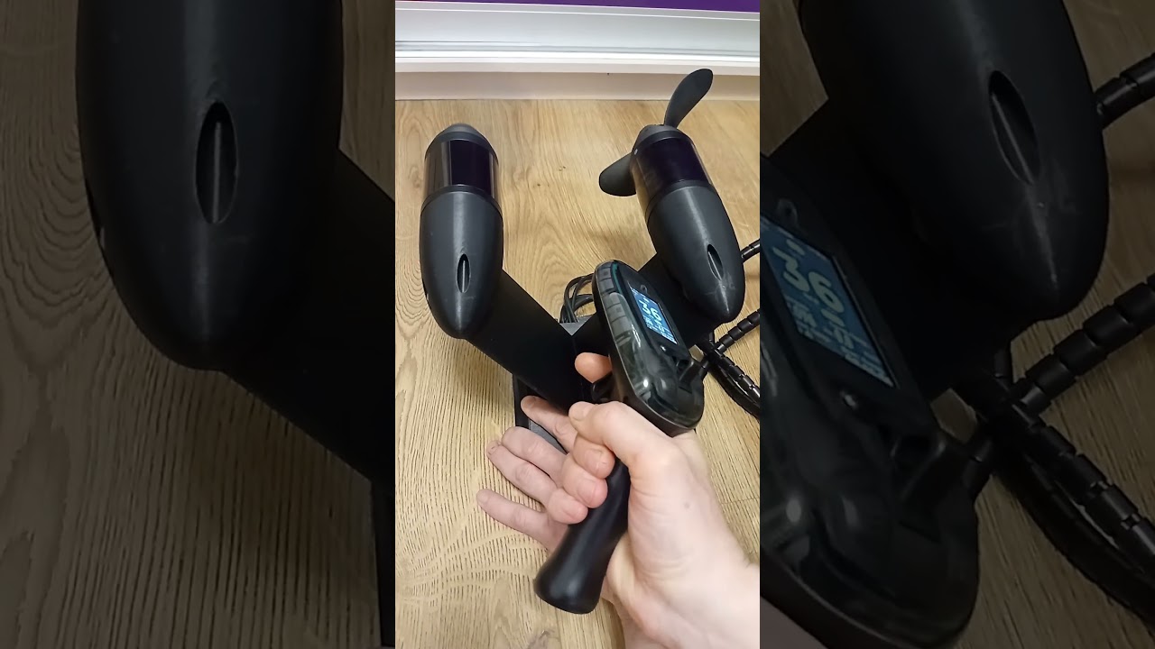

I finally bought a VX5 remote control, which can control two motors right out of the box.
But it didn’t work, and it took me two days to figure out why. Special thanks to the manufacturer for the lack of documentation. Now everything is fine; at least it works and independently controls the motors in my room.
Cool!!
It looks like IMU controls which motor spins but does amount of tilt control RPM or is that still the throttle trigger?
