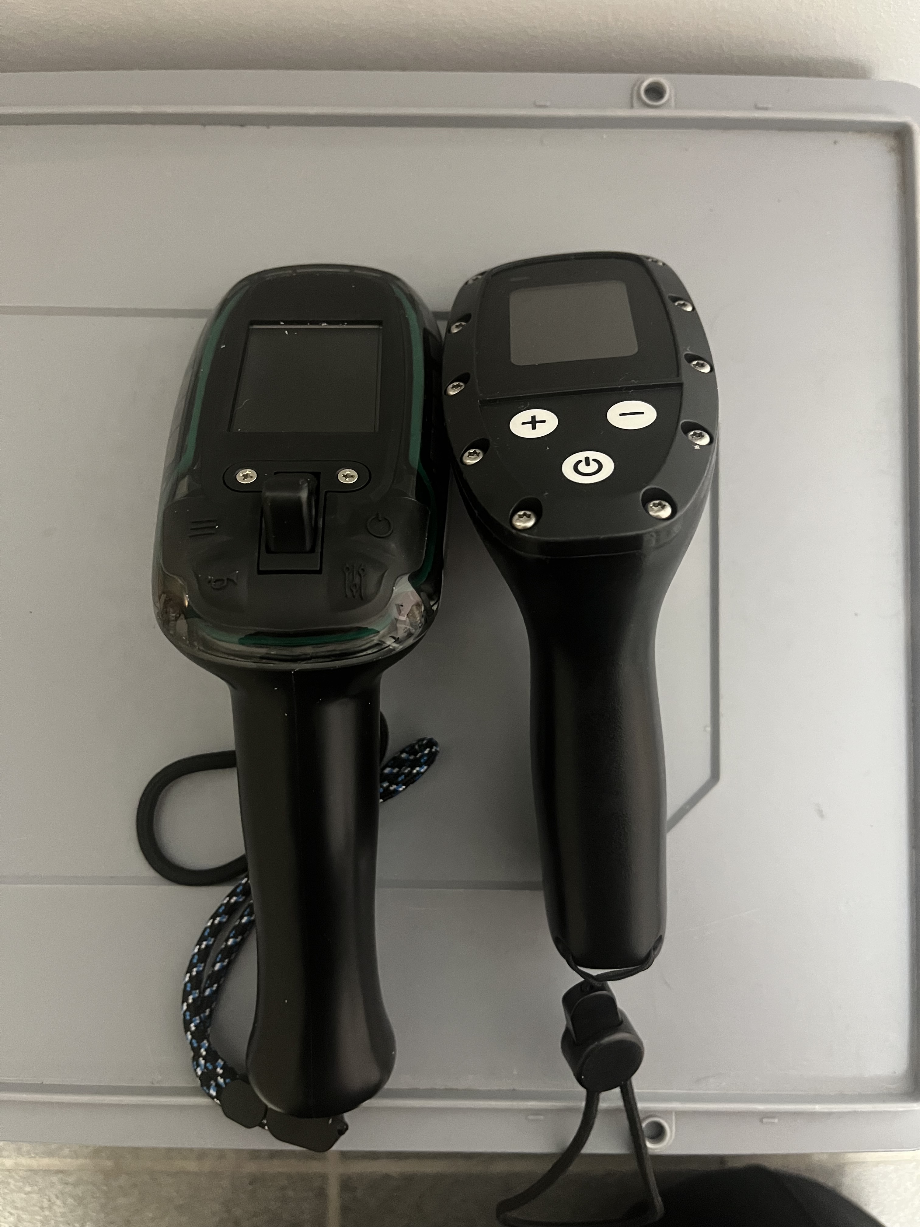

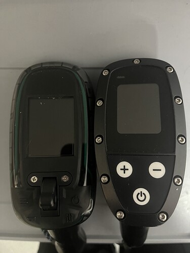

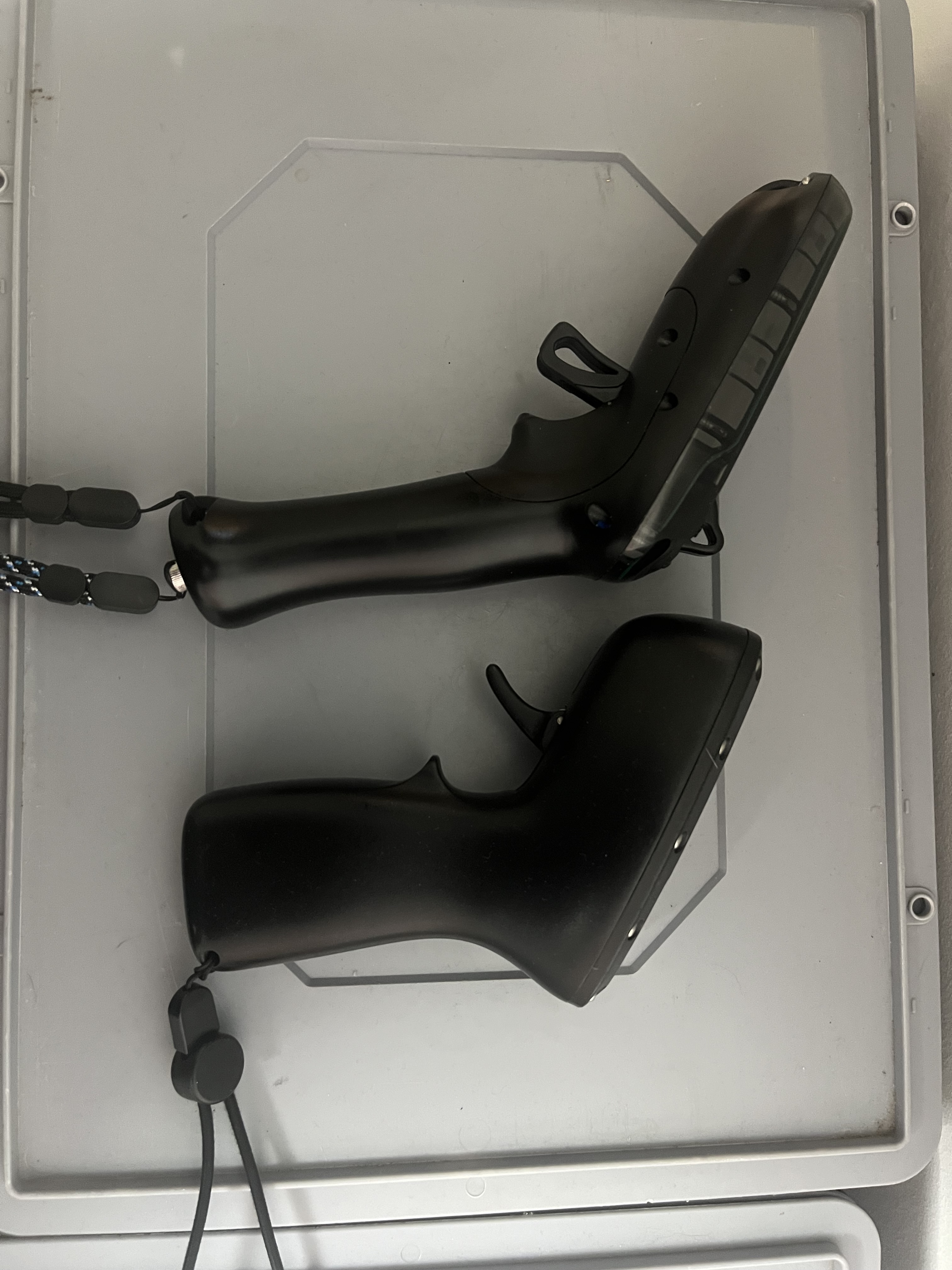

I have both.
2 FeRos since 3 years and VX5 since some weeks.
I like my FeRos, but because of no further availability, I switched to VX5 in parallel.
The FeRo is better to hold in the hand and is a little bit smaller.
VX5 has the big advantage that GPS is inside the remote. With FeRo and GPS antenna inside the board I often have no GPS signal. Antenna outside the board would be better.
I like the display and the shown content for both.
Can you post some side by side photos?
Sure:
Thanks! I was using fero for 3 seasons now but after hour or so of riding I get mild index finger cramps. You say Fero is better to hold in hand - I hope in my case will be opposite :smiley:
I bought vx5 too but I am too lazy to switch. I guess I will have to try.
Also I have 2 gps antennas (Fero + metr) outside of board so gps signal is not a problem.

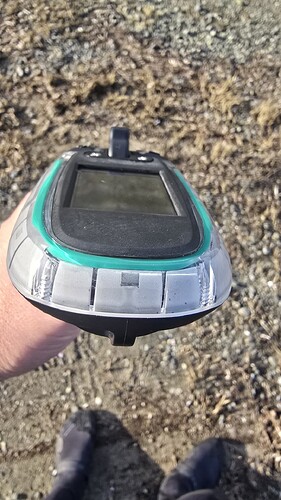

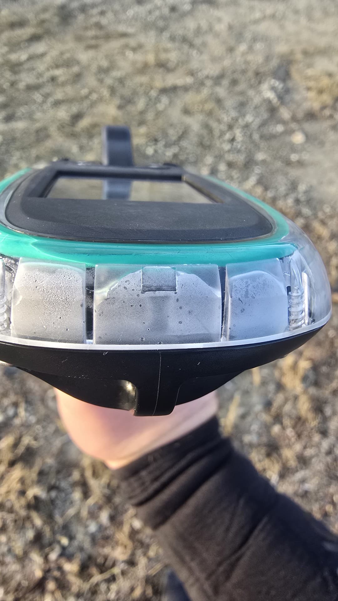

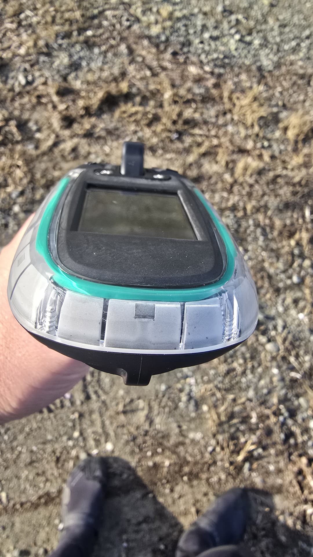

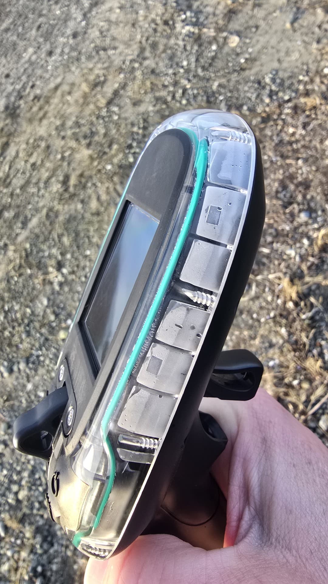

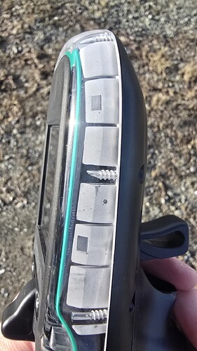

I noticed a few micro water droplets through the clear housing on the VX5 after my last session a few days ago.
I got thrown off a good 10 times today (always try to hold my remote up and out of the water as I bail - but it goes for a dunk at least 80% of the time). Here’s a few before and after pics. Anyone else noticing water ingress, even if it’s just a bit?
That’s looks fine, it’s outside of the green seal on top. Any on the on the screen side of the green is trouble.
Seems like it is fine, but im not sure. Would you be so kind to contact Flipsky and see what will they tell about it?
I have two of them but never tested and i assume they will also be thrown underwater a lot since i will not be the only one using it.
This is no issue, and completely normal behavior, its just some water / condense which forms outside the seal, so its not a problem. Those areas arent sealed at all, so its expectable and not an issue!

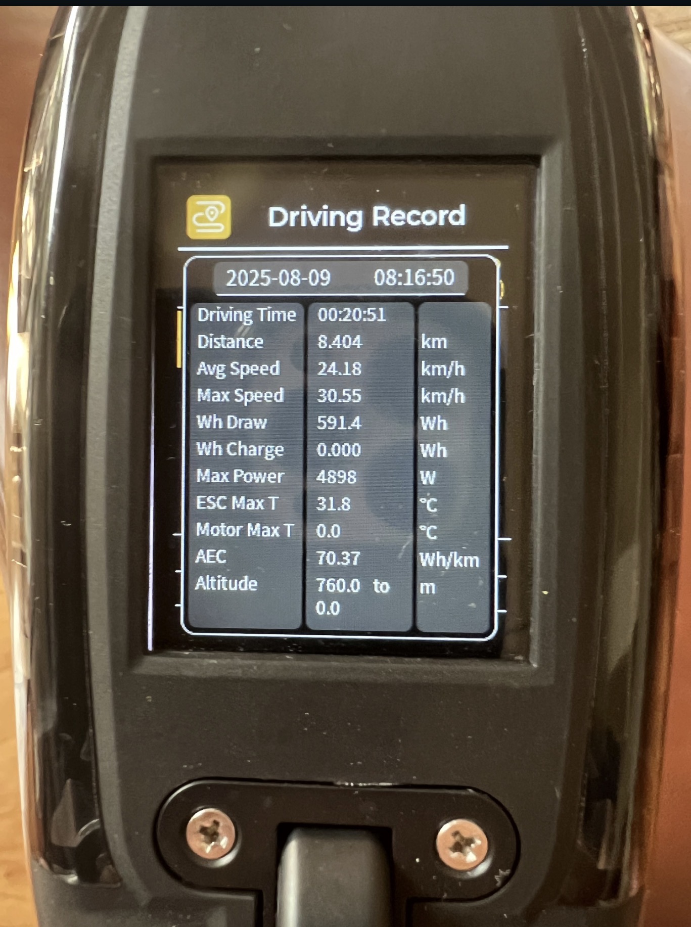

Anybody managed to pull down LOGS from the VX5?
Are there V, A, per second (or whatever refresh rate) or just average and max?
@HOF
Flipsky refers to this as Driving Record. As far as I know you can’t ’download “ them only view what is on the screen .The photo is from a comment I made in this topic last August.
This is correct. The only way to properly log, is by using vesc tools or a third party app, but it will require a bluetooth connection. With the 65220 you own @HOF , you can also connect the VX5 to PPM and the bluetooth module to UART. Maybe just temproarily? Because you will loose all data connection.
Huh, yes…seems like this is the only solution. Thanks for feedback
No, you can use a vesc express with a SD card. No need for a third party app.
