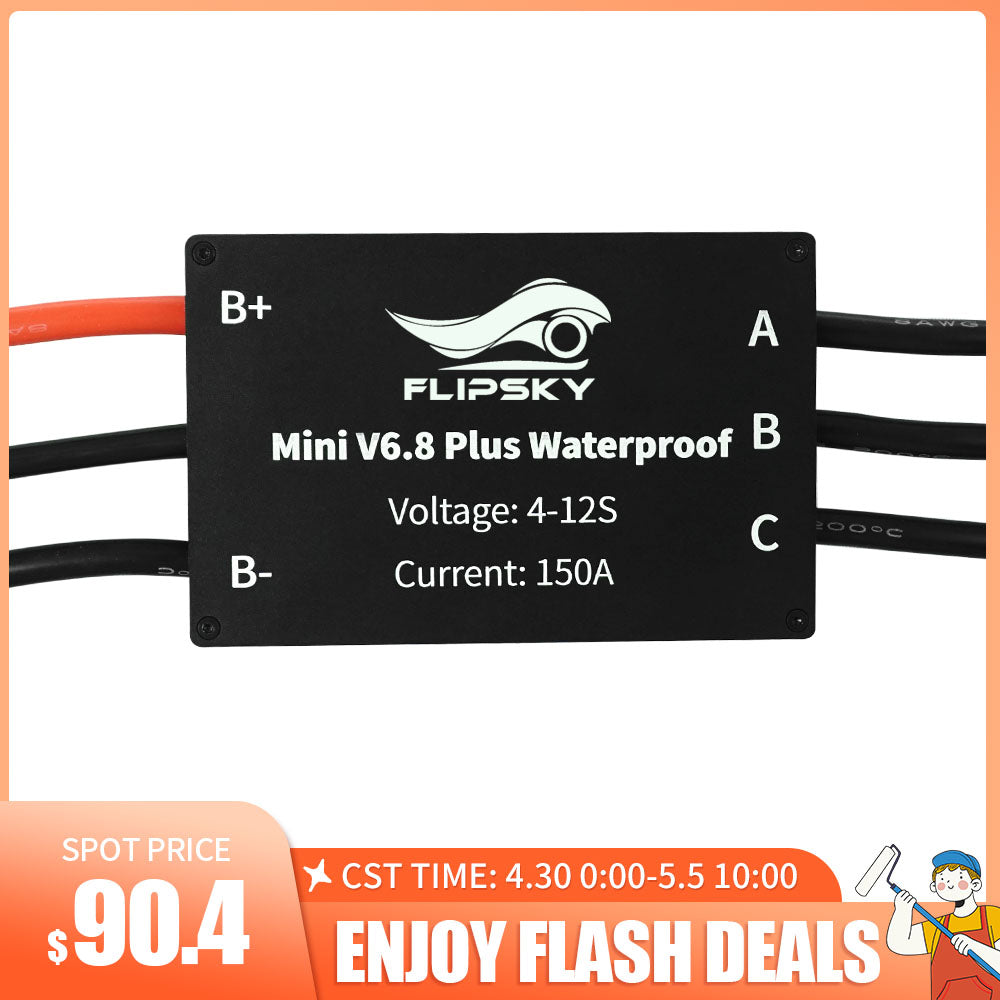

Does anyone have any insight on this ESC? I’d like to use it for a Duotone inspired mod with battery pack on the back, and mount the ESC directly onto the bottom of the board behind the mast, with the ESC exposed directly to the water for cooling.
A VESC clone focused on our needs (150/200A cont/peak) : I asked the question on the Flipsky chat. Their answer is encouraging :

Has anyone tried this model ESC yet. Looks sweet! Even if not submerged in the water under the board, having it mounted sort of exposed inside / or on the outside of a wet waist belt would be better for cooling then inside a watertight box with no airflow.
Flash deal: 90usd
I’ve bought this esc and it doesn’t seem that promising to be water proof. The maytech 160amp esc is totally water proof I’ve had it submerged on my board for a month now with no issues I just wash everything with fresh water, dry then lanoguard.

Relevant snippet here about the waterproofing. I’ve ordered one and will probably not treat it as fully waterproof until I hear from others, as the ESCs were mounted above the water here
I bought one. The phase wires are very short, the battery wires are very long. Seems like they intended it to be far from the battery and close to the motor.

Per spec
Power Wire: 8AWG 1200mm / and control wire
Motor Wire: 8AWG 170mm
Based on this video of a Maytech equivalent setup with long battery wires and exposed ESC, maybe the theoretical impact of long battery wires is overstated. I’ll test it for myself and see what happens. The ESC is large, at least 2x the Sequre 12200, and phase wires are thick and short, so somewhat impractical mounting for a backpack setup.
