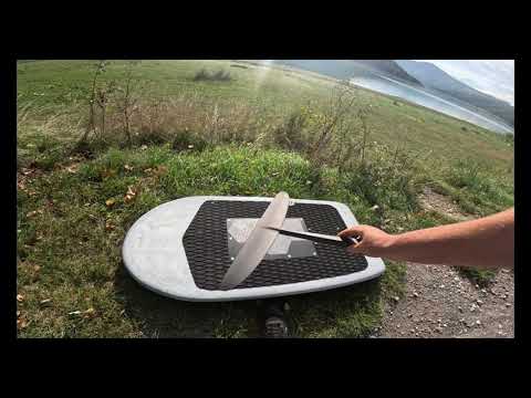

I just finished my V7
In the end it weighs 16kg complete with wing battery
13AH/14AH consumption
2-hour battery life
I’ll make a post dedicated to construction with more details
