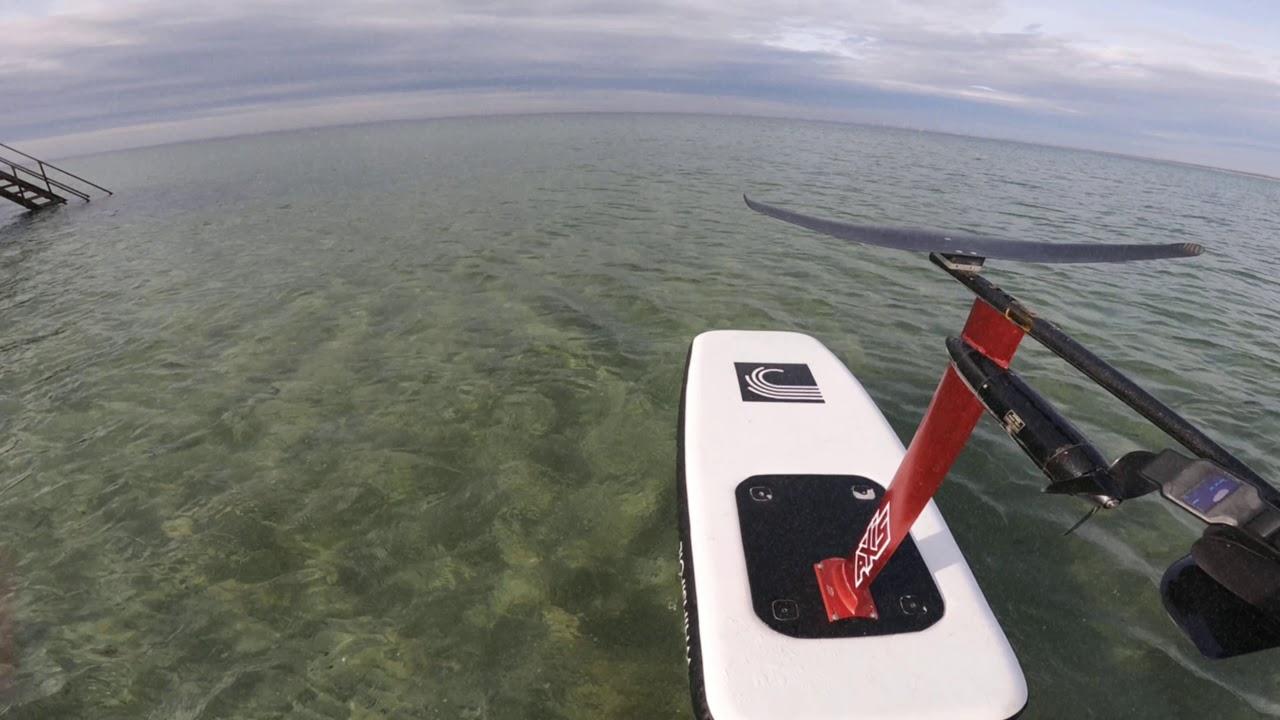

Finally got chance to test the Flite prop vs. the FR 6" prop.
Ran both props on 14s 65151 100kv and using the Flite Flyer wing for the first time.
The Flite prop is fantastic for a plastic prop and almost matches the FR in efficiency.
The “motor cone” used was a bit big at 54mm to match the FR, so there is some more gain to get here.
The pitch is high, perhaps 7-7,5" something. Easiest is to check RPM vs speed on Metr data for comparison.

Thanks for the comparison. Tomorrow I will test my Flite Propeller as well on an 100kv unit. From where did you get the inflatable?
It’s and Whimsifoil L with 200lit. Got it from Whimsifoil at 450€.

From what material did you build this adapter to match the flite wing to your RL Fuselage?
Its just a 10mm alu plate that is drilled real ugly.
Just for testing wing, will build a flite fuselage replica later
