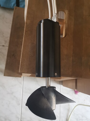

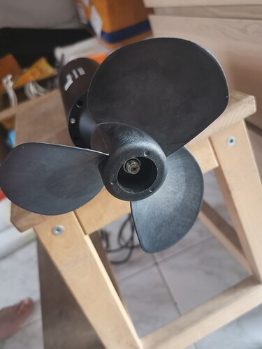

Today I took few pictures of the propeller fitted with maytech and lift/FR motors.
The prop is designed in such a way that it fits both
One thing I forgot to mention… Since it’s carbon injected plastic, it has advantage over the aluminum props: it does not gets stuck onto the shaft due to galvanic corrosion.
No need tef gel or similar…
Looks good! Interesting material, will probably be stiff as a SS propeller
. A pity also this is LH rotation… would be fun to test on small outboard( they don’t all have reverse).
I don’t fully get why LH in E foils? When power on, there is no force what so ever on the nut, and if worried about nut falling of, using a simple nylock nut will eliminate that risk totally( I would use a nylock in any case). But guess not much harm either in this application.
Simply because the rotation will tend to tight the nut. In any case with the pin and a lock nut on a threaded shaft all is tight.
Said to be better easier to regain stability when prop breaches on efoil. Would agree comparing the FR with my early 3D printed props, but could be due to other factors as well.
Why not a larger or conical hub? Will it not be tricky to run fast w/o cavitation going from 70mm FR motor to ca35mm hub in less than 40mm transition?
Otherwise it looks great and I’m up for testing.
Can you provide other data on Diam, Rake and pitch? Have not seen that around…
That make sense. The direction of vertical forces/torgue on LH vs RH is different. Probably not that big deal in a bigger hull but might be noticeable in this application.
