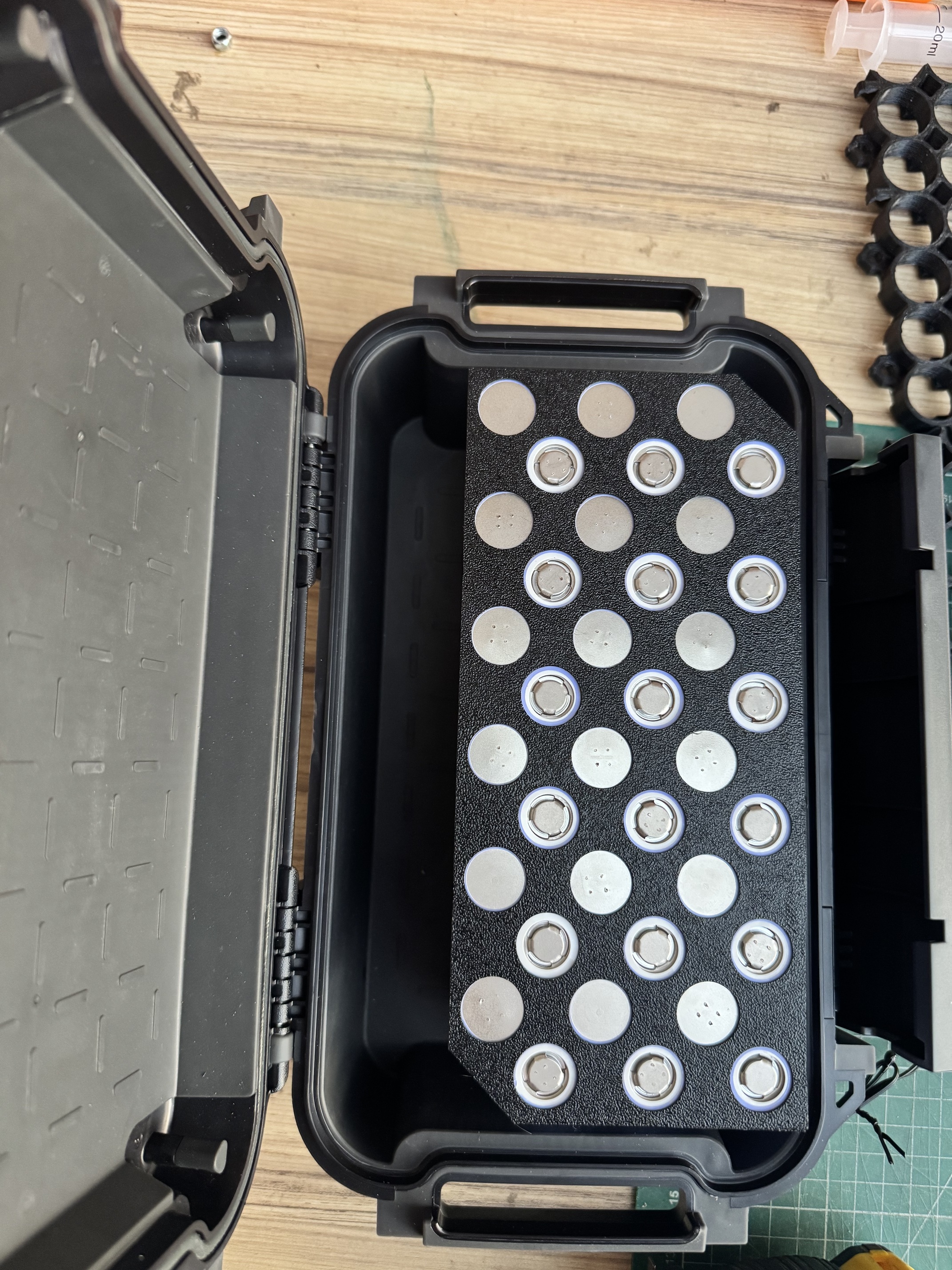

As well as being ip68 and a nice form factor I think this is going to be pretty nice fitting.

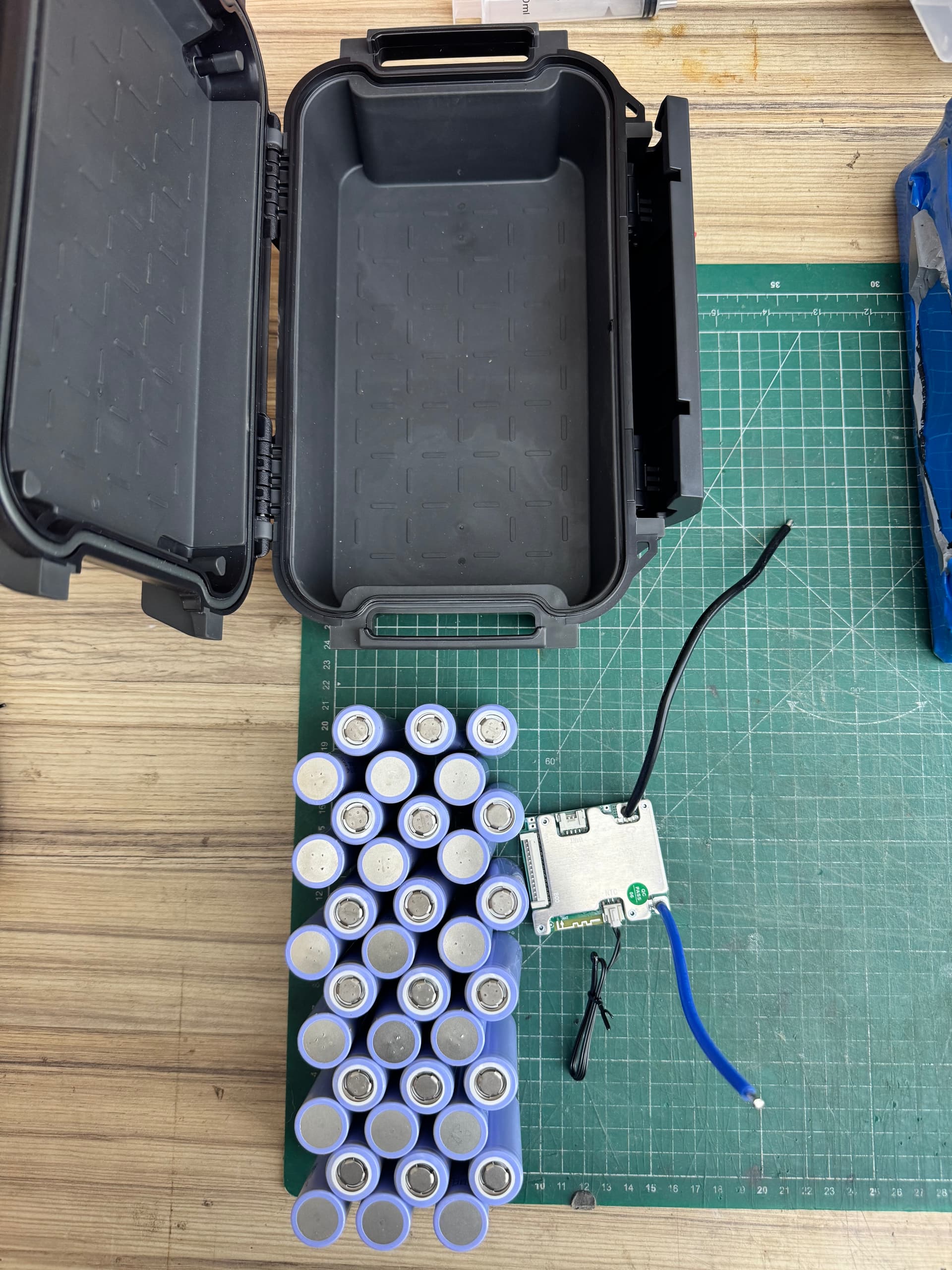

12s3p battery with Bluetooth bms, in theory leaves space for a chunky esc, cabling and transmitter.
I think I might even try and fit a 12S4P with the Sequre esc outside the case
A 12s4p does fit. (Pretty sure I have an old photo somewhere)

I was thinking a swappable 12s3p might be optimal for weight?
12s4p vs 12s3p is gonna be less than 1kg weight penalty… Lets say 1% of my body weight… won’t make much of a difference… Yet greater time on the water…

Because of the way I’m choosing to build the pack I’ve wasted quite a bit of space.
