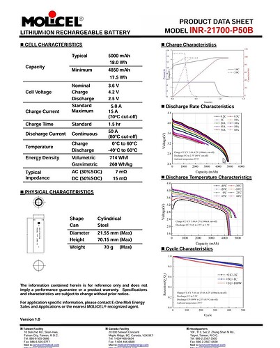

I ended up getting a Flashforge Adventurer 4 which is a bit of an older printer. Along with the regular filaments, it can print in ABS, ASA, and TPU. I investigated some 3d printing places but I think this way will work out cheaper in the long run and of course, there is a much bigger learning curve ahead of me. I think I might also have found a source for the batteries but now I see that Molicel is going to release a P50B which takes the capacity from 4000 mAh (P42A) up to 5000 mAh.
which is 25% more than the current assist. Thinking I might wait a little while to see what the price is going to be.
The Ampace JP40 seems like a good option. Highest score for high current in Mooch’s testing
Deal here:
Thanks for the news.
But the data in picture is incorrect.
Actual continuous current - 50A.
Same internal resistance as 45b.
It’s price when it will be available is twice that of 45b , which got reduced in price recently.
50b has +11% capacity, but twice the price.
The eve 40pl seems to offer the highest discharge. I don’t see moochs rating for the ampace.
Called LT22710A in the table, with a question mark if it’s the same as the ampace but in his other posts he seems to confirm they are the same.
This is the cell he recommended for the >40A discharge together with the moli 50 - but i guess molis are considerably more expensive.
Thanks for that. I had not seen a data sheet on the battery but only a popup on the Molicel website and that graphic came from a hashtag off their LinkedIn profile.
Twice the price is a little bit steep for me.
Same was for p45b.
P45b came out 2 years ago.
'The new hotness from Molicel, the P45B, has arrived for testing - Battery Builds - esk8.news: DIY Electric Skateboard Forums
Half year ago it’s price was still x2 of p42a, now it is %30-%50 more.
So the prediction is by the time the 50B’s price becomes justifiably viable, Molicel will be bringing out a better model making me question my decision further. Thanks for the info, I’ll keep going down the P45B path then.

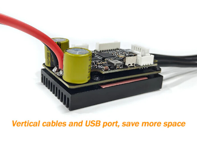

I am going to change over to a Maytech foil boost VESC 100A V6. The heat sync is connected to the board via 4 screws. Was thinking of attaching the heat sync to the outside of the box with some 5220, prior to glueing, making some holes for the screws and where the board transfers the heat and reattaching the board. Is that the standard way people are doing it? I have seen where someone made a frame inside the box for mounting the VESC, but is that overkill? If the heat sync gets ripped off, that does mean the end of all the components inside the box, but I think that is going to be hard with 5220 and four screws. Comments very welcome.
