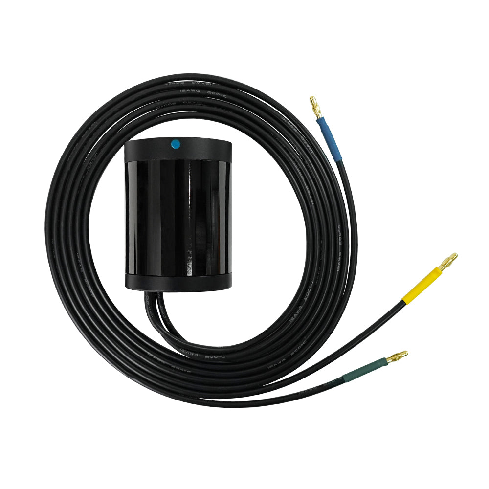

  2. The 6384 flipsky motor is something I should avoid? I see post of people changing bearings… is it too make waterproof? it’s not waterproof by design? I’still pretty confused about the hardware…
  3. The foldable propellers that come with in this variant:
    Flipsky Waterproof Brushless DC 6384 Motor 140KV 4400W for Surfing Boa – FLIPSKY
    are they something reliable? or shoud I go for a different version?

  3. Others told me that FS foldable propeller is not good. The one from foildrive is recommended. I will try one made by a member in this forums (@Jordi).
Thanks so much, I’m now browsing the other posts and look for a simple backpack project I can follow… just a question about the propellers, it seems not possible to buy just the propeller on the foil drive website… where is it available? does it fit with all the motora out there? or do I need an adaptor from Flipsky??
Thanks again for the help!!
In europe you can buy just the prop from foil drive, not sure how it is in the other continents. But then you might need an adapter, this can easily be 3d printed.
Foildrive prop fits the 6384 bduav ali motor as well as the more powerful saite 6384, without adapter.

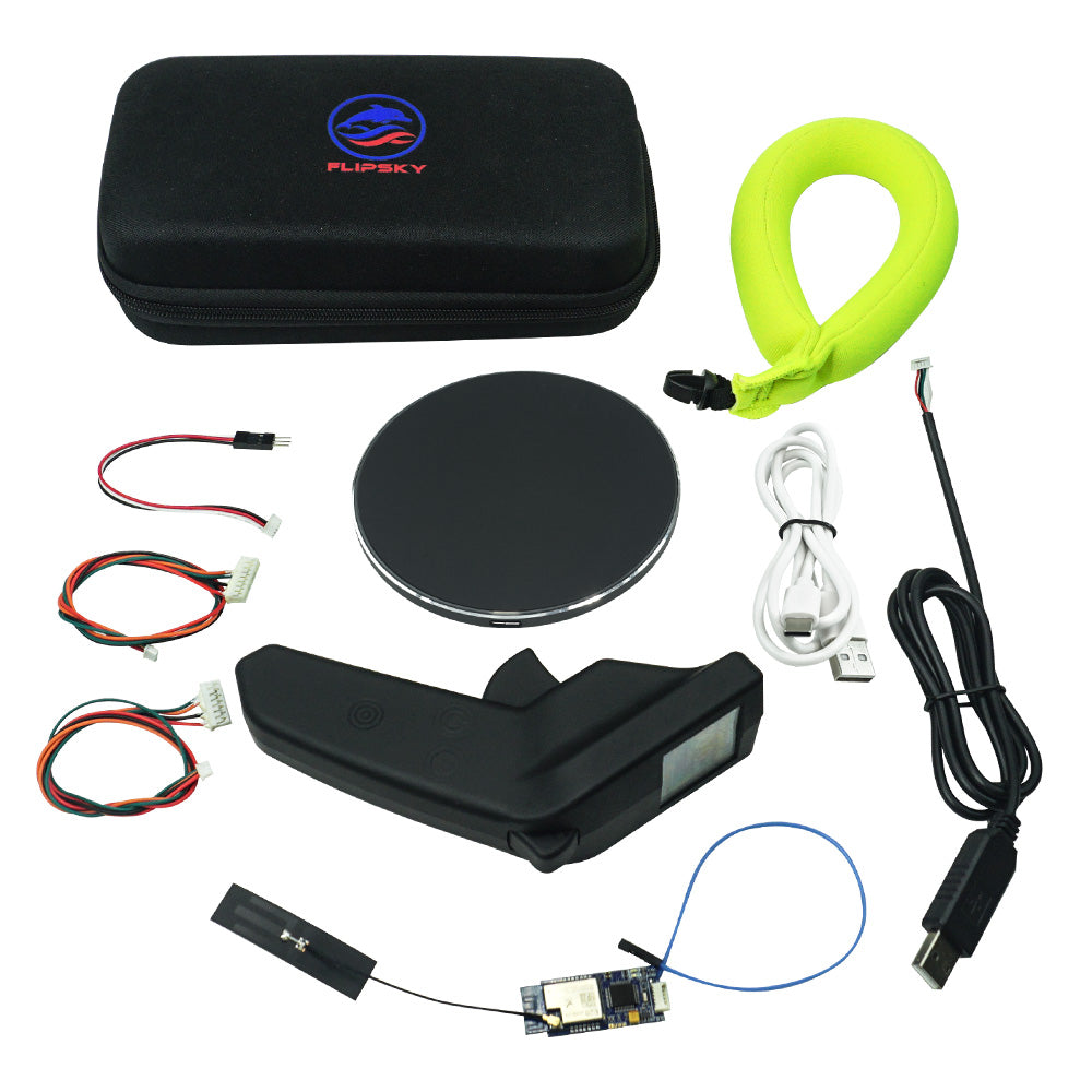

The Flipsky handset VX3 is a total disaster, they ALL fail eventually. We have had more than 10, probably closer to 20 and even with additional waterproofing they are all dead. The Maytech is not perfect but far superior to the VX3
Perhaps in your use case that’s true but I’ve had several without a problem at all. In my use case (full efoil) immersion is brief and rare.
I and others have switched to Flipsky VX5 and as far as I know no one has reported any problems at all with them.
Ok granted, but still stand by the fact that they are not fit for purpose.
In the end I swicthed to the VX5 as it seems it hasn’t many problem so far.

Flipsky VX5 controller

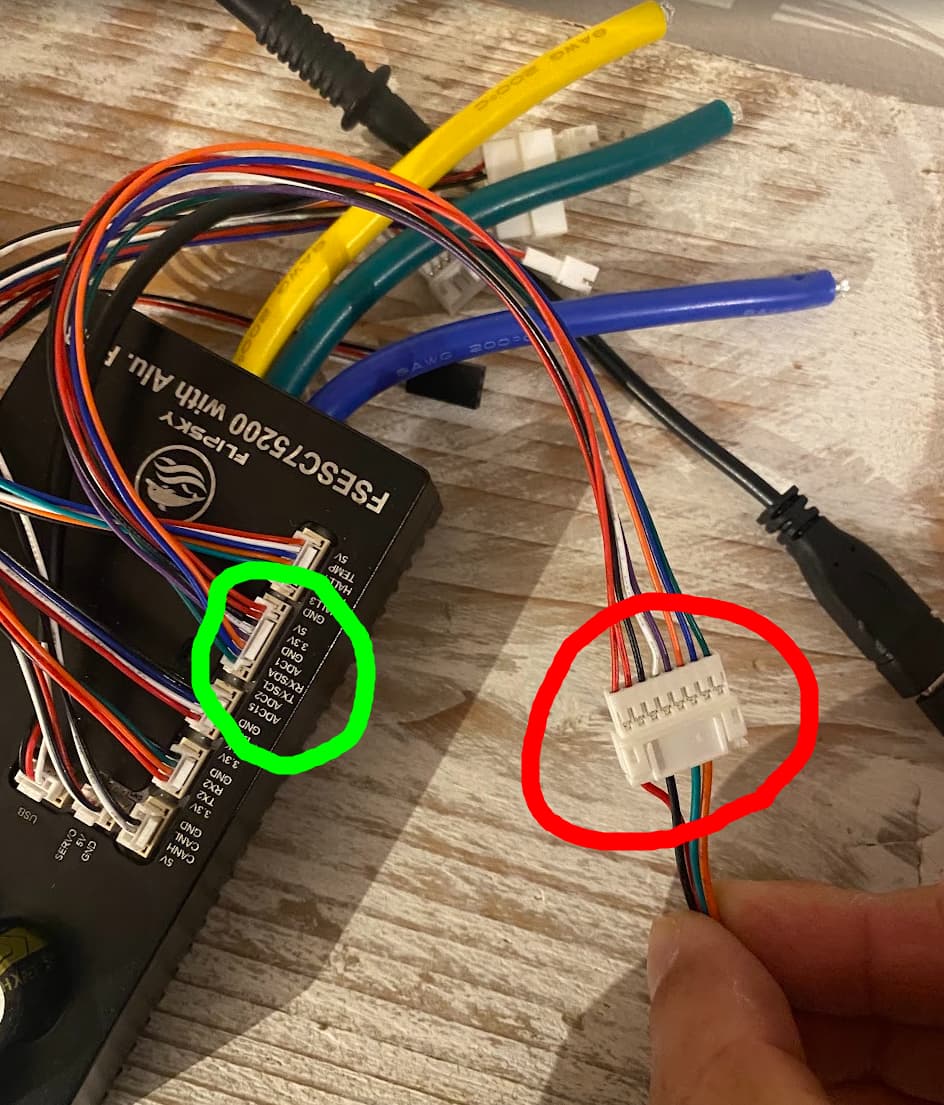

QUESTION: I’m struggling to pair the remote with the VESC,
did you go with UART connection?
Receiver is powered, remote says it’s paired with the receiver, but I’m NOT able to accelerate the motor or get any informations, I only receive a ESC LOW VOLTAGE warning on the remote
I’m able to make the motor spin via the VESC TOOL (Motor FOC tests) so I think I’m missing something on connection/configuration…
Any idea?

As far as the remote… I had the esc low voltage warning on the remote as well when I was in PPM mode and it drove me nuts for at least a week. I believe that means the remote is not getting info from the battery. That’s what that blue pigtail is for - to attach to the battery to get the readout. But once I switched to UART mode (that the video doesn’t really explain so well, so I’m not surprised you fell into the same trap) the warning disappeared and I could get all readings on my remote. As far as not being able to get the prop to spin with the remote, did you go right for the gears settings instead of the L, M, H? If so, it won’t spin on gear 1 for me. I had the same frustration and finally found a video that fixed the issue. You need to start in gear 3 or higher to have it spin. It may even be a different number for you. I wonder if this is a safety thing so the prop won’t spin if you inadvertently hit the trigger

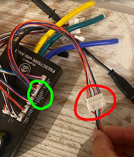

For anyone else struggling with the VX5 FSESC75200 UART connection this post from @janefoil helped me a lot:
In the end there are 2 simple things to be done:
  1. in the VESC TOOL choose “UART” (only) as input option.
    I was going with “PPM and UART” but then I read better and it’s expecting controls data over PPM and UART is used to give back info to the remote controller.
  2. Use the “PERFETCT MATCHING CABLE”. I was using the cable (coming with the remote box) which has one pin less from the one coming from the ESC. I thought the wires were matching correctly by aligning the ground and the v5 pin, but it is not. (picture in the post above)
    Using another cable (coming with the VESC box) which fits perfectly by the number of pins solved my issue right away. I had the hint from the Janefoil post linked above. Here is the picture:
I hope this can help people experiencing the same problems and also reading the “ESC LOW VOLTAGE” warning on the remote.
Cheers and flight everybody!

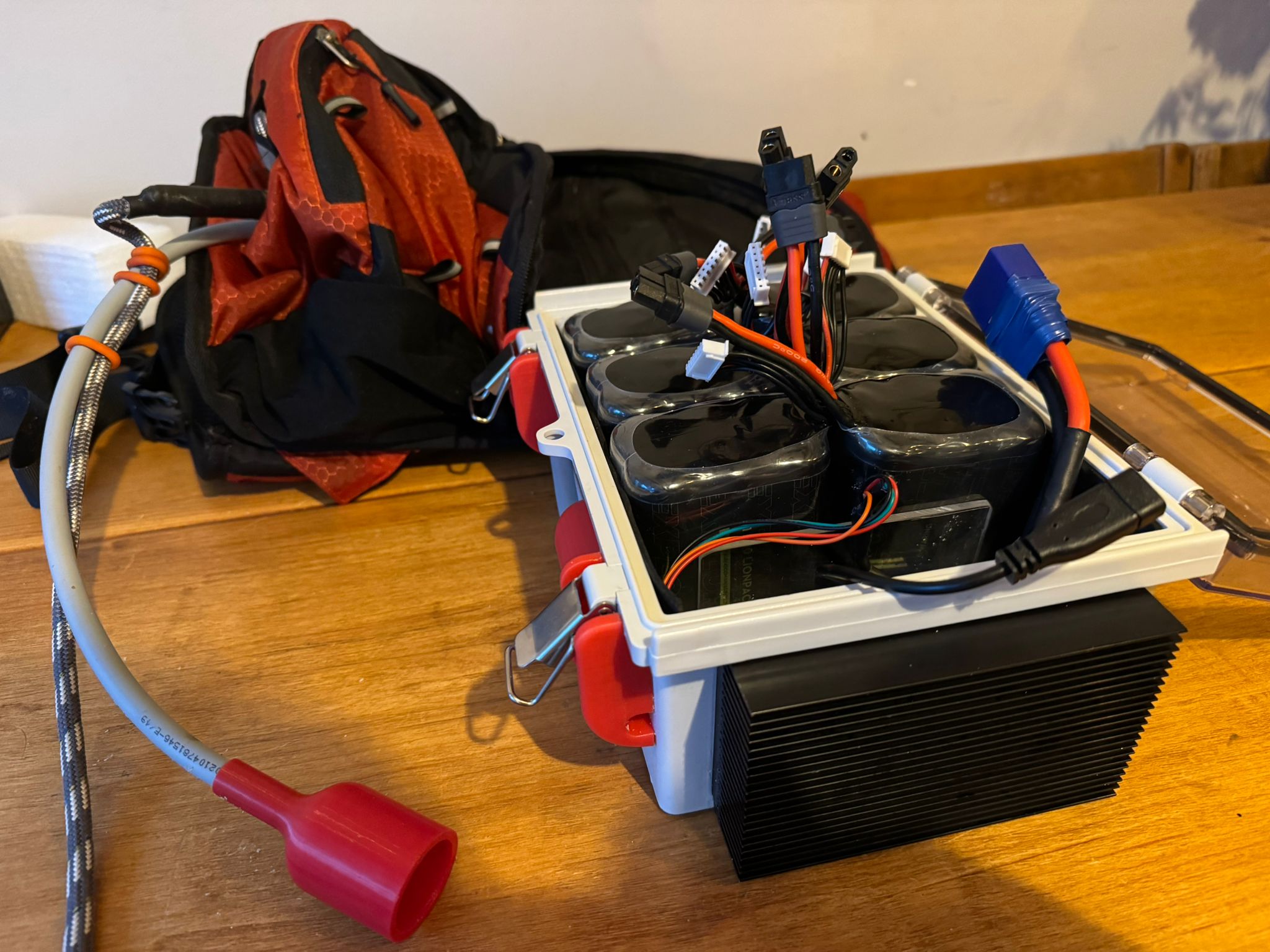

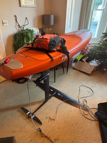

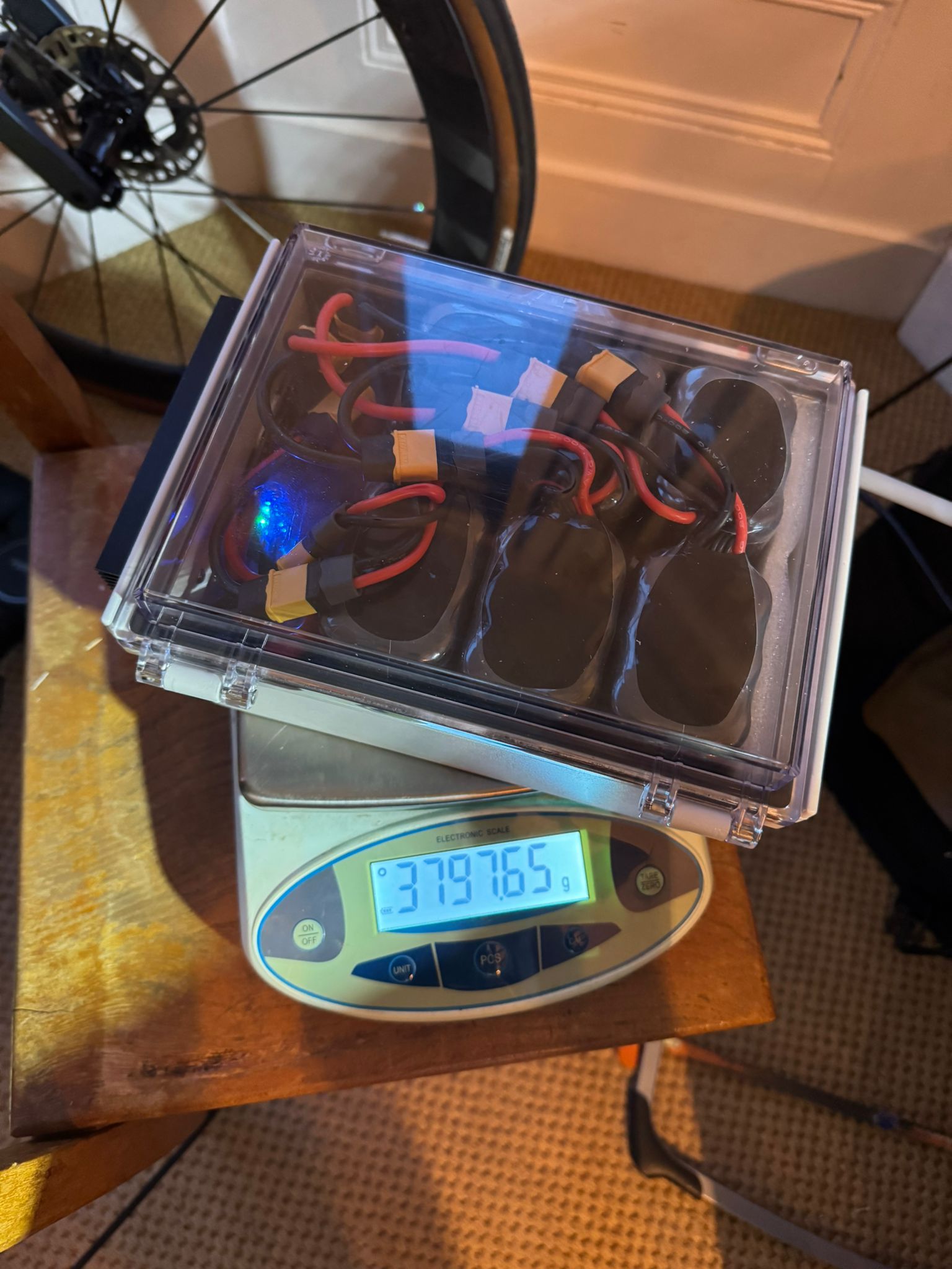

I’ve been developing a backpack assist unit over the past few months using mainly Flipsky components.
The system runs on 6S battery packs, which means you can take up to 20 batteries on a flight without issues.
The backpack works extremely well and is a relatively straightforward build. Once you’re on the board, you hardly notice the 3.7 kg weight at all. I’ve also had zero connection problems, as the receiver is positioned on your back.
Amazing! That’s exactly what I wanted to build…

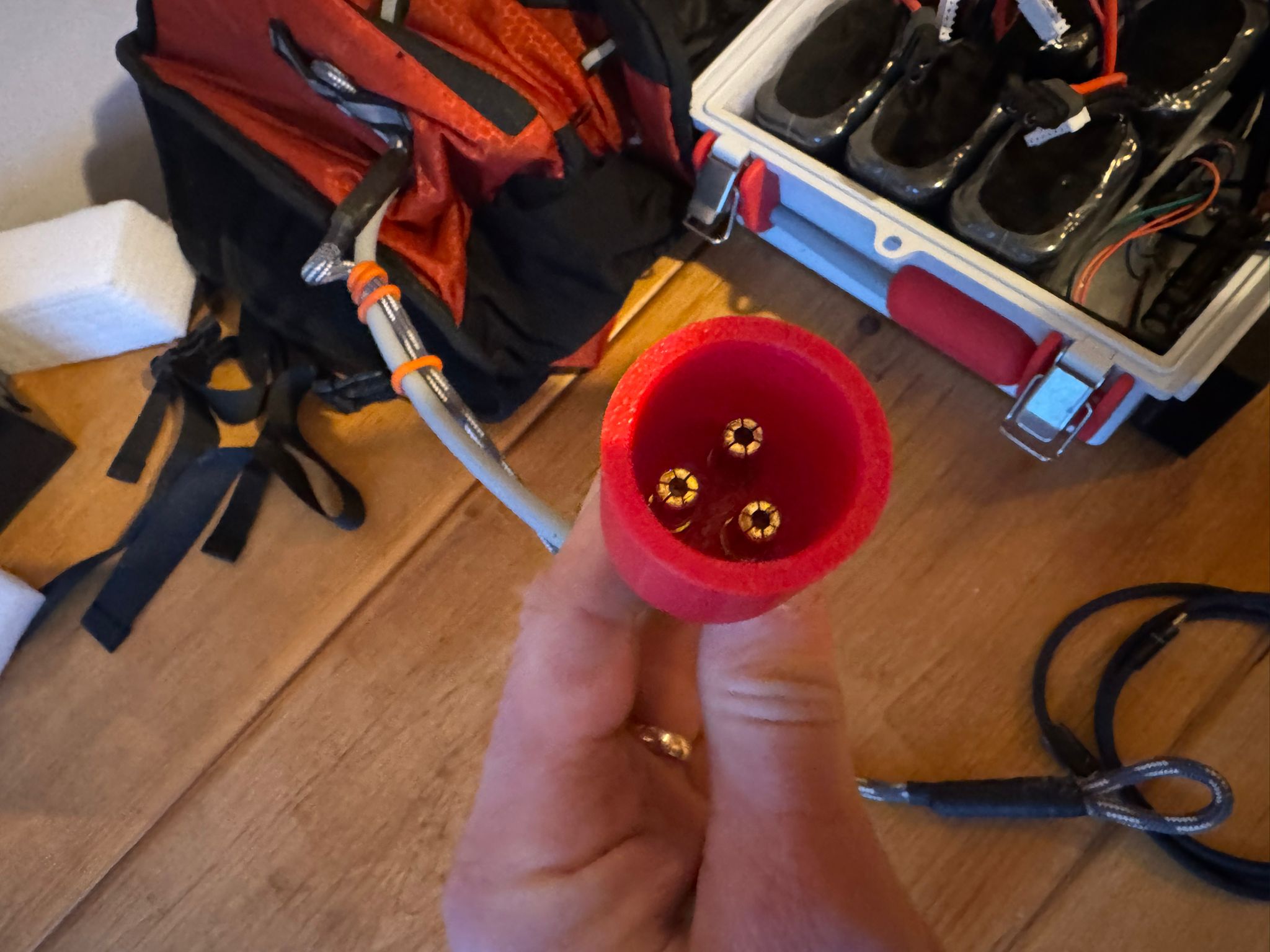

Can I ask you about the cable with the triple wires and the connector? is it self made?
Kudos for your build!
