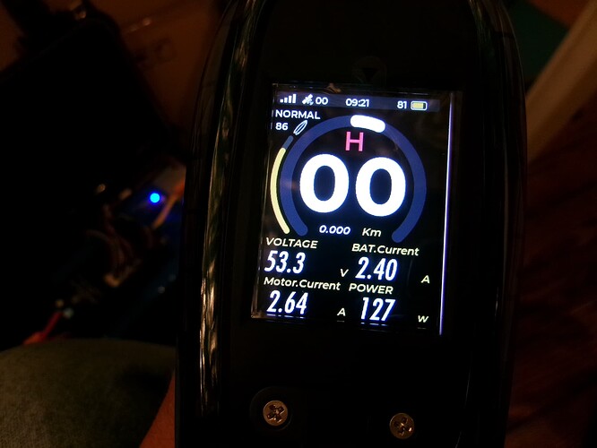

yeeeee works properly atlast but was not the most easy job pfff
lots of try and errors, almost given up…
so previous info was wrong, i used the wrong cable
need to use cable thats fit exact ( esc port 6 + reciever) no free pins

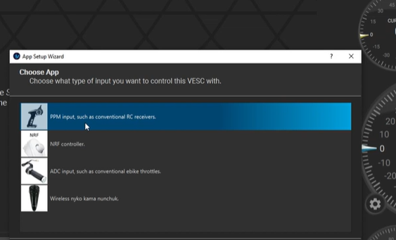

at vesctool (setup input) use the “wireles niku kama nunchuk” remote
remote choise vesc tool
and then al go’s well (ludwig bre needs to make a new version of the setting on you tube :wink:)
o boy so happy :hugs::hugs::grin::grin::ok_hand::sunglasses::sunglasses: (hope in the water all go’s well to)
next step assemby, adjustemnt, 3d printing for cone …
step by step
