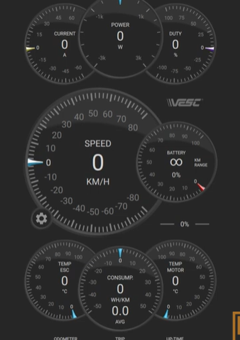

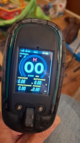

I can not see any battery info on the remote. Also on the vesc tool I can not see any battery info
(remote: voltage ,bat current ,motor current, power // vesc tool: battery, current, power)

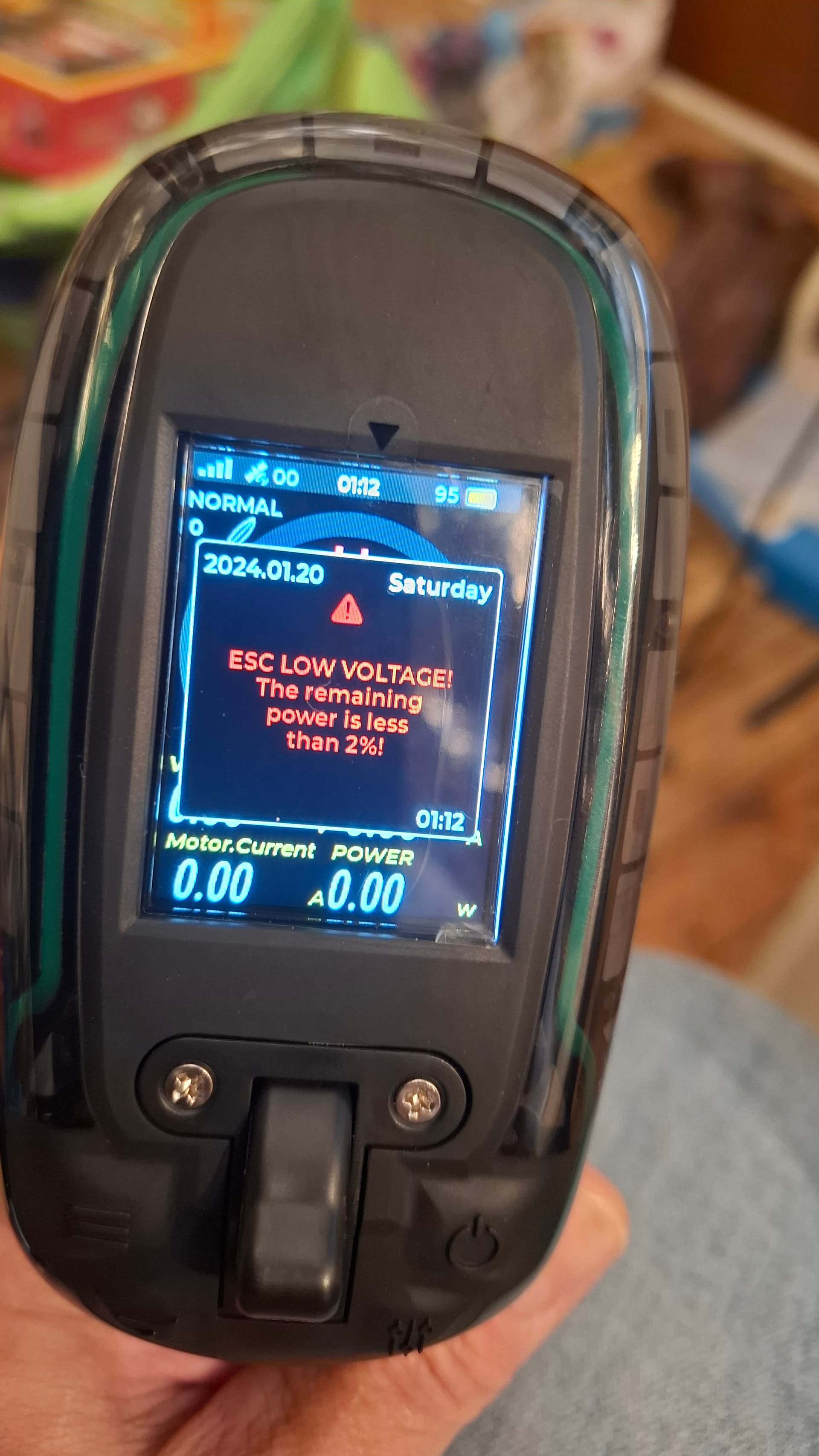

Then I was not able to give any throttle because I get warning on the remote “low battery les then 2%” although battery was fully charged (battery 13s 48v , measured 54V)
I disables on the remote the warning : board setup/low battery warn “off” then I was able to use the throttle. I guess throttle automatic turns off when warning “low battery” is on?

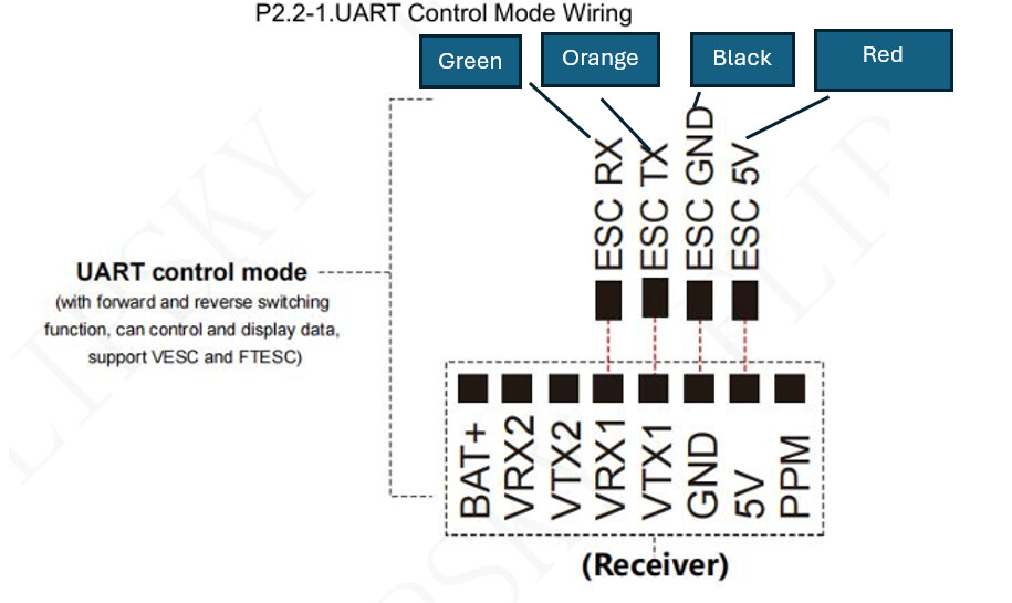

I believe your issues stem from how you set this up. UART supports the telemetry you want
You need to use UART as opposed to ppm Lots of posts here on how to do that but basically use a different cable that came with the VESC to connect the receiver to the UART port on the VESC
You also need to make changes in the vx5 “remote setup” . If you don’t have the detailed manual you can download it from the link I made in the VX5 topic
Indeed, use UART instead of PPM and your problems will be solved.

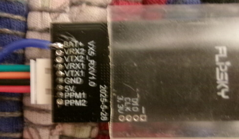

Did you connect the VBAT wire from the remote receiver to the battery positive terminal?
If not, that will cause the “low battery” warning and no battery level showing on the remote or in the app when using PPM mode.
As others mentioned, you can also use UART mode, which doesn’t require the battery wire.

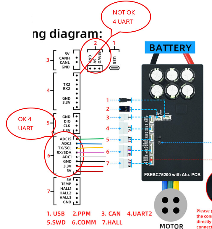

i saw topic Help with Flipsky 65161 75200 and VX3
but stil strugglin with the wiring. (75200/65161/VX5)
i used port #2 /servo,5v,GND/ for connecting the reciever VX5 (flipsky info :wink: )so this is only ppm , wil not use it any longer (no battery info)
(weekend)
today found the right wire settings ,i guess i am on the right track now🤗

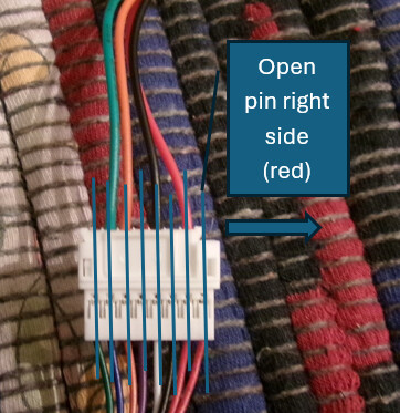

port 2 only PPM , port 4 ok for uart

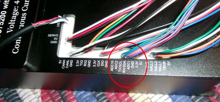

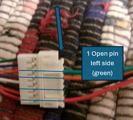

Possible to plug kabel in on the right or left sitde (it leaves 1 pin open)
open pin right = 3V so not ok
Schermafbeelding 2025-11-12 211001
open pin left site = ok for VX5 reciever and uart
Schermafbeelding 2025-11-12 211014
color code reciever
reciever plug
Schermafbeelding 2025-11-12 211118
not just plug and play :grin:pff but happy i got you all out there
