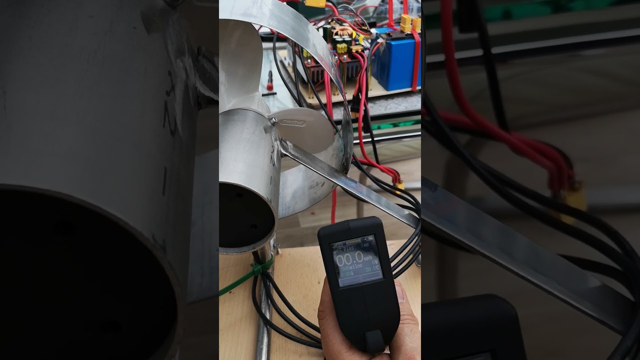

3D printed case for the remote is finished and I start implementing the single hardware components. Remote software part is also “done” as it works in my bathtube xD BTW your propeller also did not break yet, so thanks again for the stl.
So far the motor seems strong (I only tested up to 20A as water flow was too massive in bathroom)
In VESC Tool it recognized the motor with around 41A max, is that the same values you got from scanning?

Hello,
could you please give me some help.
Unfortunately, the motor does not turn, it is controlled but does not run see video. The connection of the remote control worked very well.
Have the following structure:
  • BLDC 65111
  • ESC 75100
  • Remote VX3 controller
  • battery 36V 10Ah 10S3P
What can be the reason for the motor not turning, just trembles?
The 3 phases have current and the motor cans turns easily by hand and is free.
I would love to hear from you and get help
