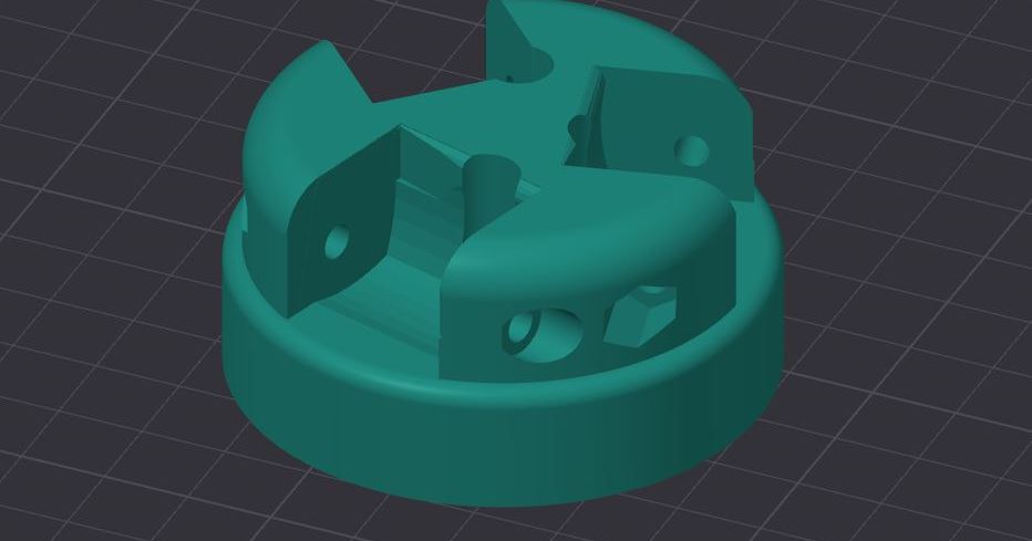

Did you finish 3 blade FD hub design?
Just realized i made it for m4 and the orignal foil drive blade uses a different screw size
Nice! Thanks for sharing.
Drilling the prop bolt holes to m4 just makes it better.
