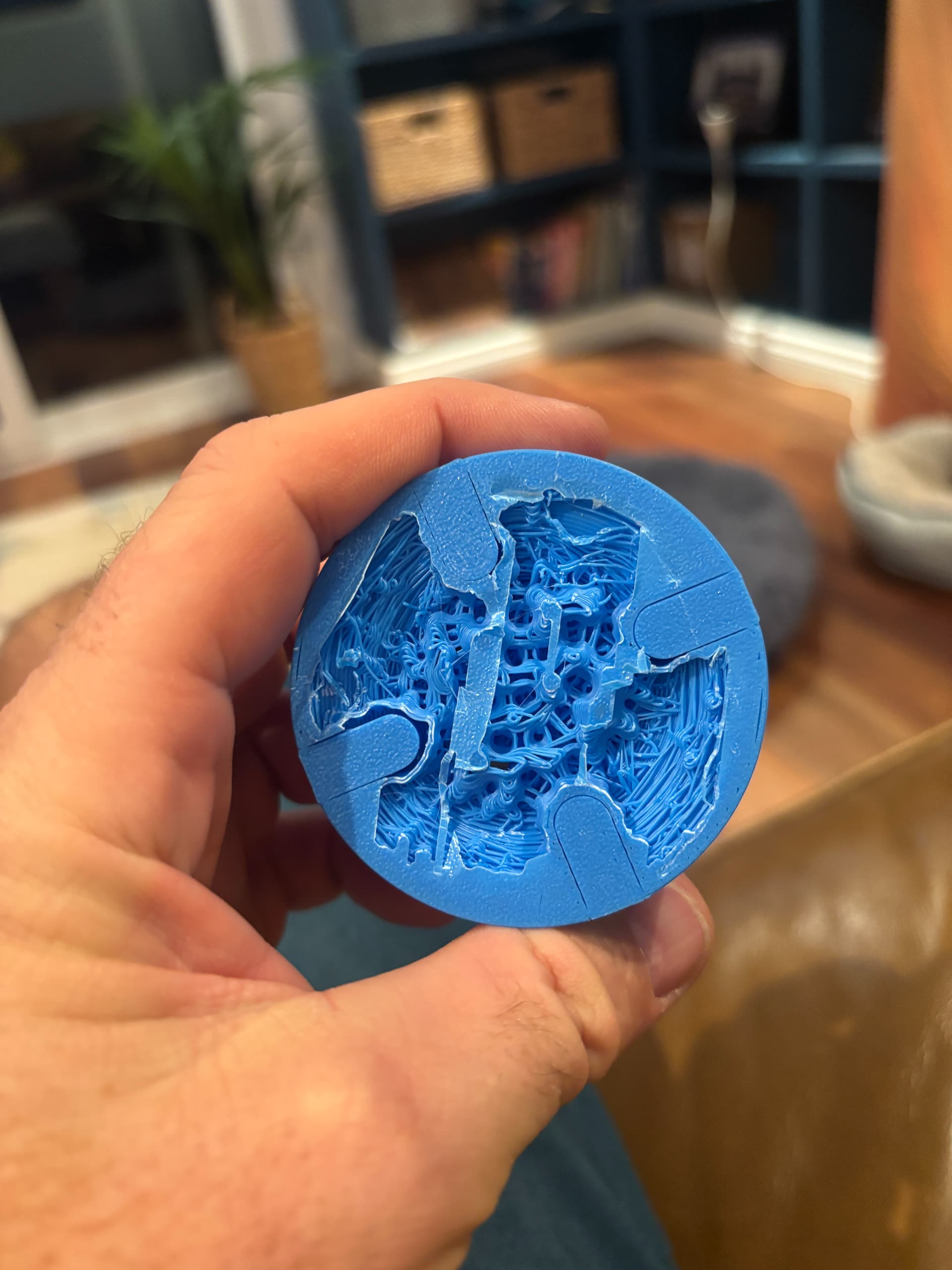

Thanks Joka. I’m having issue with the underside printing due to the support needed. Any tips? great design and thanks for the share, just what i’m looking for. Still new to the 3d print game :slight_smile:

Try printing the part up on its edge, orienting to reduce the overhangs. I found the same thing with the big dished infill - always a pain to clean out.
