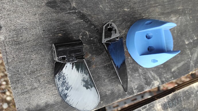

Anyone here have some hot tips on printing the folding props?
- Materials
- Speed
- Temp etc
Picked up a printer yesterday and these are my first ‘experimental’ prints!
Hello
I printed with front flatbase on the bed. Minimum 50m/s. No support on ender3. Pla+ is strong enough. I have printed one with ABS, that went into an acetone vapor bath. It smoothed the printed lines, and after sanding it gets very clean
Regular PLA broke, as well as PETG
